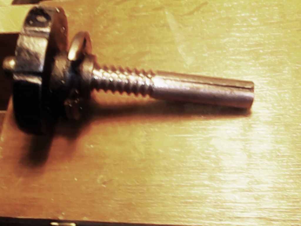

      I have little expierence with my lathe (a super adept) and while trying to fit a workpiece on without moving the tailstock I seem to have retracted the centre too far back. Once I got the workpiece in and tried to move the centre forward again it jammed. I can take it further in but going out again makes it feel like I'm tightening a bolt. I considered getting a big spanner and trying to turn by brute force but I don't want to rupture part of the lathe. I did get the centre out with molegrips but the spindle stays stuck.
      I have no idea if it is a problem just on my lathe or all adept lathes. Google didn't show anyone else having similar problems.
      Does anyone have a way to release the spindle again?

        #182379
        Capstan Speaking
          @capstanspeaking95294
          Is it the screw or the quill that goes tight?
          A misaligned or damaged clamp cam or tenon ?
          Can you remove the handle and slide the quill out?
          #182400
          Rainbows
            @rainbows
            Managed to dissect the tailstock. The handle had ridden to the end of the screw on the spindle and tightened up.
            Put the spindle in soft jawed vice and twisted the handle free with molegrips so its all good.
            Now I just have to get the crossslide screw back in its socket after accidently over extending it. Hasn't been a good day for the lathe.

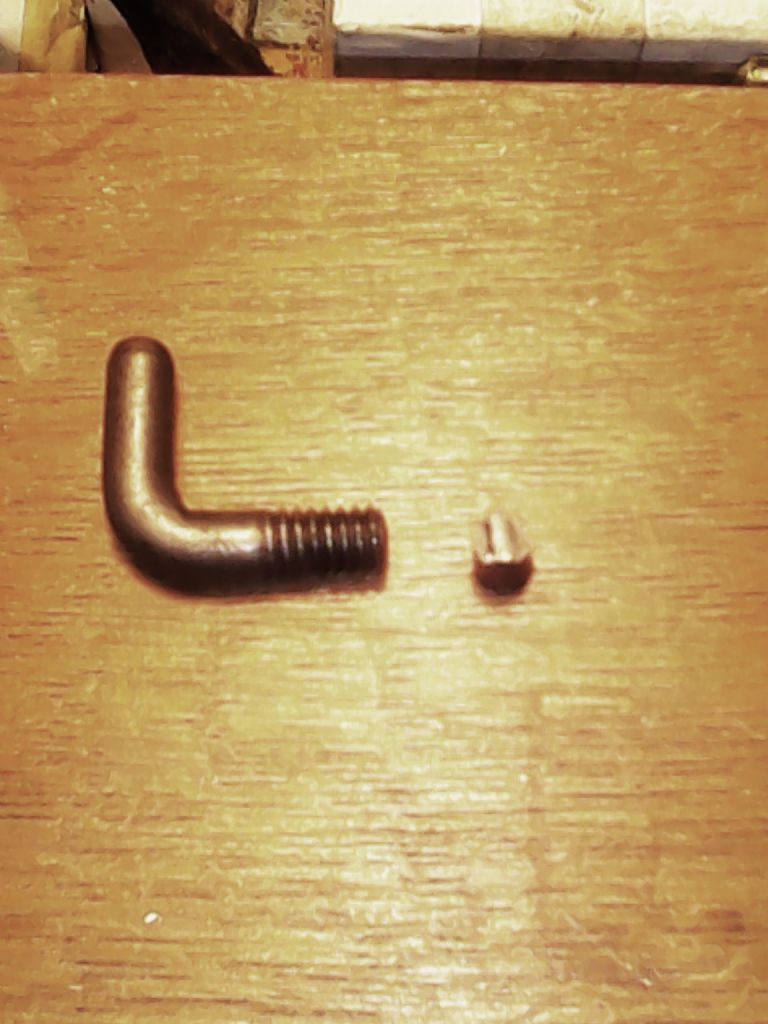

                                I was impreciseover the 0MT. You are right in thinking that it is smaller on the adept.I made mine from a bought adapter from RDG and turned it down at the big end to a matching taper to 0MT. I did it on my Zyto which has an offset feature on the tailstock to facilitate a bit of taper turning. The bits are in the picture below with the offcut of the original adapter.
                                I have stripped down the tailstock to look at the "tenon". Remove the clamp screw and you can see the end of a slug but it can only be accessed by withdrawing the quill assembly from the back end and then pushing the slug into the bore and retreiving it through there.
                                it should have a tang on the end face that engages with the quill keyway as a good slide fit. The screwdriver slot at the other end is important to realign the slug when reassembling.
                                My quill has some minimal damage to the end of the keyway but I don't see it impeding operation so I'll leave it for another 70 years
                                Bob D
