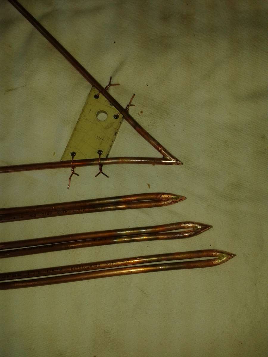

            Superheater

                If you don’t want to be bothered with superheaters just coil the steam feed pipe from the regulator around the smoke box interior and then connect it to the cylinders, the heat in the smoke box will give a degree of steam drying.
                I have seen some good performing locomotives without superheaters.

                    Seems a shame to build a detailed and accurate loco like this and leave out the superheaters, even a copper non radiant would be better than nothing.  I belonged to a club that had a Springbok as a club loco, which was fitted with radiant superheaters reaching halfway along the firebox, it was not a spectacular performer but was a good passenger hauler, unusually fitted with slide valve cylinders. One day the superheater elements failed, and as the engine was needed for the following Sunday a couple of us set to and by passed the superheater connecting the regulator direct to the cylinders. This was the only change made to the engine. The following public running the loco did run and pull passengers as required, but was noticeably less lively and was horrendously “wet” with condensed water appearing at the chimney and just about everywhere else. Two weeks later with new superheaters installed it was back to it’s old self, everyone who drove it in both states was surprised at the difference in how lively the engine felt with the superheaters restored, and the general feeling was that less coal was consumed and that firing was easier. This is all entirely unscientific of course, but as a practical demonstration that superheating does make a difference to the performance of a loco, I remain convinced that Duncan in his post above is entirely correct. With the great amount of time and effort that goes into constructing a loco, the cost and extra work of making superheaters would seem to be worthwhile. I wish you happy steaming whatever course you decide on.

                            Charles makes a valid point in his post above, one thing I left out of my post about the Springbok was that we replaced the old superheater elements into their tubes simply to keep the gas flow through the superheater flues as it was before. We figured in our unscientific way that if left out the large dia flues for the s/heater they would act as a kind of bypass affecting the flow through the smaller flue tubes.

                              Hello Folks,  I was wandering through Llangollen yard one day and saw the tubeplate out of 80072 one day and it had three rows ofsuperheater flues so the set me thinking, why do we only put one row of superheaters in our 5″ gauge boilers.  I thought the that I should try two rows in my boiler as I had received a surprise package from the long lamented “Whistons” one day and included in it were 10m of 5/32 x 24swg stainless tube so my Y4 needed new superheaters. so I tried that and they are still in there after 12 years of hard work.  I fitted my double row of elements in my 4MT boiler (in 80080) but the engine became too heavy to me to lift.  One day two chaps came from Co Durham to our railway and in conversation Eddie said to me had I finished my 4MT.  I said yes, so they said would I mind if they took it away with them to have a look at so of course I would love them too.  After a few weeks they emailed me and said that they were going to Gilling to give it a try and they took it and hooked on to ten of our MK1 coaches (weight 28 kg each).  Joe took it round for 2 hrs (average speed about 7 mph) and then Eddie took it for another 2 hours and when they compared notes they both said that they only had to top the boiler up a little evrey 6 laps. (Every 1.6 miles) Gilling is 440 yds round and is all laid with transition curves and superelevation for 7mph running.  I also met David Hudson at a Midlands Exhibition one day and I looked at his loco on the stand and I asked him “What are those three little pipes for”  He said they are for my Atomisers so I asked him what does it have inside his reply was “Nothing”.  I thought, I can copy that.  We then went on to the track at Morely (Derby MES) and when we were dropping our fires that was a gent from Sheffield waggling something around in his cab.  I asked him what he was doing and he said the he was cleaning his fire grate.  I said to him that he must have a rocking fire grate and he said “Yes and it has been in there for 10 years and I have never looked at it since”.  Now all the BR Std engines have atomisers and rocking fire grates so I have used them on all the locos I have designed apart from the GWR 5700/8750 Classes.  I have also designed a fine scale GWR Pannier but it just needs someone to build one which has the steam chest between the cylinders as per the works drawings.  Since then I have re-drawn the Britannia, the B1, the BR Std Class 4 4-6-0 and my own 80080, and now I am on with the BR 4MT 2-6-0 and done to the works drawings.  I am dying to get on with the BR Std Class 2 2-6-0 as it is a terrible mess.  The tender is pure Ivatt.  It is such a pity as it is a very popular engine.  Anyway I don’t think Gary need worry about superheaters as the engine will not be going anywere apart from if he eventually sells his engine the buyer will no doubt be very dissappointed.
