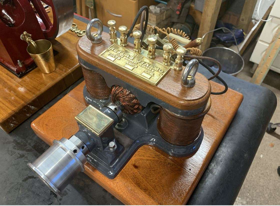

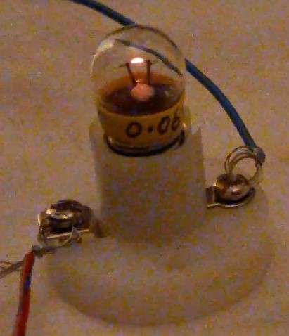

      I’ve only just twigged there is a page 2, didn’t realise the thread still running!
      Dave the bulb is 6v / 60mA, so 360mW. I didn’t build this for power but because it looked interesting to construct (it has been!) and looks authentic as part of steam plant model, I just intend to power a few LED Victorian style streetlights.
      Malcom your diagram of the configuration is correct, I have today bought a couple of Neodymium 10mm dia. rod magnets to connect end to end rather than cubes  – if anyone else goes down this path don’t buy a rectangular magnet as they are magnetised through the depth rather than end to end.
      Thank to all for making this such an interesting thread – I nearly didn’t post it but am now very glad I did!

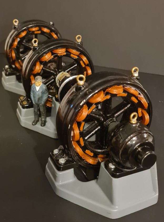

                            On JasonB Said:
                            cringle
                            Nice model.  I hope the figure is a tribute to Fred Dibnah.  Anyone know?
                            dibnah

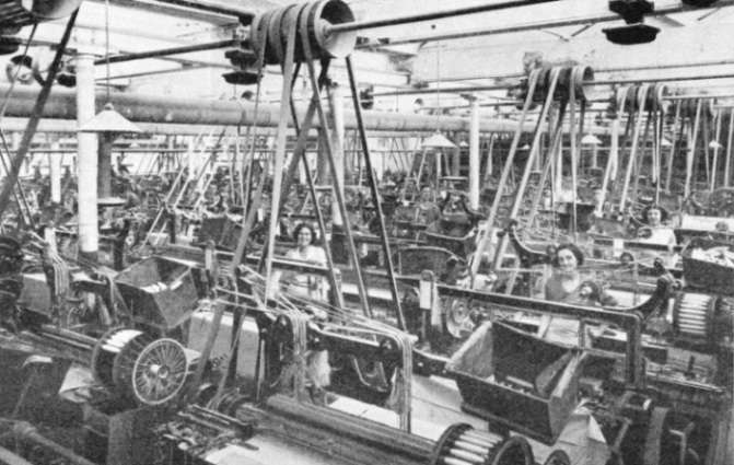

                            On the subject of early generators, the first power stations where a public nuisance.  Had to be located close to their customers and driven at high-speed by reciprocating steam engines.  Unfortunately ordinary engines caused a severe thumping vibration bad enough to rattle shelved crockery a few hundred yards away.   As early electricity was only sold in rich areas, this led to neighbours taking well-funded legal action against the supplier.  And they set up a parliamentary lobby that got the law changed.
                            In the long run the answer was turbines and AC technology allowing power stations to be moved out of town.     But there was an interesting phase before turbines when generators were driven by steam engines specially designed for high RPM, high-efficiency and reduced vibration.    Extra tall steeple engines like the Willans:

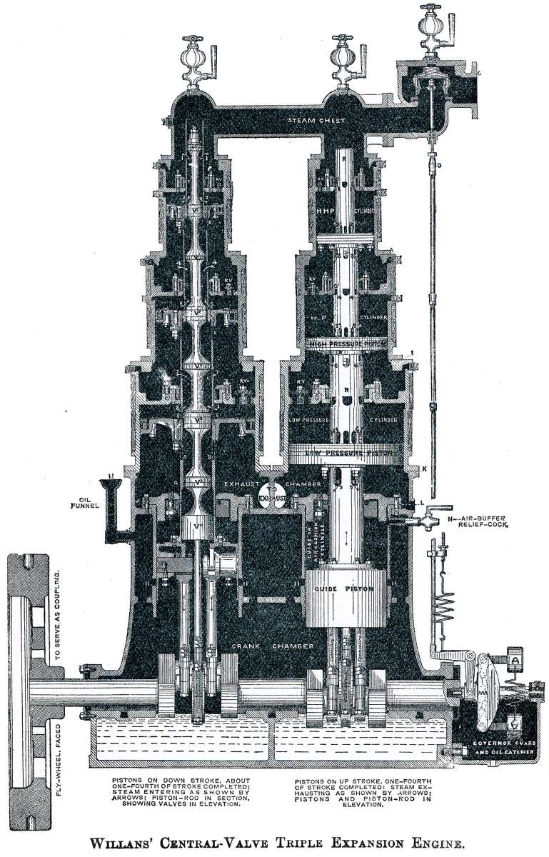

                            Willans_central-valve_steam_engine
                            Steeple engines have a long general-purpose and marine heritage. I’ve seen several model steeples exhibited, but I don’t think any of them were specifically of the high rpm for electricity type.  Has it been done?
                            Many model engines are stand-alone, which is great, but I add extra brownie points if the model shows them driving something.   Mill engine powering a model loom,  winding engine lifting a cage in a model colliery, marine engine turning a propeller,  traction engines spinning illuminated fairground rides etc.   I guess the main reason it’s rarely done is space – a mill engine would be tucked away in the corner of a model cotton mill, itself a large factory packed full of other machines:

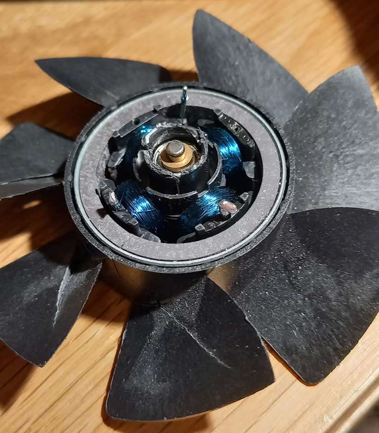

                                              Been busy with the day job so late reply. Strangely enough I’ve just spent 3 days here:
                                              https://www.nottingham.ac.uk/research/groups/pemc/home.aspx
                                              Can’t go into details but BLDC motors were discussed ;-).
                                              Before I went I did get around to taking a 75mm 5V fan of the type used in computers apart. Unsoldered the drive PCB and soldered on 6 diodes as a full wave bridge. Off-load it gave about 5V when flicked by hand. So I connected a 6V 60mA MES bulb (0.36W). Flicking the fan caused that to light up.
                                              Fan-1
                                              bulb 1
                                              Probably not the bulb for the motor but it was handy.
                                              The observent amongst you will have noticed that the stator of this particular motor has four poles. So it isn’t the expected 3 phase design. It does have 3 connections. These appear to to be a common and 2 phases. So my 3 phase rectifier is not optimal. I’ll have to do some more work.  This will include AC to the bulb, 2 diode full wave rectifier and a different fan or two.. I only choose this one because it was to hand and the frame was broken. I assume it’s a 2 phase motor because it saves a power transistor…
