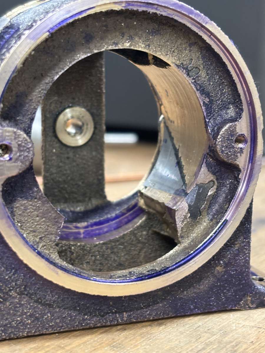

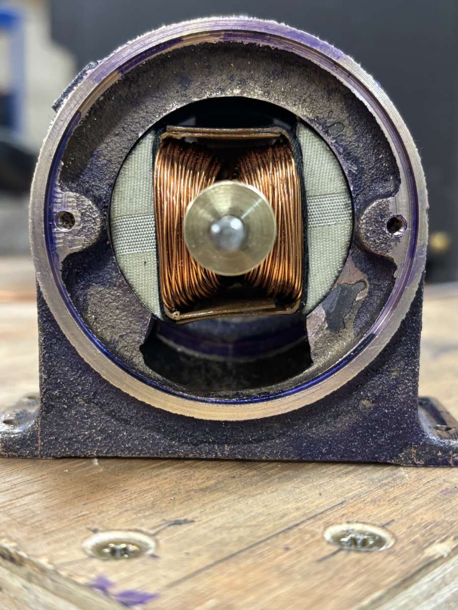

      Does anyone have experience of making the Stuart dynamo, I have just finished machining / assembly but am getting very little output (approx 100mV).
      The concentricity and air gap seem fine, the armature spins freely by hand with magnet not fitted.
      IMG_2438

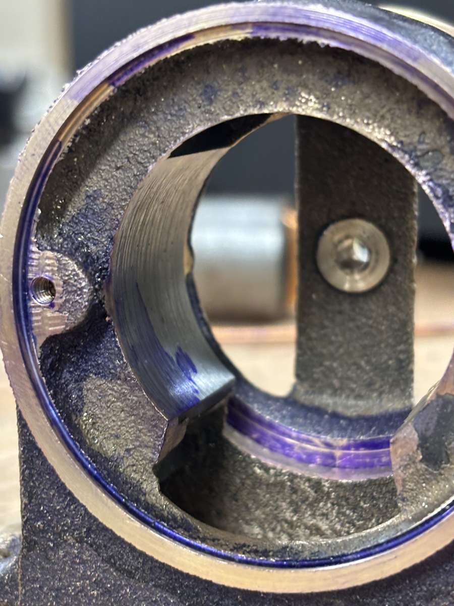

      The only issue is that the pole pieces were not quite molded in symmetrically which has resulted in a thin layer of gun metal on the right hand side when bored to the specified diameter (as required to achieve the correct air gap).
      IMG_2436
      IMG_2437
      The electrical connections are good (ish), but the magnet does seem very weak.
      Just wondering if anyone else has been here before?

            If the magnets are cast in as appears to be the case then unless magnetised after casting they will have been taken above the Currie point and have little magnetic force. Small permag motors and alternators normally have the magnets clipped or glued in to a casing. An old bike dynamo makes an excellent unit for such jobs, the type that rubs on the side of the tyre. Noel
            #757906
            Steve Rowbotham
              @steverowbotham77083

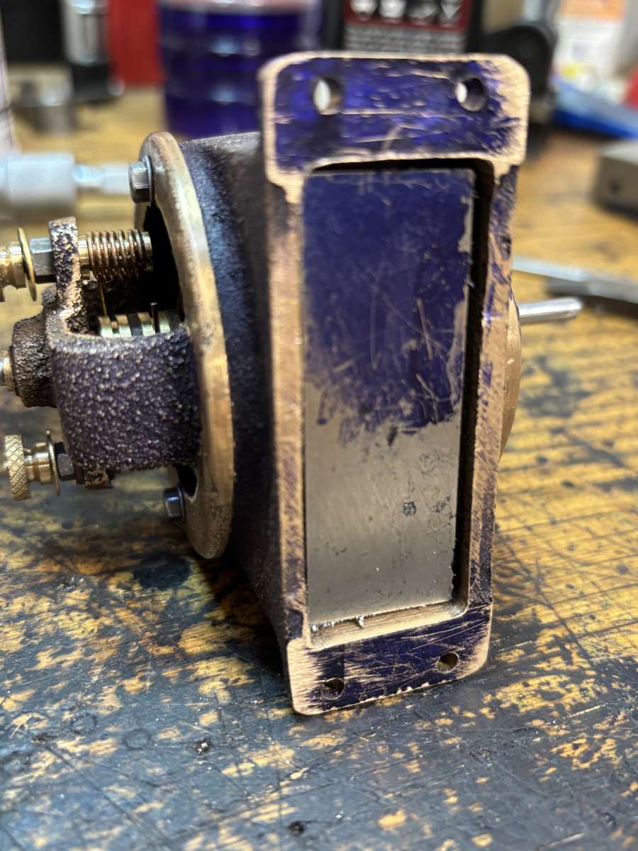

              Noel, you are correct, the separately supplied permanent magnet fits into a recess machined into the bottom of the casting where it attaches to the cast-in pole pieces
              IMG_2439
              #757918
              noel shelley
                @noelshelley55608
                AH ! Now I understand. An interesting way of doing it, all be it not I fear a very efficient way to generate electricity. It might be worth trying to find a pair of half moon ceramic magnets of the right ID x thickness and mill out the pole pieces. Araldite will hold them in. Noel.

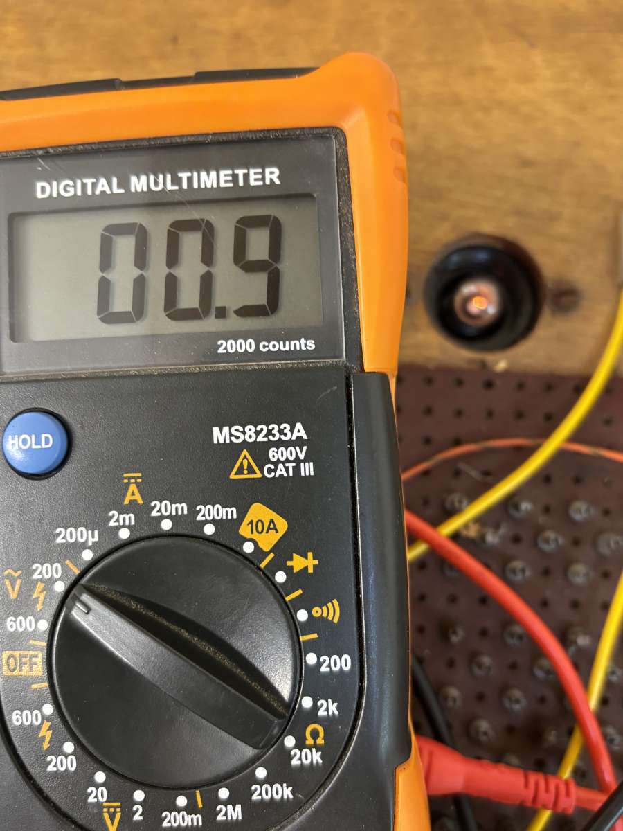

                        Make sure your meter is set to AC volts
                        The old stuart description says it will make a lamp glow when rotated by hand so you should be seeing something at your 2000rpm test speed.

                          A thin layer of non-magnetic metal over a pole piece probably won’t do much for it’s efficiency…

                              I agree with JH that the mom magnetic coating to the pole piece won’t be helping, at the very least it will increase the effective air gap in the magnetic circuit. The OP mentions that the magnet seems weak. Is it an old alnico type that has got tired? The link MG provided mentioned not removing the rotor without fitting a keeper, which you wouldn’t need with a modern magnet. Not sure how you test a magnet, but someone here will know. There was an article way back in around 2005 in ME about making a remagnetiser, but finding a modern magnet that would fit would be a lot easier. I wonder if a motor reeinder would have a remagnetiser?

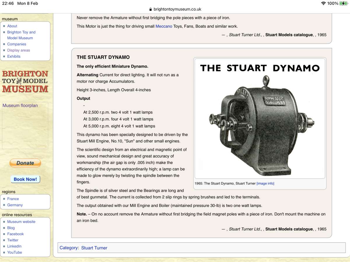

                                  Purely for convenient reference … I am re-posting the Stuart advertisement dated 1965
                                  IMG_4647
                                  IMPORTANT EDIT:
                                  Please also see here:
                                  http://www.stuartturnersteam.com/Machines/Bottone/Bottone.html
                                  This is a different one ^^^
                                  A sanity-check please: What exactly is being built ??

                                      New worry from me after reading Michael’s screen clip of the Stuart advert, which Neil Wyatt noted in #525915
                                      The Note says ‘On no account remove the Armature without first bridging the field magnet poles with a piece if iron.‘, and Neil said ‘I think it’s worth drawing attention to the warning not to disassemble the ‘device’ without bridging the magnet pole pieces first.‘
                                      This may be because the magnet is of the self-destruct variety.   Magnetic chuck instructions used to warn users not to dismantle the unit.  I believe the problem is that designing Alnico magnets for maximum pull requires the poles be positioned in a way that causes the magnet to eat itself if the flux has to jump a large gap.  These magnets are OK when fitted inside a machine that limits the gap, but the magnetic circuit has to be bridged if the magnet is removed.  How quickly the magnet eats itself depends on the pole design:  anything from rather slowly on an ordinary horseshoe magnet to almost instantly on a high-performance set-up.
                                      I believe this self-destruct behaviour is peculiar to Alnico alloys, and modern super-magnets just keep going.
                                      Steve mentions his magnet being “very weak”. Is it possible it was left for some time without a keeper before being fitted?   If so, replace it.

                                          Leaving aside switching the meter to AC   and the magnet strength the location of the pole pieces in the gunmetal casting is very poor and certainly not helping things.
                                          A multimeter alone is not a good test because it provides no load on the generator (Dynamo is a imprecise term). Use a small torch bulb if you can find one or connect a resistor of about 100 ohms in parallel with your meter.
                                          It does sound like a combination of all three things. A DC meter will give no meaningful reading. A weak magnet will also produce very low output.

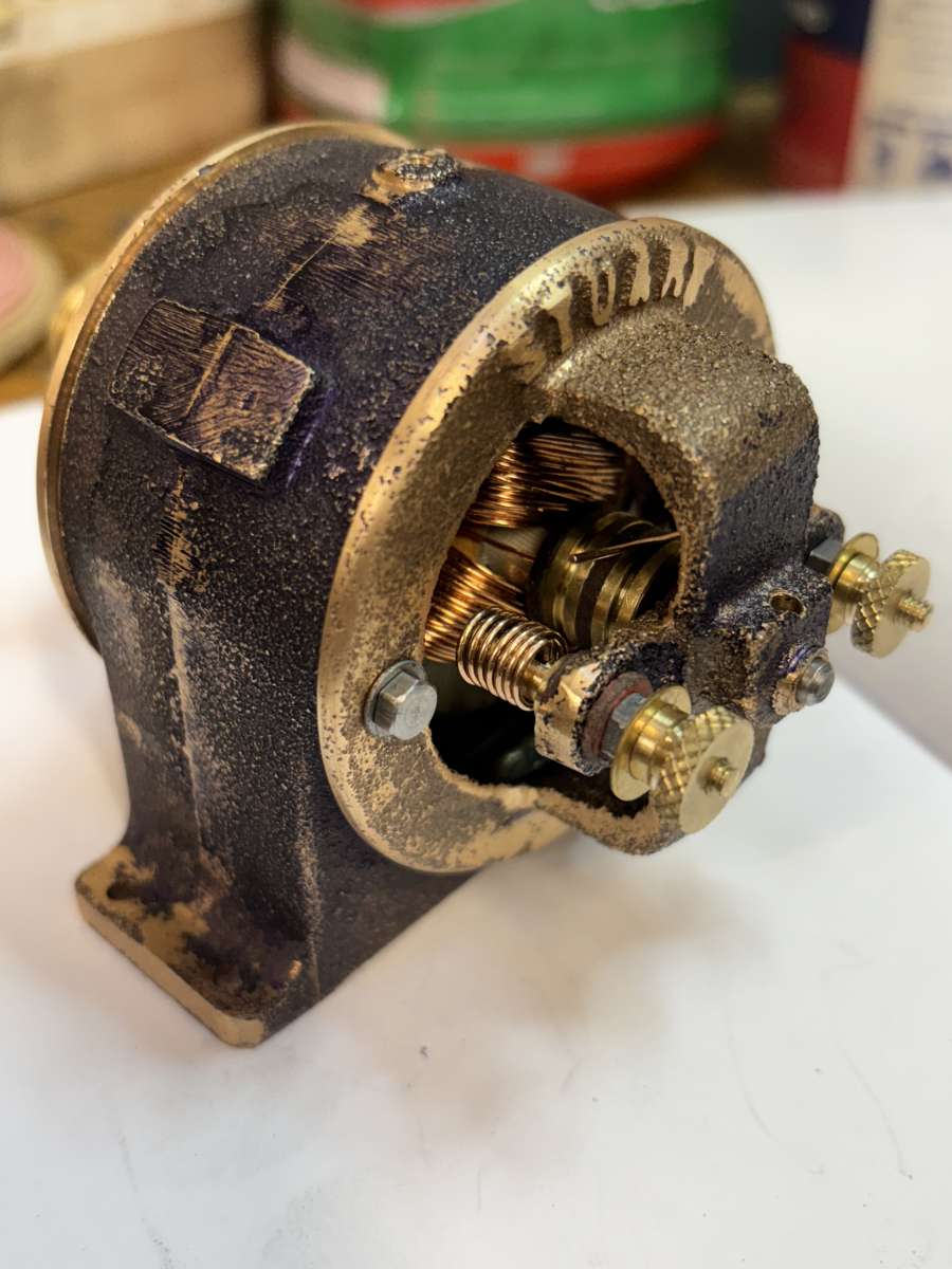

                                            Thanks all for the excellent responses, the device I have built is indeed the ‘Stuart Dynamo’ AC generator described in the 1965 catalogue provided by Michael, here it is!
                                            IMG_2450

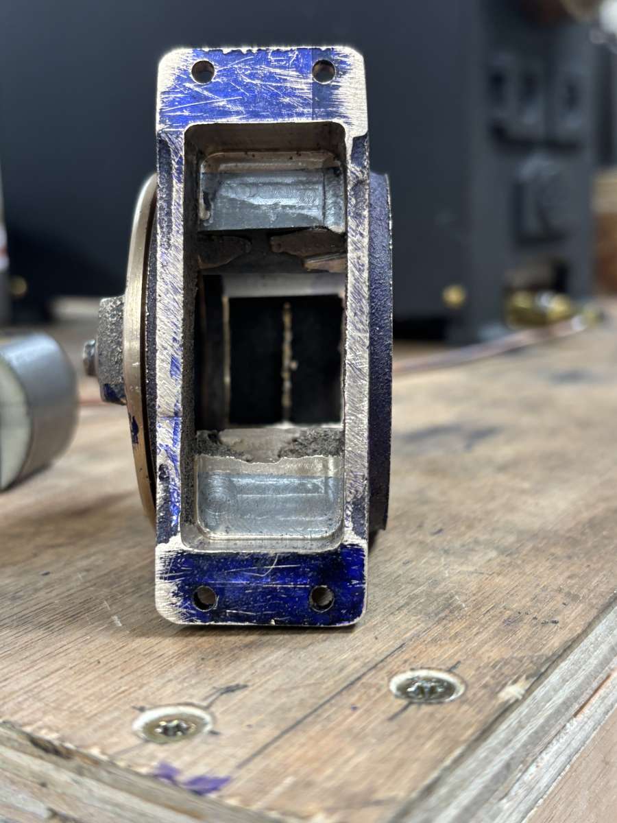

                                            I have made a little progress today, I stripped it back down and machined the magnet recess a little more to remove any vestiges of gun metal around the edges to ensure best possible contact with the poles, and also increased the tension on the Phosphor Bronze springs which make contact with the slip rings, and got an improved output:
                                            IMG_2447
                                            The bulb is 6V and is glowing slightly. It is also nearly 60 years since it was last illuminated!

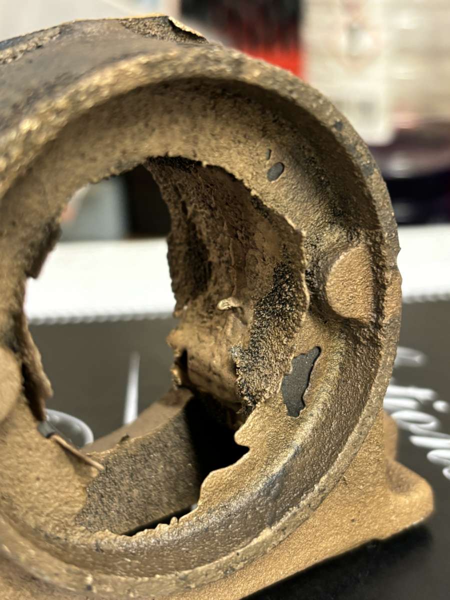

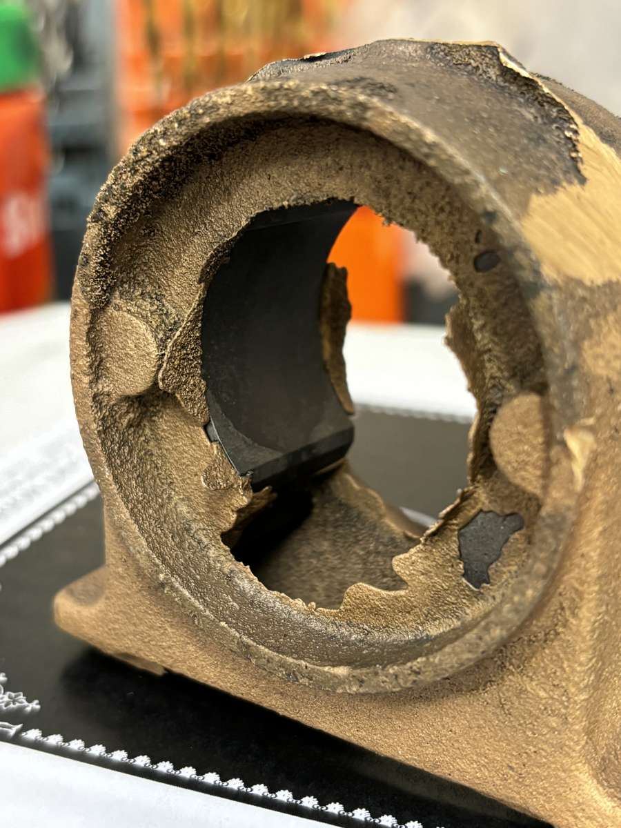

                                            The gun metal ‘skin’ on the right hand pole is likely having a significant effect due to increasing the air gap as has been pointed out by others, it is quite noticeable when holding a calibrated steel rod between the poles, so this certainly won’t be helping. I did wonder about the positioning of the poles when I received the castings, but impossible to work out how it would end up before machining.
                                            IMG_2122IMG_2121
                                            The magnet really does seem quite weak, I have experience of Samarium Cobalt magnets of similar size, and from memory they were a lot more powerful than the magnet supplied which can easily be pulled away from the pole pieces. Definitely an area for potential improvement, particularly when considering the air gap issue I have.
                                            IMG_2449
                                            I’m also now wondering about the speed of the drill I was using to drive the generator, I am seeking to find a better defined arrangement to drive up to 3000rpm.
                                            And to answer Noels point, I do intend to rectify the output once I can get the requisite Voltage out of it to drive LED ‘streetlights’ as part of a steamplant model.
                                            On a final point, I decided to fully document the build of this because the other 3 Stuart kits I have built (Oscillator, 10V and Beam) all had excellent books of constructor notes available which I found to be of immense value as a novice. I couldn’t find any construction notes on the ‘Dynamo’, and so having spent quite a while working out how to hold and machine the castings to achieve the required concentricity I decided to write it up to provide a bit of guidance for future novices. I can also add to the notes the fun and games of ‘commissioning’ it!
                                            #758009
                                              Great progress, Steve !
                                              “ One small step for Man … etc. “
                                              Please forgive me for mentioning it, but that casting looks disgraceful
                                              … they should be ashamed.

                                                    Michael has mentioned it and so will I ! Were that a new kit I would have sent the castings back to be changed, they are very poor, either the wrong sand was used or the ramming up was not hard enough. Now seeing the finished item one thought is that the wire pick up might be better done with a small carbon brush to avoid point contact and any resistance. This would probably need a pair of insulated brush boxes to be made.
                                                    Never the less it is good to see a project working. Noel.
                                                    #758067
                                                    John Haine
                                                      @johnhaine32865
                                                      Were the magnets really cast in-situ?  They look like ferrite to me.
