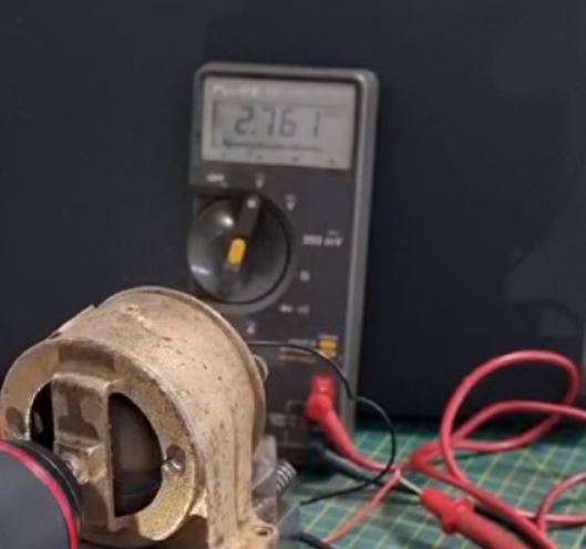

                      Did you see the thread I linked to Noel, 2.76V off the same dynamo when running at less than the stated 3000rpm for 3V so I would say it works as Stuarts say so no need for a redesign.
                      new mag
                      2 dyno
                      Same thread has a similar PMR dyno being used to charge a phone off a small PMR engine and boiler. Note pulley ratio so engine is not reving it’s nuts off. Most who build these are happy to have them light a single lamp often on a lamp post or several LEDs. If you want something to do real work then there are other kits available that will produce a lot more but do need a larger steam engine or hit & miss to drive them

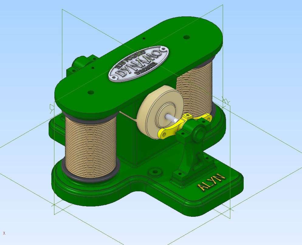

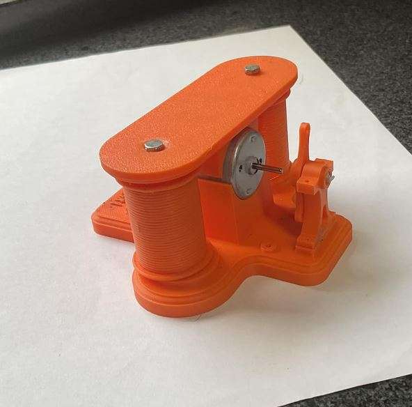

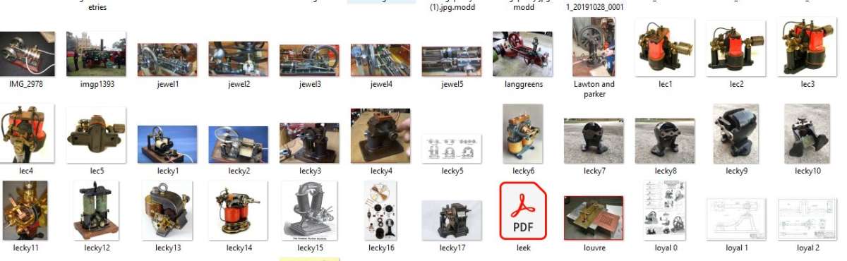

                            This one is on the “drawing board”
                            Options to just clamp a motor into it an paint the 3D printed parts so it looks real. Or cast it and use the commuter out of a larger motor and wind your own filed coils. Half way option is to have dummy outer field coil and a stack of Neodinium magnets in their place. rearrange the wiring a bit and you have an old bi-polar motor.
                            alyn dyno 1
                            alyn dyno 2

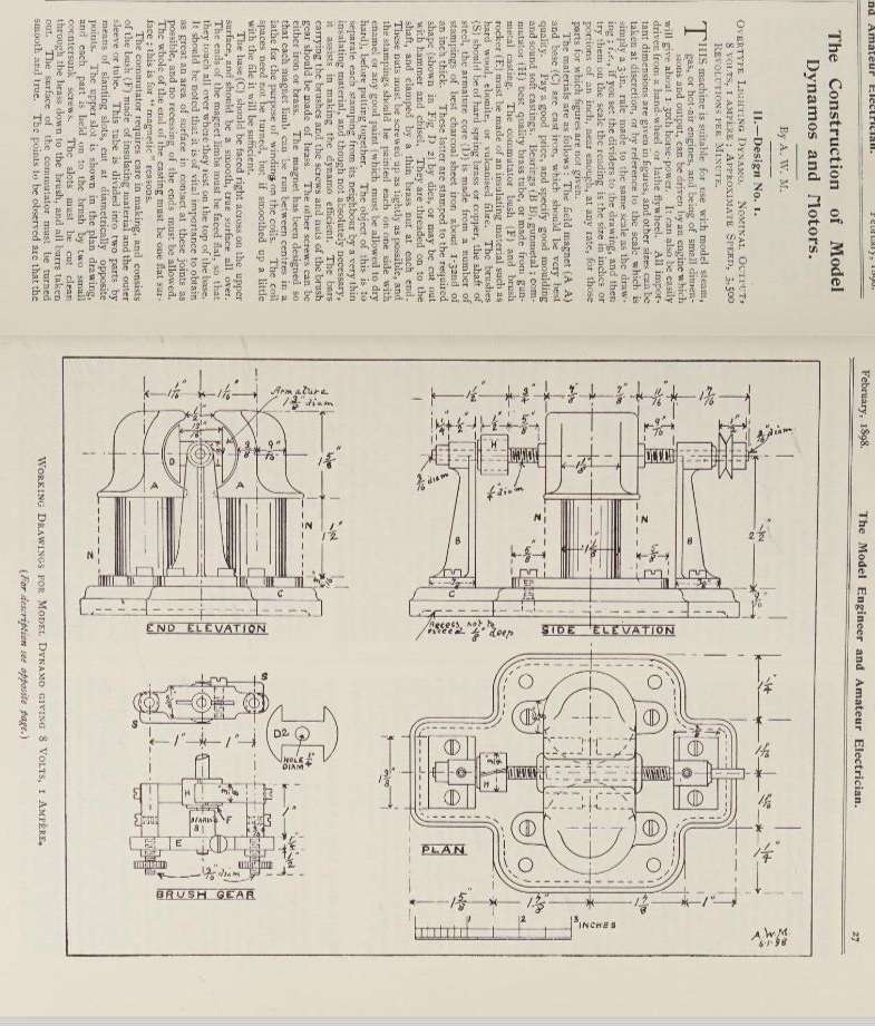

                            Or just dig out that old copy of ME
                            Capture 2
                            #758182
                            Robert Atkinson 2
                              @robertatkinson2
                              To reply to John’s comment on a modern design (post camr in while I was composing my last) If go in that I’d start with a modern Brushless DC (BLDC) “out-runner” motor of the type used in UAVs. These make excellent AC generators with 3 phase output. They are available from a few Watts to several kW. You can use filament lamps in sets of 3 or a six diode bridge wil give decent quality DC.
                              Like all permanent magnet generators you can only control the voltage by varying the speed. With modern switch-mode regulators it’s seay to convert a variable generator output to a fixed voltage if required.
                              The parts of the outrunner could be housed or mounted in a contemporary looking housing.
                              I’ve used out an out-runner as a proper generator but it was a work project so can’t say more.
                              Robert.
                              Edit: Jason has similar ideas…

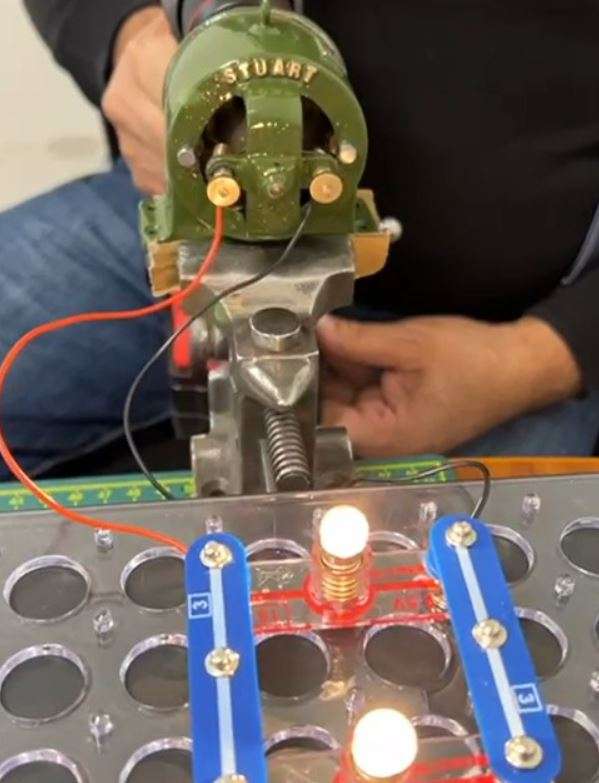

                                  Good to see Steve has got a 6V bulb to glimmer.   But how many amps or watts is the bulb?  It’s important to match the load to the generator.
                                  A push-bike rear filament bulb is 6V @ 40mA (or 0.24W), whereas a 6V motorbike headlamp will be 25W, requiring 4A for full brilliance.   0.24W is a light load, and should work.  Not full brilliance because this is nominally a 4V generator.   A 25W bulb is a heavy load, and if Steve got light out of one, then the generator is OK.   What’s the current or watt rating of your test bulb Steve?
                                  I don’t think Stuart’s blurb says what the dynamo’s output power is, naughty them, because it’s not obvious what the test load should be.    Stuart only mention it being able to light up a few 4V filament bulbs.  Probably made sense in ye olde days because I believe 4V bulbs were common on push bikes and torches before WW2, but after then bulbs seem to be either 3V or 6V.    Small 4V bulbs appear to be almost unobtainium today!  My initial guess is the generator is good for 1W out, roughly 250mA at 4V.  Unlikely to manage anything like 10W out, which is 2.5A at 4V.
                                  Steve’s basic multimeter may be misleading him:
                                  • As a load, the meter isn’t not matched to the generator.
                                  • The lowest AC scale is max 200V, not ideal for measuring a device outputting 4V or less.
                                  • The meter is probably only designed to measure AC accurately between 50 or 60Hz.  Depending on what’s inside, it may  misreport voltages at both higher and lower frequencies.
                                  However, if the generator is making a 6V bulb glimmer, then it’s certainly capable of brightly lighting 4 to 6 LEDs, maybe more.  Rule of thumb I assume 20mA for an ordinary junk-box LED, but 2mA LEDs are cheap enough, so maybe 40 of them.  Won’t do of course if Steve wants power rather than pretty lights!

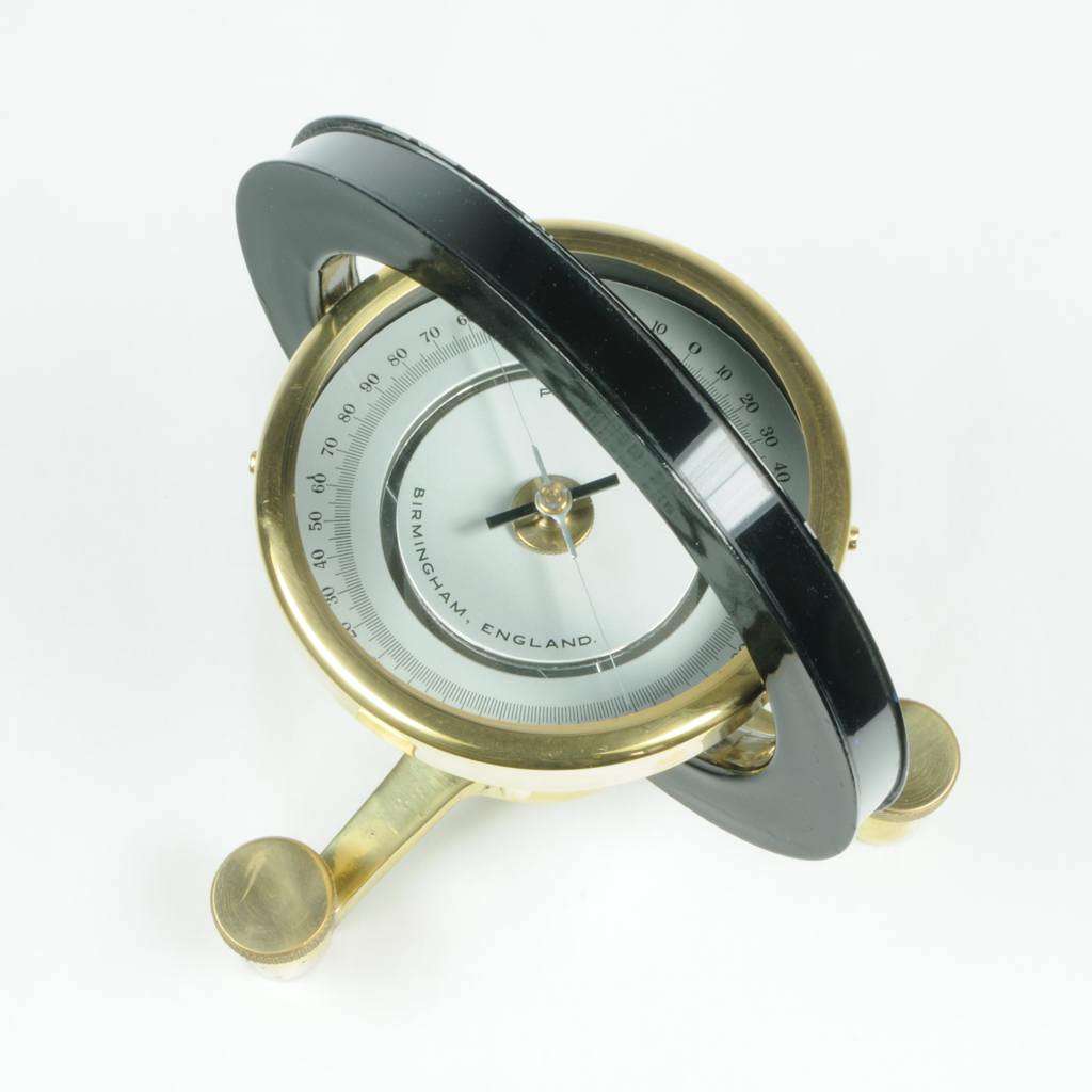

                                          Now that takes me back to school.   Didn’t have to make the galvanometer, but were given a compass about 150mm diameter, which sat inside a coil, rather like this:
                                          Tangent_galvanometer_Philip-Harris_top1
                                          Not too difficult to make.   Didn’t go well at school.   I messed up the calculation.
                                          Another back to basics approach might be to measure the volume of Hydrogen evolved by electrolysing water with the generator running at a fixed speed for a fixed time.

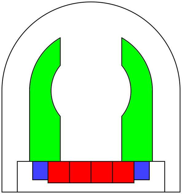

                                            If the configuration is as in this sketch, with a flat interface with the pole pieces (green), I would be tempted to buy some cube shaped rare earth magnets (red) and make a couple of flux couplers (blue) from iron or mild steel. Air gaps need to be minimal, but will be much less than running clearance, and magnets should be as big as can be fitted in. Magnets in series will “add”, and should all attract each other in the correct layout. Avoid parallel magnets which repel each other if “added”. Should work, but no guarantee!
                                            #758223
                                            Ian P
                                              @ianp
                                              +1 to Malcolm’s suggestion

                                                      Thank for the suggestion to eliminate a rectifier Duncan, I’ve ordered some Neodymium magnets to play with today, so will soon know where I end up peak voltage wise and whether the extra diodes will be required.
                                                      Noel, I did indeed question the castings with the supplier before machining, and yes the pick-ups could well be improved!
                                                      John the magnet fits in a recess machined in the bottom of the casting where it sits across the ends of the 2 pole pieces which are cast-in situ.
