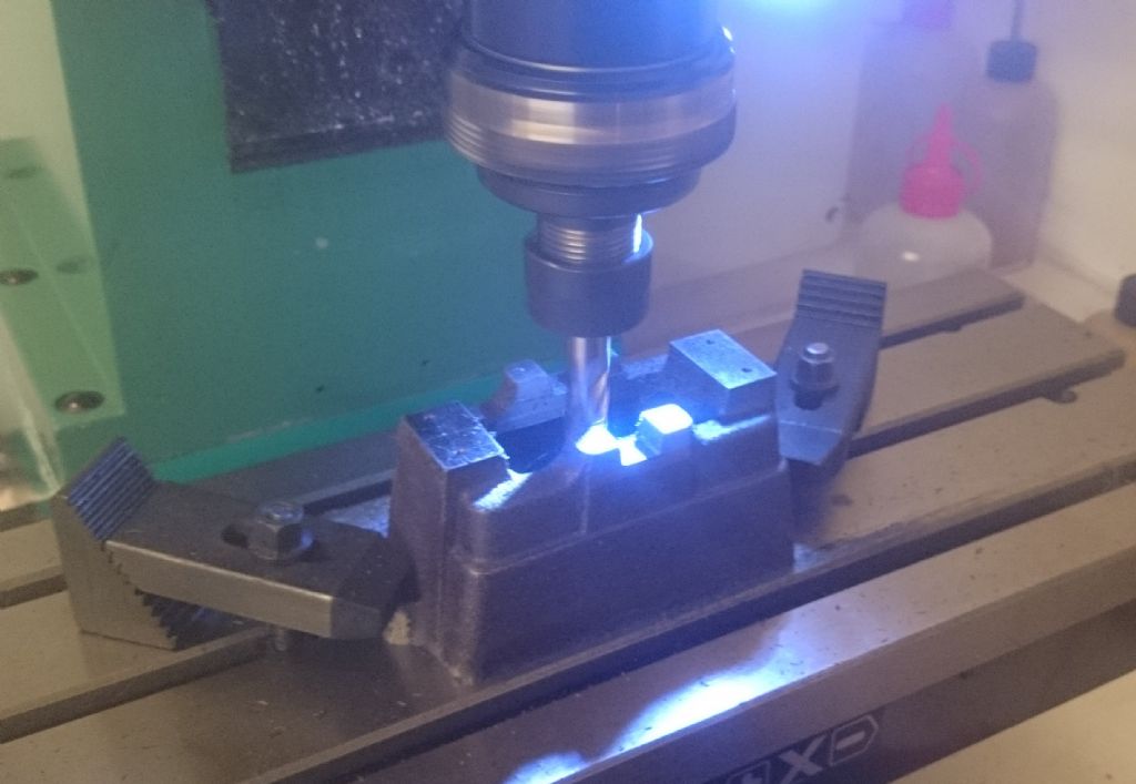

Started on the base box and base plate; carefully hand filed the flashings off and checked the castings on the mill table for no rocking; held in the vice upside down on a piece of cartridge paper tapped down. Milled the bottom just fine, measured, then did the top, all OK, correct thickness etc.
Same thing with the base plate, this had a lot more flashing so filed it all off and machined the bottom after placing on parallels. Did the bearing posts and standard areas. Again no problem.

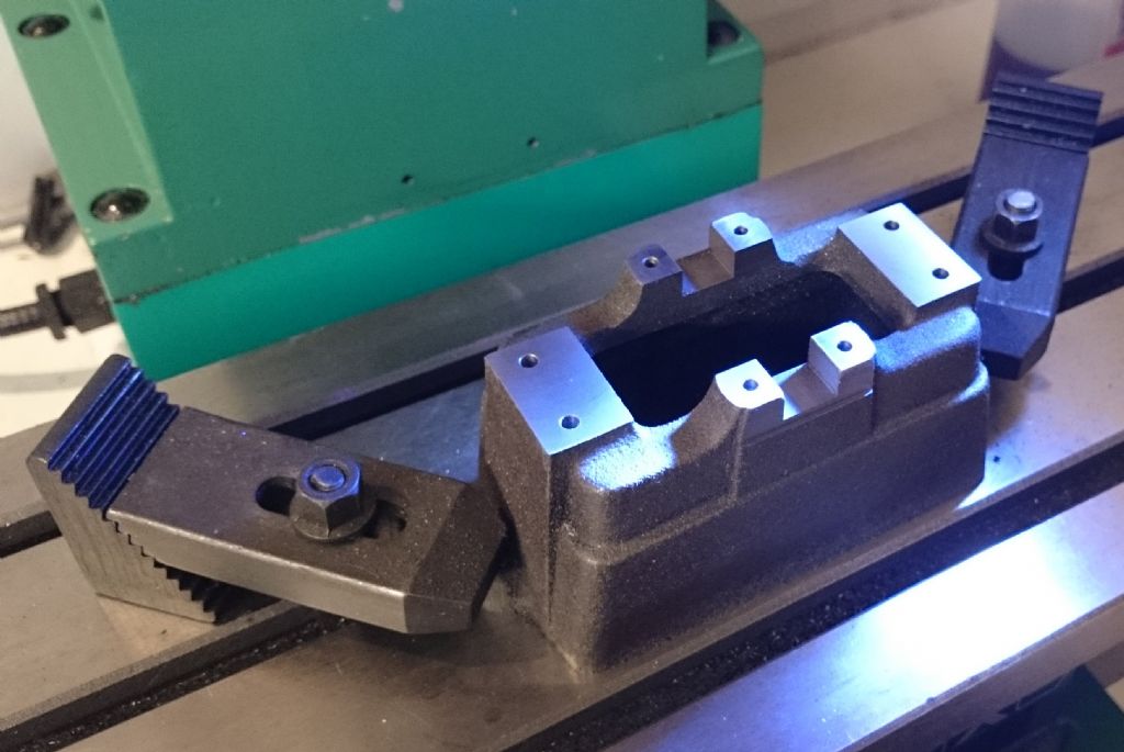

Where I am a bit stuck is this:
I now want to use the X/Y DRO on the mill to do the 4 holes in the base box and the other holes in the plate but how can I set my zero when I am not totally sure that the castings are sitting EXACTLY square in the milling vice?
I filed as best I can and they LOOK OK but I can foresee problems if they are out a tad.
This has not mattered in the facing operations.
As the vertical sides are tapered I am not sure where to touch off if using a centre finder, also the edges are not machined so will a centre finder give an accurate reading, probably not ?
My other intention was to drill one hole in the base box using one of the dimples and use this as a zero for the other holes. Do the same with the plate and bolt together then drill the plate but I am just not sure about alignment etc. Is there a better way please?
