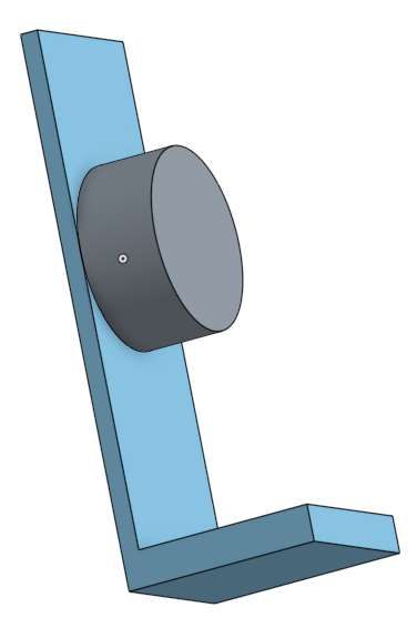

        Next I want to try and work out how well this would fare in similar circumstances.stand2.jpg
        The idea is to have the indicator and mount bolted to the vertical bar – in either orientation. when as shown above there is a natural balance. If I turned the indicator round I'd need to put a weight on the base to stop it falling over. (I want to keep the base thin so I can slide it things)
        I can see there is a compressive force down on the bar, but also a moment which will tilt it forward and reduce the height a tiny amount. My gut feel is that the effect will be small, but the mathematics may prove me wrong.

            For my mount as described above, here are my calculations.
            Assuming the indicator mounted 200mm up the vertical.
            compressive strain difference with the 200gms of indicator loaded or not, with a 50x6mm steel bar amounts to about a nanometer (6.67*10^-10). Nothing to worry about there!
            In terms of the effect of the torsion because the indicator hangs 50mm off the centre of the bar, i *think* the correct way to calculate this is to work out the moment of the indicator (2 N * .05 m) and then apply this moment to the vertical bar to see what the sideways force is. Then calculate the deflection of the vertical bar based on the force.
            If this is right, the sideways force amounts to 0.5N and the deflection (horizontal) around 1 micron. the change in effective height due to this is stupid small (10E-12 – a picometer?).
            These values are pretty similar if I use Al instead of steel – by similar I mean totally negligable.
            As I have some Ally of the right size I will probably give it a go in that rather than wait for some steel.
            Iain

              Posted by Iain Downs on 12/11/2016 11:32:01:
              Good to see we're on the same wavelength now, Iain
              [see item 4 in my post of 08-Nov.]
