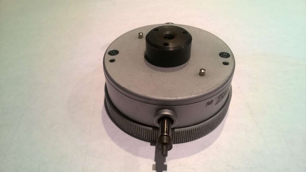

      I've acquired a Geneve Micron indicator from the auction-site-which-may-not-be-named.
      My other indicators have various mounting lugs non of which are like the above. So I want to create a mount which will take a 6×8 bar from my height gauge or a 10mm rod from a standard magnetic mount.
      My problem (if it is a problem) is that this thing is heavy. It weights 250gms – half a pound in old money.
      I'm thinking I can make the mount in aluminium or steel. Essentially, I'll take a cylinder about 50mm in diameter and 15mm deep and bore recesses and cut holes as appropriate.
      If I make it in steel it will be heavy which may cause droop on whatever it is mounted on. If I make it in ally it will be much lighter, but will it be stiff enough to support the indicator in rods and bars?
      Or am I worrying over nothing?
      I can ameliorate the steel weight by milling out the areas around the holes and so on, but this in turn may reduce the stiffness – and will double the time to make the thing.
      Your usual excellent (and sometimes unexpected) advice is antipated!

          Stiffness is largely a function of diameter (that's why scaffold poles are tubes not bars) so you get the same stiffness for less weight from a piece of pipe. Try to design something with the core removed or from suitably sized pipe.
          Martin

            Hi Iain,
            You may want to watch this video by the excellent Stefan Gotteswinter on indicator sag.
            Here is a link **LINK**
            I think the aluminium version would be fine but perhaps a steel sleeve to attach the rod.
            Regards.
            David

                If being used as a “comparitor”.
                The droop will remain the same, and hence irrelevant, if the measurement “force” remains the same.
                Careful design of the clock will mitigate the variation of force with measurement displacement. .
                That aside stiffness or rather lack of stiffness will frustrate you evey time you use it.
                I second the tube solution..maybe with rod under tension down core

                  The stands on the dti holders for use on a surface plate are more rigid than the typical type used on a lathe. One I have for instance has a 7/8" dia vertical pole and the articulated one is 5/8" dia.
                  That was probably intended to allow accurate comparison using a 1/10,000" dti.

                        Iain,
                        1. I'm very envious … wish I had seen that one.
                        2. Martin's remark about scaffold poles is spot-on [whether we are talking about arms, or brackets], but I would just add that circular cross-section is not necessarily optimum … if the loading is predominantly in one direction, then a 'deep' rectangular box-section may be more appropriate.
                        3. Yes: This indicator is unusually heavy, and minimising the incremental increase in weight will be advantageous … provided you can retain the necessary stiffness.
                        4. 'Stiffness to Weight Ratio' is what really matters here; and that can be varied by choice of shape or choice of material. Choice of shape has already been mentioned [and in-extremis, leads us to the monocoque shell] … Choice of material is interesting, in that most engineering materials will be found to have similar 'Stiffness to Weight Ratios' [so, a very thin steel shell weighs approximately the same as the thicker aluminium alloy shell of comparable stiffness] … Exotic materials such as titanium, and carbon fibre composites break out of this trap.
                        5. Using this as a 'general purpose' indicator would be [as my friends in Liverpool used to say] "like using a Rolls Royce to kill a Pig" … effective, but rather too good for the job! … Find a task that is worthy of it, and design your supporting bracket accordingly.
                        Sorry to witter-on … hopefully there is something of interest there.

                          Are there two tapped holes in the back?
                          If so, why not make up a plate with dowel holes to match the two dowels, and fix to to the form of adaptor, (1/4" dia?) to fit into the monkey block on your mag base?
                          Yes, keep it as light as possible, but not so thin that it flexes, (1/4"/6mm gauge plate springs to mind) with the adaptor bar screwed into the edge.
                          If it measures in microns, everything needs to be secure, but don't spend too long breathing on the set up or thermal expansion will become noticeable.
                          Howard

                            I'll double check for tapped holes, but I don't think so.The main fixing appears to be an M5 bolt going into the centre round lug. If there are it would make the task easier
                            I'm intending to use if for surface plate measurements not lathe measurements. If I got within a though on my lathe I would be ecstatic!
                            Tasks that are in it;s near future include checking out my surface plate (which appears to be a few tenths in one quadrant), getting the to flat of my prism spot on parallel with the base and flattening a piece of plate glass a bought to act as a lapping plate only to discover that optically good and flat are different things.
                            I can probably get the weight of a steel mount down to 150gms and an ally version down to 70 gms maybe?
                            Oh = there seems to be a tradition on not naming ebay in posts. I don't know why. I was being ironic…
                            I'll post a picture when I'm finished (which will likely not be soon)

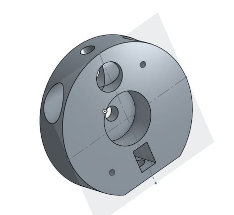

                                              I got a bit confused by the last few posts, but no matter – I've got a lot out of this thread.
                                              I'd assumed that the force to displace the indicator needle was small compared to the weight of the indicator. This appears to be wrong. if I hold the indicator above a scale (kitchen) it doesn't really start to read until the scale shows 100 g and that rises to nearly 200 gms and full displacement. The indicator scale covers 5mm but the actual displacement range is nearer 10.
                                              So the effective downward force could vary by a considerable amount. Obviously, if I'm comparing one height which 10 microns different to another this is not going to matter, but over a couple of mm it's important.
                                              So if I want to compare heights of the order of mm I need a much stiffer mount and base than over microns.
                                              The mount I hand in mind looks like this
                                              What's changed in my thinking is what that attaches to. One thing I want to do is to check the parallelism of my prism. For that I will make a stand that this bolts to and is a decent piece of steel down to a solid base. it will measure relative heights but only one or two centimetres away from an edge.
                                              In the diagram above I can attach to the 6×8 arm of my height gauge or a 10mm round bar from an indicator base. Fine I think for things like clocking a surface plate assuming it is reasonably close to spec.
                                              I need to think about balance though and might need a counter-balance on the other side of the base if I am looking at much more than 10cm.
                                              Iain

                                                Posted by Iain Downs on 11/11/2016 18:25:59:
                                                Iain
                                                Hey that's interesting!
                                                Wouldn't measuring anything remotely bendy (like a rod supported at one end in a chuck) be rendered inaccurate by an instrument needing that level of force to get a reading?
                                                Ta
