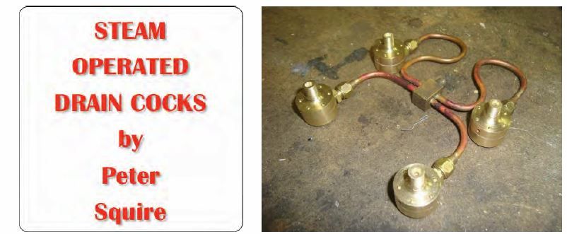

                  #447067
                  Fowlers Fury
                    @fowlersfury
                    In 2015 there was a short article on Steam Operated Drain Cocks in David Carpenter's Model Engineers Website. I like the design and eventually plan to make a set as described by Peter Squire.
                    Usual "for personal use only" applies to downloads, so check the website:-
                    **LINK**
                    Doubt there's a problem with me showing the article's heading:-
                    (You could PM me if interested)

                          #549334
                          Hans Hogendoorn
                            @hanshogendoorn60983
                            Maybe someone can help me, I downloaded some time ago this picture from a steam operated drain cock. This is all I have , is there someone recognize this part ? And maybe can help me with the rest?
                            Kind regards Hans

                              #549608
                              nigel jones 5
                                @nigeljones5
                                1. drain in
                                2. drain out
                                3. valve head
                                4. O ring
                                5. Gland nut
                                6. ferrule
                                7. Out of shot – live steam line
                                Simples – perhaps all that time spent trying to get them to work wasnt a complete waste! Whats not shown is that you will also need a steam relief valve to release pressure to operate the valve.
                                #549619

                                    #549685
                                    duncan webster 1
                                      @duncanwebster1
                                      I think it would work better with 2 connected to the cylinder and 1 as outlet. The drawing shows the OD of 1 not threaded, which agrees

                                        #549697
                                        John Olsen
                                          @johnolsen79199
                                          Sorry Duncan, 1 is the end that should connect to the cylinder. The pressure from the steam on the other end holds the valve on the seat. When there is no pressure there, any pressure in the cylinder can open the valve, allowing it to drain. The ones on my steam launch are just like the one shown, and they work fine. If the pressure in the cylinder gets high enough, say from trying to compress water, it can overcome the steam pressure on the other end and vent anyway, so they act as a relief valve, although I have also provided separate relief valves as well. The operating valve should be a changeover type, so that in one position it connects live steam to the valve, and in the other it connects the cylinder end of the valve to atmosphere.
                                          The operating cylinder part needs to be big enough to hold the valve on its seat, but not so much bigger that it won't act as a relief valve. The ratio of the areas will approximately determine the pressure at which it opens.
                                          I don't have drawings of mine, they were made by eye from a sketch, and they would be a bit big for all but the largest of model locos.

                                              #549783
                                              duncan webster 1
                                                @duncanwebster1
                                                Consider it my way round. The diameter of port 1 scales at half the outside diameter of the Oring, so the areas are 4:1. The area exposed to cylinder pressure is 3/4 of that exposed to boiler steam pressure, and so if cylinder pressure is 1.333 * boiler pressure the valve will open. The other way round you need cyl pressure = 4* boiler pressure to open it.
                                                As Fizzy says, both work. The drawing implies port 1 is exhaust as there is no thread to secure it.
                                                #549797
