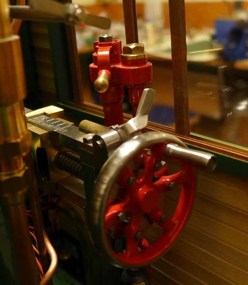

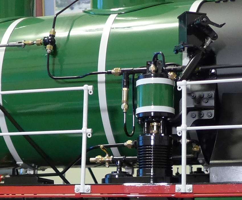

                                Hi All,
                                I have an air brake system on the Su class. It’s possibly a little over complex but does basically work. The brakes work at 15 to 20 psi, it’s an ‘inverse vacuum’ brake system in that I use larger diaphragm cylinders about 3 inch bore with fairly stout diaphragms in them. The brake compressor is based on a Brian Keim (USA) compressor. BUT the whole system runs at a two pressures. Why… Well, that’s where my usual slight overcomplication comes in. As per full size I have a mechanical lubricator feeding the steam side of the pump. This lubricator is driven by a steam piston fed from one side of the cylinder taking a pulse every time the top half of the cylinder is filled. In order for this to work correctly I have to keep the feed pressure fairly high. BUT, if the air cylinder is only providing 15 to 20 psi the drive pressure is too low. SO solution is, a pressure ‘relief’ valve on the compressor outlet set to 50psi. The compressor then needs to provide 50 psi to allow any air into the low pressure side of the system. The low pressure side is then safety-valved at 15 psi. So the system is supplied from the bleed of the compressor side and it then maintains the 15 psi needed to run the brakes. The compressor then has to ‘work’ at a sufficient level to allow the lubricator to operate correctly as per prototype….
                                Yes a lot of faff. Should I have gone for high pressure brakes in the 75 to 100 psi range…. YES…. But I only came up with the lubricator issue when the all the brake gear was constructed.
                                It’s controlled by a semi scale Westinghouse pattern brake control in the cab. Brakes operate on the three driving axles and the four tender axles.
                                Brake Compresor
                                Brake Valve

                                      Hi Paravoz,
                                      congratulations for this steam air pump setup! Which Steam and air piston diameters do you have?
                                      Ball or flat check valves at the air side? A very nice canopy setup of the brake valve and the handles!
                                      Werner
