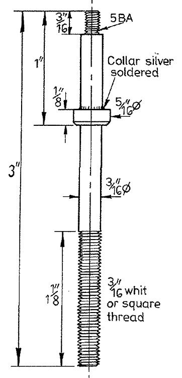

      Hello again, after more advice.
      This will defiantly be a run before you can walk type of question, but I would like to try and cut a square thread on the Minnie break screw.
      Is there a formula or something to work out what the depth & pitch should be?.
      Thanks for any advice.
      Brian

            3/16 BSW is 24tpi.
            According to my old Newnes Engineers Manual it gives the smallest standard Acme pitch as 16tpi. But it also gives these calculations.
            width of point of tool = (0.3707 / threads per in) – 0.0052
            depth of thread = 1/2pitch + 0.010
            flat at top of thread = pitch x 0.3707
            flat at root of thread = pitch x 0.3707 – 0.0052
            So from those calculations you could make a couple of tools to cut your 24tpi.
            #283315
              Square (not ACME) thread is easy to work out
              Assume 24tpi as per the Whit option
              width of cutter = 1 / (2xtpi) so 1 / (2×24) = 0.021"
              Use this width of cutter to cut the male thread and then stone a thou or two off the side and use the thinner cutter to make your tap from Silver steel. By slightly stoning the tool you get tap teeth that will leave a slight clearance for the male thread.
              Depth of cut is the same as the width so 0.021".

                For a full depth square thread the width of the thread, the width of the gap, and the depth of thread are all the same and equal to half the pitch. So if we assume the thead to be cut is 24tpi then the pitch is ~0.04167", and half that is 0.0208".
                A problem with square threads, and one reason why Acme threads became popular, is that the can interfere on the root, crest and flank independently.
                When I made my square thread brake shafts I hand ground and honed a HSS toolbit to the correct width, using a micrometer. I then cut taps in silver steel. Square, and Acme taps, usually come in a series with increasing OD, with the last tap cutting full depth. I cut the taps with the full OD and the correct depth of thread. My thread OD was ½" so I made a set of three:
                When I cut the brake shaft I made the OD a few thou undersize, and cut slightly deeper than theoretically correct. That should sort out the crest and root interference problems. Once I'd cut the square thread in the nut:
