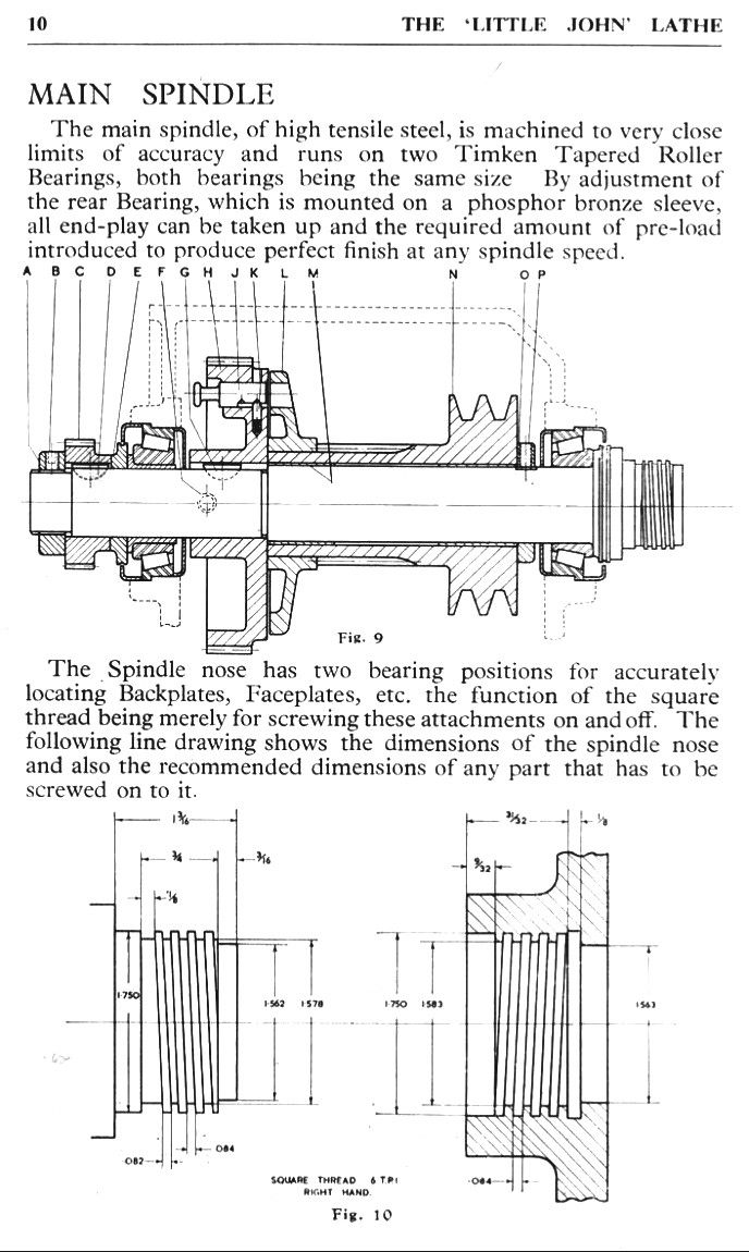

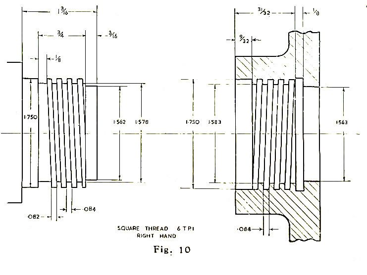

      Hi everyone
      I'm looking for a little guidance I need to cut an internal square thread to make a back new back plate to hold a small 3 inch chuck, my question is can a internal grooving tool be used to cut a internal Square thread and/or which tool type would be recommended
      Many thanks
      George
      I've put a picture of thread in my gallery

                @georgejervis86082
                Hi David G
                The thread is a right hand 1.75" by 6 TPI, my lathe is a Raglan little john mk 2 (5&quot with a qcgb . I have cut external threads many times but never really attempted internal threads, my Lathe can be reversed with switch but the spindle nose is threaded so it might unscrew? . I was just wondering if grooving tools could be used or if there was something better? I have a P horn internal grooving tool but haven't had much success with it as the shank has been ground a away and it vibrates so I don't really use it. threading with it is impossible

                          Pete Rimmer
                            @peterimmer30576
                            George, I cleaned up your photo a bit. Not the best result but it's a bit easier if you ever want to print it out.
                            It would be nice to get a pic of the whole page if you could. If you took the pic with your smartphone there's a great app called CaMScanner that will automatically clean up photos to make them much more readable.
                            Pete.
                            #460995
                            George Jervis
                              @georgejervis86082
                              Hi Peter
                              Thank you for the app info I've installed it now and put the rest of the page in my album
                              Many thanks
                              George
                              #461017
                              Pete Rimmer
                                @peterimmer30576
                                Nice one George, that has come out much better. I don;t know how they do it but they do it well!
                                Now, if you get really bored in your isolation and fancy doing the whole manual, send it to me and I'll make a very nice PDF for you.
