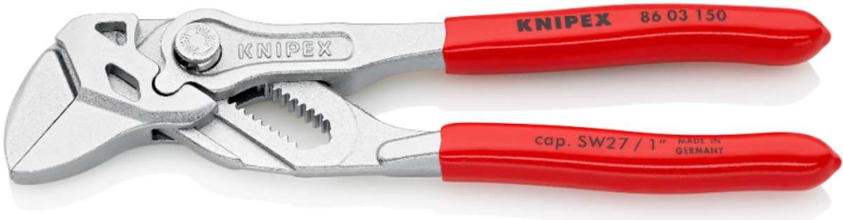

                                Robert Atkinson 2
                                  @robertatkinson2
                                  For this type of fitting and other delicate items like odd sized coaxial connectors, I have a pair of Knipex “plier-wrench” https://www.knipex.com/products/pipe-wrenches-and-water-pump-pliers/pliers-wrenches-pliers-and-a-wrench-in-a-single-tool/pliers-wrenches-pliers-and-wrench-single-tool/8603150
                                  knipex
                                  Parallel action, smooth faces and locking coarse adjustment. They also do soft covers for the faces.
                                  Very high quality and priced to match, around £40. Mine are never used on rough surfaces. They do larger and smaller sizes.
                                  Coaxial (radio) connectors are a whole other world. Fortunatly most are standard sizes across flats. However most are soft metal and a lot have narrow access. Good quality thin spanners are expensive. The Precision connectors need a torque wrench. I have a small selection of spanners reserved for connectors…

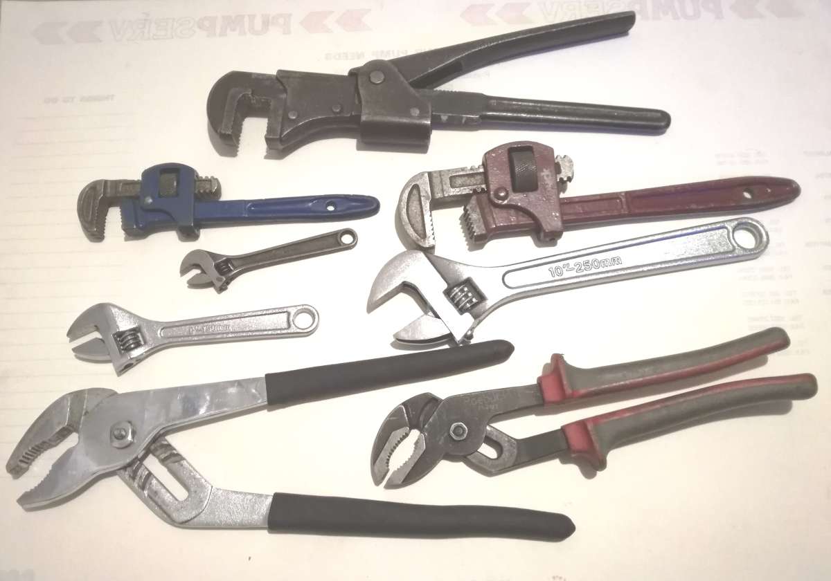

                                              Nicholas Farr
                                                @nicholasfarr14254
                                                Hi, apart from Basin spanners and those used for immersion heaters, and any special types, I don’t think there is any run of the mill spanners specifically known as BSP. Some fittings will fit metric/imperial common sizes of spanners, but it will largely depend on who makes the fittings. Stillson’s, adjustable spanners, and water pump pliers, all come in a range of sizes, as do quick adjustable wrenches, all of which I’ve used in my day jobs, and I’ve got a least one of every size in the standard range of Stillson’s.
                                                Wrenchs
                                                The blue Stillson is an 8″, and the small adjustable is a 100mm, the large water pump plier, will open to just over 60mm. The quick adjustable at the top will open to 75mm, but the jaws are only 30mm deep.
                                                Regards Nick.
