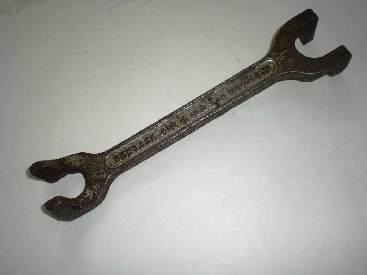

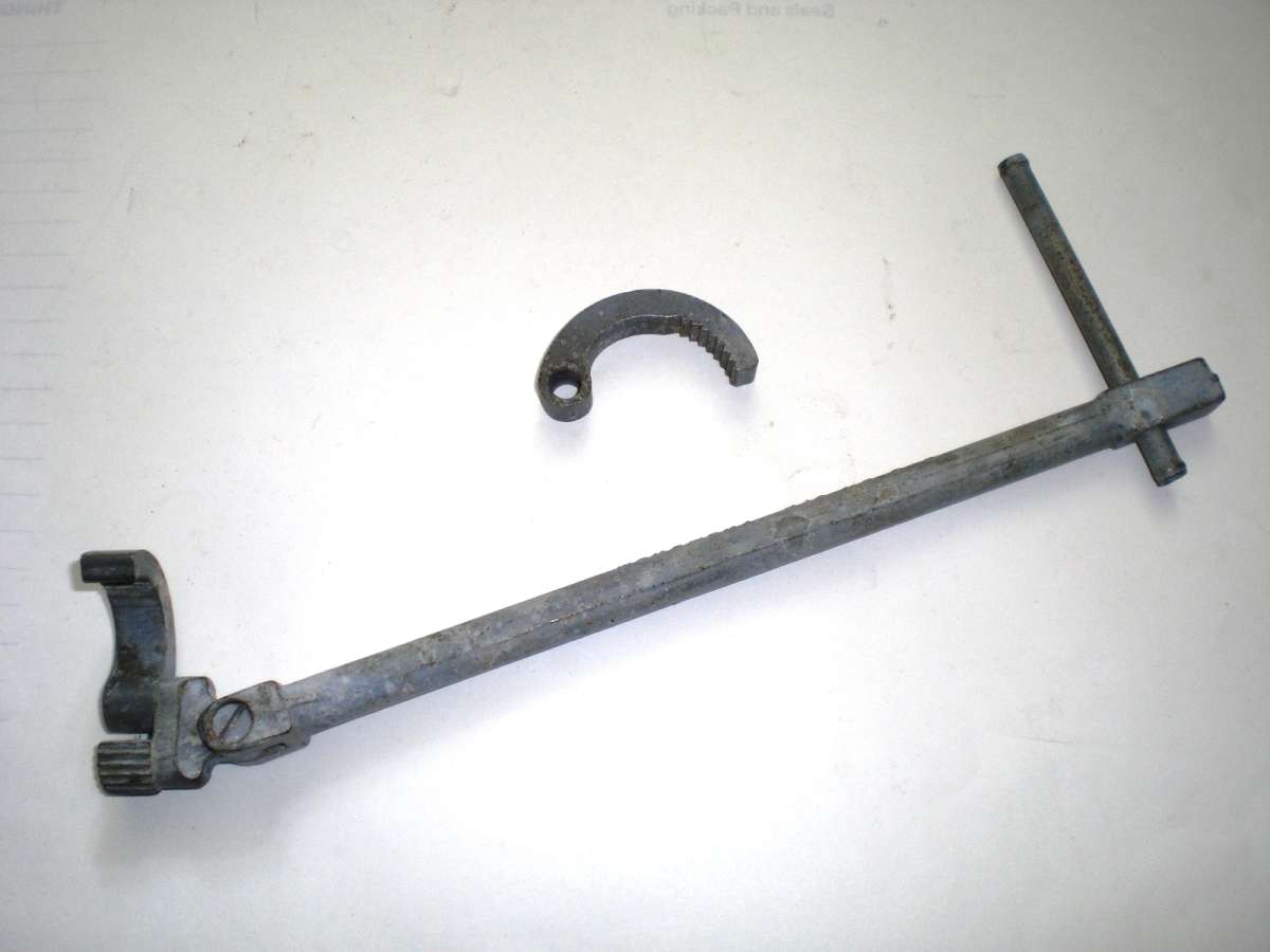

                  Hi Dave (SOD), which is why I mentioned Basin spanner, and which normally has one end that fits the Bath taps as well.
                  Basin Spanner 1
                  Although these can be awkward to use, even at the best of times, which is why I prefer the type shown below, including a jaw for the Bath taps, which is slightly longer than the type above, but you can get telescopic  ones of this type.
                  Basin Spanner 2
                  Regards Nick.

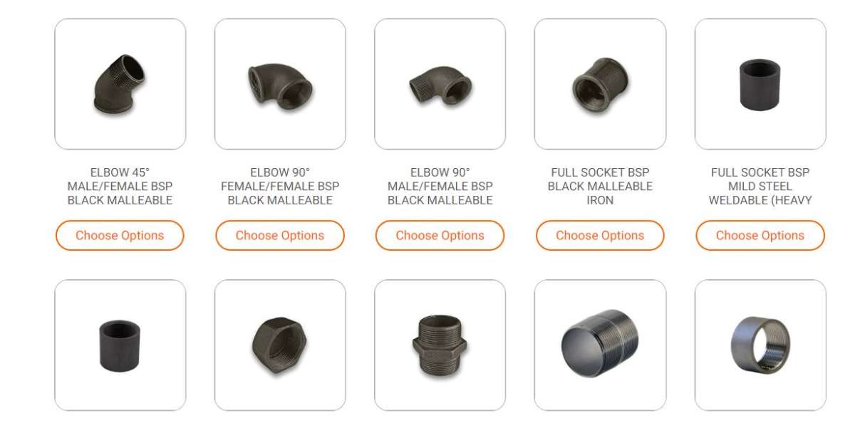

                          The wedge action of stilsons is meant to grip black iron pipe or other round stuff not the fittings unless the flats have gone already.
                          #729225
                            There are a lot that don’t have flats
                            flats
                                  flats
                                  They come under the heading of ’round stuff’ being, um, well kinda – round ish.
                                  We all use what we have that fits as far as domestic plumbing goes. The most useful one I have is a very stubby adjustable as long as your fist is wide that I paid two quid for about five years ago.
