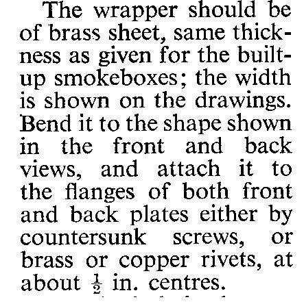

                  From LBSC instructions for 'Netta'
