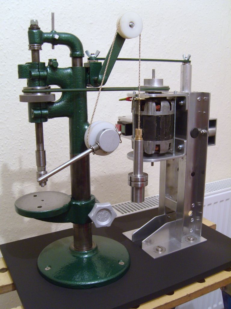

                    I have a different one that wasn't originally a sensitive one, but I converted it to a sensitive balanced one for drilling and tapping.

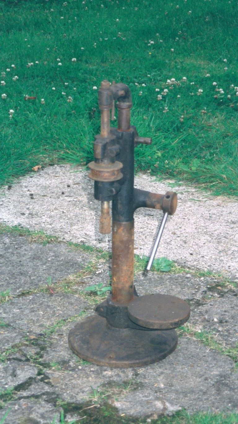

                    I bought it at a Steam Engine Rally many years ago, which is shown in the next photo as it was then.
                    This conversion was done with virtually used materials, the motor came from an old electric typewriter. This drill stands about 560mm high and has a 110mm round table and is a fair bit heavier than the Bonds one.

                      I like the 'straight' belt drive you've arranged there Nicholas – I'm thinking of converting my Cowells to something similar – using 90 degree drive-pulleys seems to come with a lot of belt slap.

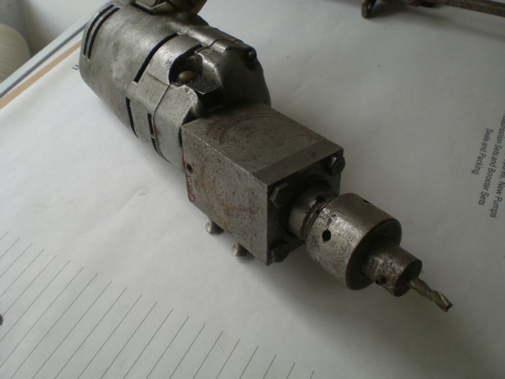

                                                  This DIY milling head I made, uses a motor from a B&D lawn mower that I had given me, and it had a hard life on my rough terrain grassed area. The frame of the mower rusted away and the wheels fell off, but the motor still woks OK, I've coupled it to a two speed gear box from a B&D drill and put the single speed gear box on the drill, which is years old and is still working fine.
