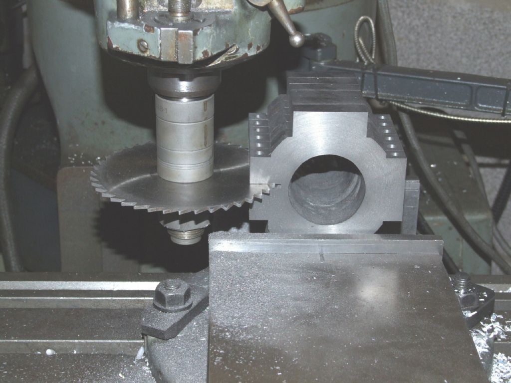

It depends on what you want to do with the saw. Slitting saws come in two basic types, fine tooth, ie, lots of teeth, and coarse tooth, fewer teeth. In this picture most of the slitting saws are coarse, the thin one bottom right is fine:
Fine tooth slitting saws are for shallow slots, like screw heads. Use them for deeper slots and they'll jam, irrespective of the material. Coarse tooth slitting saws are intended for cutting deep slots. I use a slitting saw like the one top left for cutting up lumps of hot rolled steel. Depth of cut can be up to ½" with a tooth load of 2-4 thou. Here's a deep cut in cast iron:
