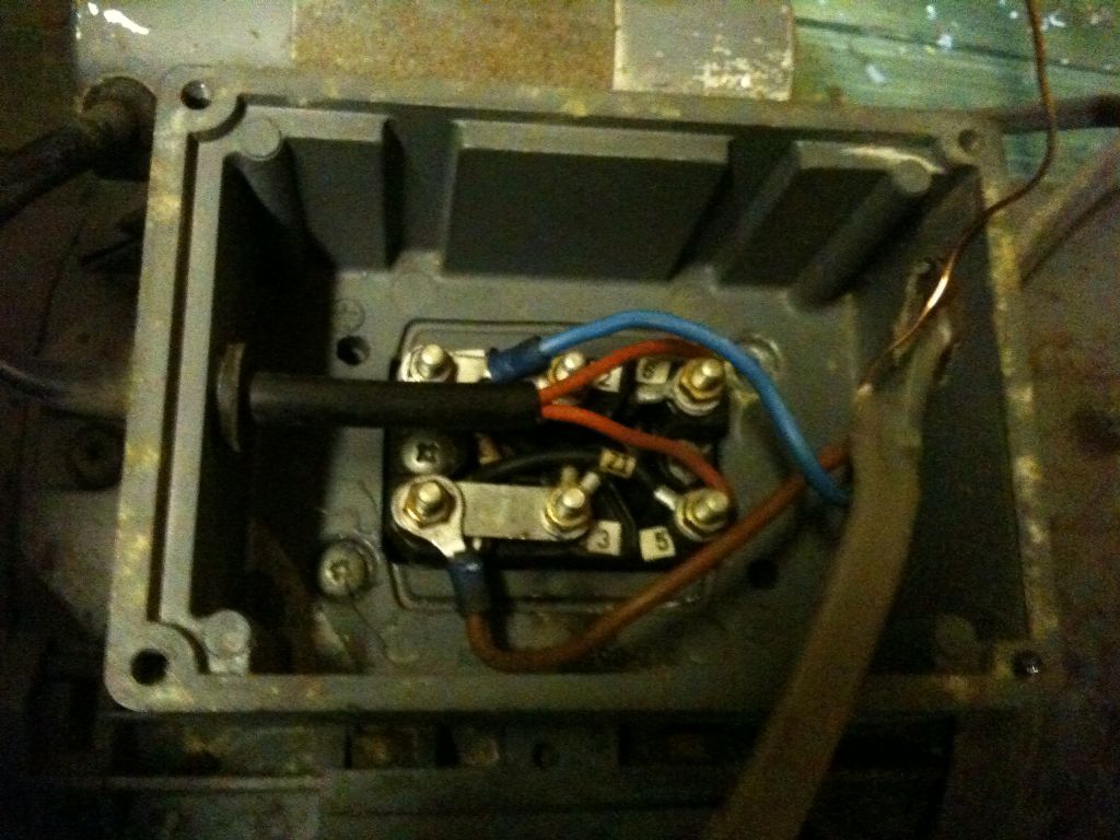

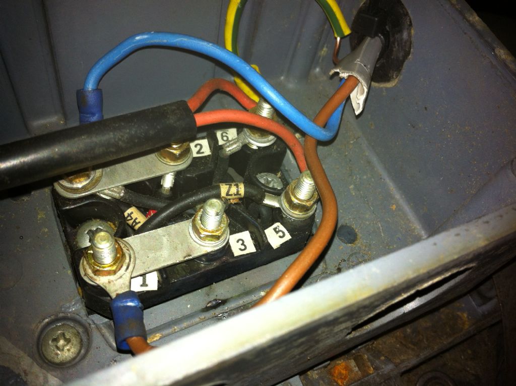

                hi there again.
                here is a photo of the control box.please can someone help ?
                wiring for my motor in forward
                #85659
                Les Jones 1
                  @lesjones1
                  Hi Leigh,
                  The cable going to the capacitor obscures most of the wires going to the inside of the motor and it also obscures what I think is terminal 2 (Middle top.) From the photograph I can only identify the label on one wire that goes into the motor. (Z1 to terminal 5)
                  1 How many wires go to the inside of the motor ?
                  2 Which terminal do these wires go to and what labels if any are on these wires ?
                  Les.
                  #85664
                  john fletcher 1
                    @johnfletcher1
                    I have just looked in my garage at a similar motor with a not so different terminal box.I suggest you take a piece of paper and a pencil and make a sketch of the terminal box and note the colour and position of all the wires.It would appear that all you have to is move the links. Remove the incoming flat twin and earth, then move both link from the horizontal positions to vertical. Bottom left to top left and one I think link marked C to terminal above it.Next your input, and by the way you ought to using better or more appropriate cable with Green/yellow sleeve for the earth, connect supply to bottom left and the next terminal to it, marked C, I think. Well there you have it according the label on my motor. You can only blow the fuse if its wrong. If you lived close I would fix it for you, I've done lots in the pasted and have a good ohm meter to test out which winding is which, start or run. I notice its cap start which is good.Let me know how you get on, oh and by the way you need a double pole switch with centre off for reversing a single phase motor, not a dewhirst and use a starter with NO volt release for your own protection.Ted

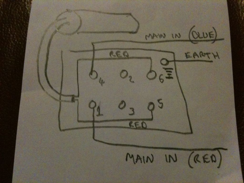

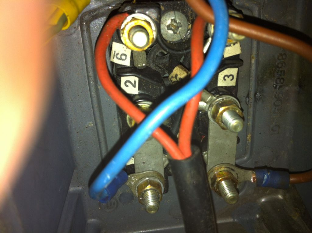

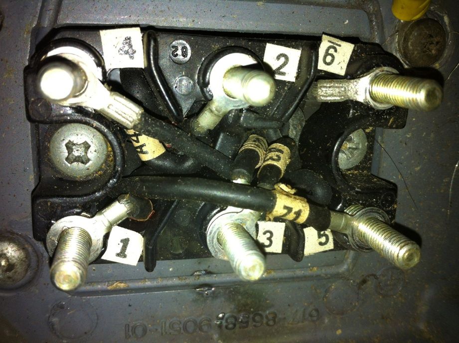

                      #85676
                      Leigh Davies
                        @leighdavies74764
                        #85679
                        Leigh Davies
                          @leighdavies74764
                          is this any help for photos.
                          #85680
                          Leigh Davies
                            @leighdavies74764
                            i dont really know what the other wires go to without stripping the motor electric box off. sorry.
                            #85692
                            Les Jones 1
                              @lesjones1
                              Hi Leigh,
                              I expected to see either 4 or 6 wires going to the inside of the motor depending on whether the start switch was connected internally or externaly to tha start winding. As there looks to be 8 wires coming out of the motor I have not worked out exactly how it is wired. I could probably work it out with a multimeter if I had access to the motor. I suspect John Fletcher 1's idea about moving the links is correct but I would not be prepared to try it without proving how the windings are connected to the terminals.

                                #85728
                                Les Jones 1
                                  @lesjones1
                                  Hi Leigh,
                                  As you can see from my profile I live in Ormskirk (About 15 m north of Liverpool.) so it is too far away from you to have a look at the motor. Now you have given your location there may be someone on the forum close enough to help. Also take note of Kinet Hall's comments on the other thread you have started on this subject. I had made the assumption that the earth was disconnected while you were taking photographs and the twin and earth was just a lash up for testing. (This type of cable would not normaly be used to connect directly to the motor.)

                                  #85749
                                  Russell Eberhardt
                                    @russelleberhardt48058
                                    The wires labelled Z1 and Z2 go to the start winding. To change the rotation direction you just need to swap these over. Usually this is done by moving the links for example like this: http://www.net-eng.co.uk/pdfs/Motors/single-phase-revers.pdf. However it looks to me as if your motor has had an external capacitor added to replace a faulty internal one and the wiring has been changed somewhat. If you can just swap the Z1 and Z2 connections it should work.
