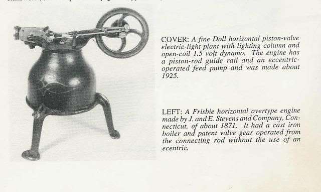

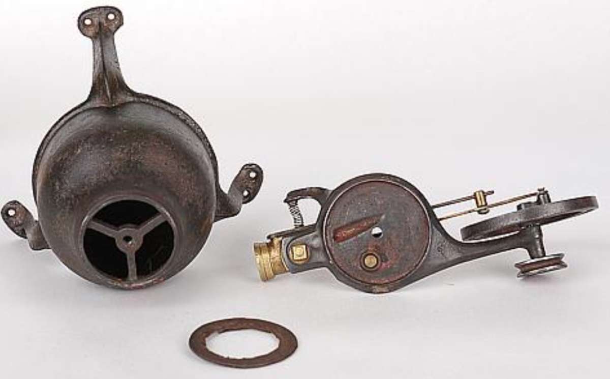

                            #827836
                              Here is a Frisbie engine from 1871. Cast Iron boiler and in this case top cap. Fibre sealing washer (don’t know what sort of fibres) and a screw to hold them together, I’ve seen them with both brass and steel screws. No safety valve not that one is needed. Just light the spirit burner and wait for it to warm up. I’ve got this down on my list of engines to replicate.
                              frisbie 4
                              frisbie 7
