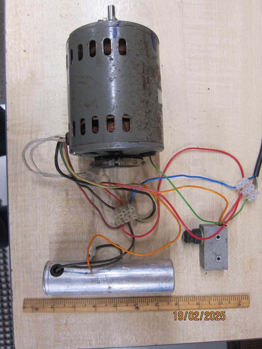

      Hi – I have attached a photo of my vintage 2850rpm GEC induction motor under test with an equally vintage TCC capacitor wired into the circuit using a micro-switch to attain a push On/Off capacitor start arrangement. The capacitor is one that I have had in my collection and is rated 40-50mF at 275V and everything is working as expected with the motor without any signs of running hot.
      What I would like to be able to do is to change to a capacitor Start and Run arrangement using a modern choice of capacitor physically smaller in size compared to the one shown which measures 6”x1.5″ Diameter.
      Can anyone suggest a possible source of Start and Run capacitors which might be suitable for the above arrangement.
      Finally, what actually defines a Start and Run Capacitor as opposed to a Start Capacitor and how can you distinguish one from another?

          A run capacitor has to pass current all the time the motor is running so they generally have thicker electrodes making them bigger and more expensive. A “run” capacitor can be used for starting assuming the value is correct. Hence the they are often called start/run.
          Is the motor marked with a capacitor value?
