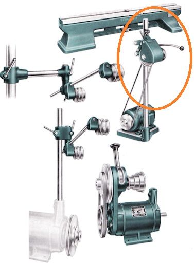

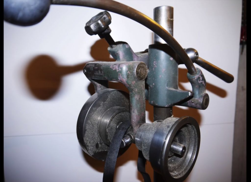

      Greetings, some help needed here. Does anyone owns a Schaublin 70/102 power by an overhead drive? It has a curve handle and set of step pulleys from the motor to above and downwards to the lathe's headstock pulley.
      I'm rebuilding the overhead levers, appreciates anyone send some photos.

          If you put up a few photos of what you already have to work with it will help to get the ball rolling

              overhead1.jpgHi Ady and Bob, here's the photos I'm asking about…not sure how the assembly should be. Yes, Bob the design is a bit crude but I lack of space around the headstock area for pulley mount so the only space left is motor above. overhead_drive.jpg

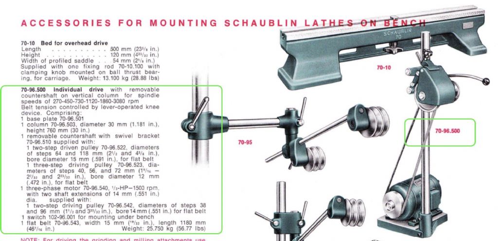

                This probably doesn’t help … but just in case:
                Credit: Anglo-Swiss Tools : Schaublin 70 Catalogue 1962
                **LINK** : http://anglo-swiss-tools.co.uk/downloads/

                    It looks like it rotates/pulls down to loosen and move the belts
