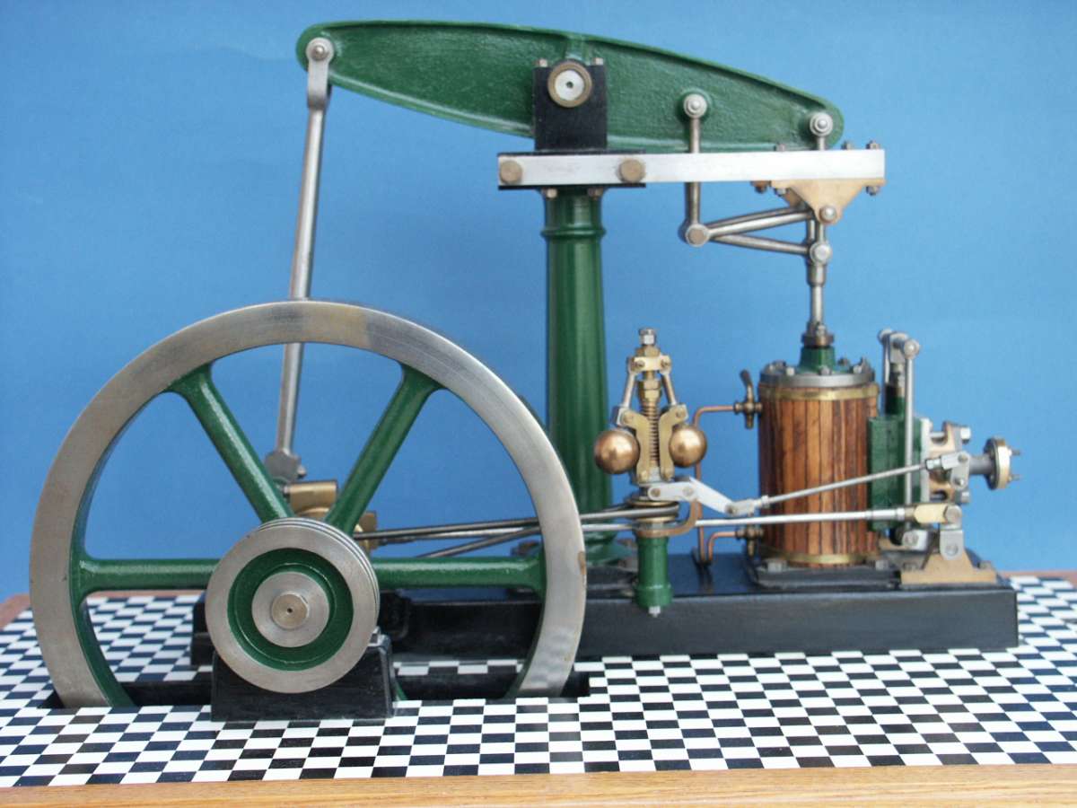

      I’m half way through making a Stuart and Turner beam engine. I’m thinking of adding gearing and pulley reduction to ‘drive’ a faux dynamo, in practice a small geared motor to drive the engine. 2 questions:-

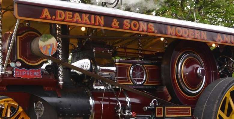

      1) What is a typical showman’s engine dynamo speed. As seen at a steam fair, not max! I’m thinking a typical beam engine speed would have been around 30RPM?
      2) What DP (or module) would look right on the gears? I think the Stuart model scale is about 1″
      #837908
        The Stuart one is generally regarded a sbeing based on quite a small beam engine which would have had a flywheel in the region of 5ft so that makes it around 1/8″ scale.
        The slightly larger ME Beam used 32DP gears so I would say 40DP or 0.5MOD would look about right.
        A showmans engine will be generating at a fair speed as the belt comes off the large flywheel and runs on quite a small pulley so you have a step up of at least 10times. So around 750rpm at the dynamo is quite likely.
        If you are just wanting to turn the engine over for show then a small cheap gear head motor and electric speed control could be hidden in teh base and just use a friction drive against the flywheel. Either set it into the provided cast iron box bed or chop that down to about 1″ thick so the flywheel can be let into a base and that makes it easier to hide the gubbins.
        Mine is cut down but no motor

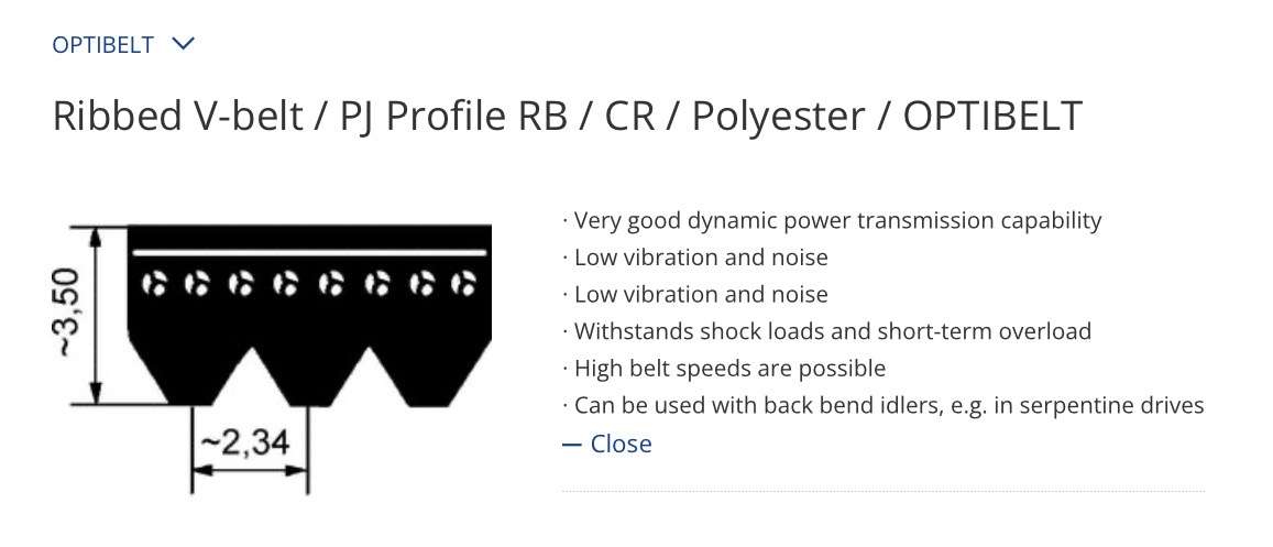

              For general encouragement …
              Edit: __ Have a look at small Poly-V belts … they should suit your application well, and there’s no need to groove the flywheel [just groove the small dynamo motor pulley]

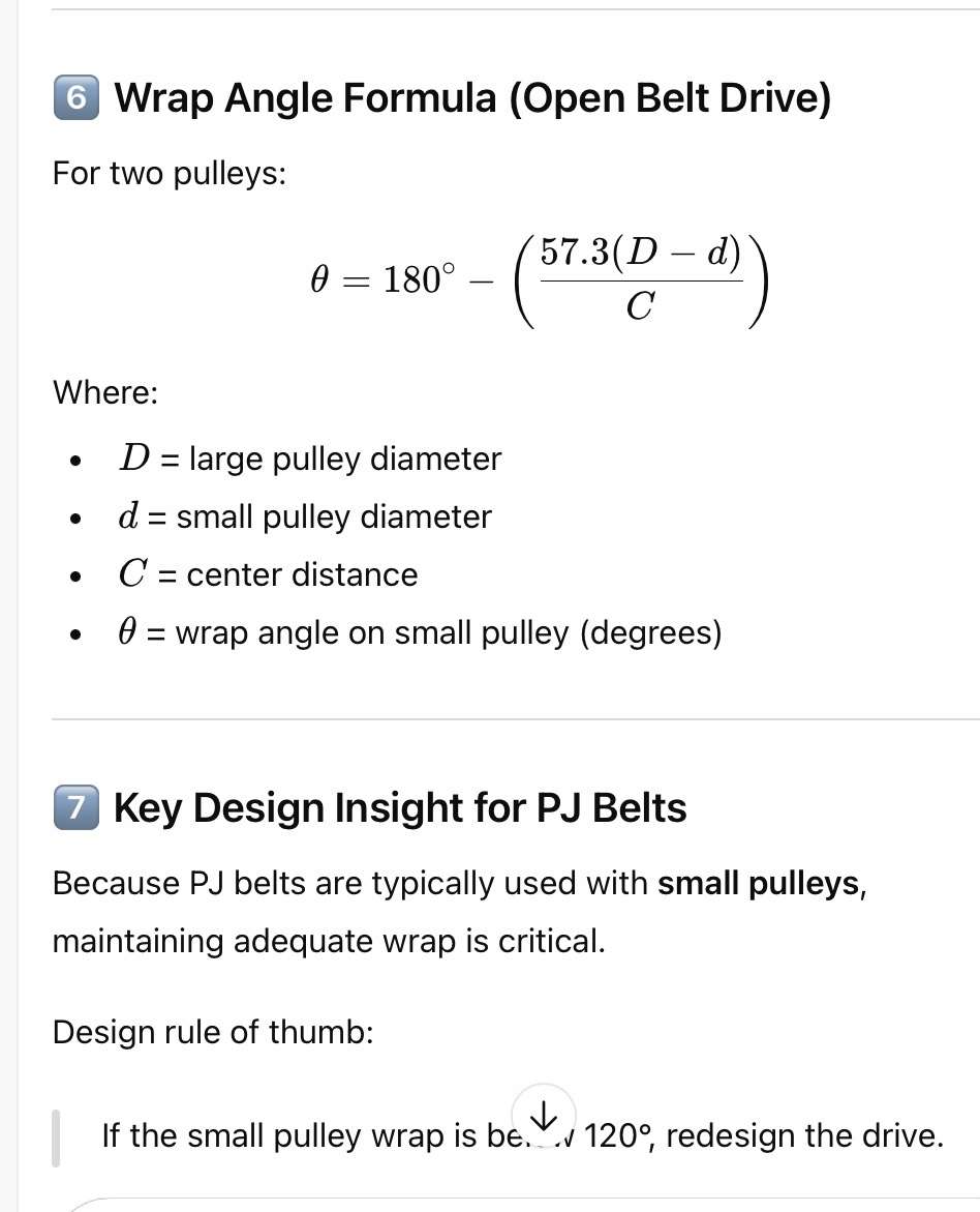

                Just because it’s an interesting problem … I asked ChatGPT for some guidance:
                Here’s the key snippet

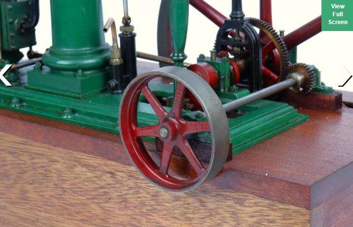

                  The OP mentions both gears and pulleys. I also mentioned the gear size used on the popular ME Beam engine which has a shaft driven at a higher speed than the crankshaft via 4.5:1 gearing. Plenty have built the ME beam and or it’s earlier incarnations and I have never seen a comment that the gears look wrong.
                  This gearing could be used as the first stage then just like the ME Beam which has a pulley on the end of that geared up shaft. The second stage would be from the pulley to the motor/dynamo. The gearing would mean you do not need such a small dia pulley on the motor so will get better belt grip.
                  If you went with a gear head motor then it would even be possible to drive the 2nd shaft pulley 1:1 and have the engine turn over at 30rpm or less depending on the chosen ratio of the gear head motor.
                  me gears
                  Sure it would have been unlikely to see a beam engine generating but it is a reasonable way to hide a motor to drive the engine for display which is something that was not done in full size and the Stuart beam would hardly scale up well if you were to make it with the same proportions at “full size”

                      Dave you have missed the point again. It will be a DUMMY Dynamo with a motor inside use dto drive the beam engine for display.
                      Also full size showmans as I said would run the dynamo at around 750rpm not the 3000 little model ones need. I suspect the OP asked about spee dto at least get the ratios looking right just like getting the gear tooth size to look right. From another forum
                       These dynamos were made by Mather & Platt of Manchester and the one now on the engine is dated 1918. It is a type ‘P8c’ compound wound, 4 pole machine having a continous output of 270 amps at 110 volts at 750 rpm. It weighs 17 cwt. (1904 lbs).

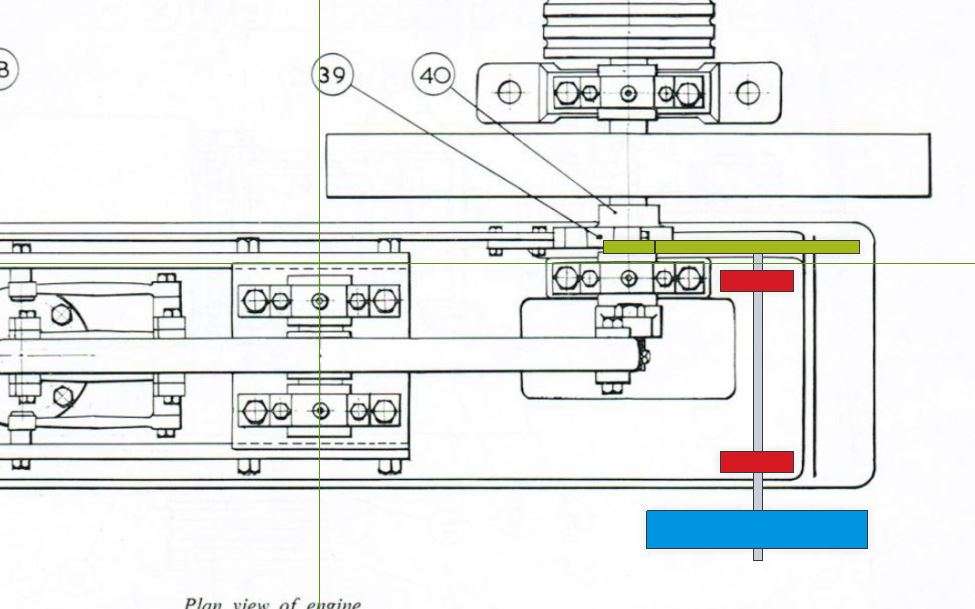

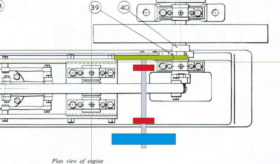

                        I just had a play with the Stuart Beam drawings. It would be possible to make something similar to the ME Beam’s gear arrangement.
                        If 30T:120T MOD 0.5 gears were used which are readily available for not much money then it could fit either side of the crankshaft.
                        A slightly modified eccentric with a second spigot to mount the gear on would be easy enough to do. Skim a bit off the protruding bearing on that side and you only need move the eccentric & rod out 1/8″ which would just need a simple spacer on the weigh shaft at the other end to get the rod line straight
                        Make two pedestalls, a shaft and a pully in the region of 65mm diameter and then flat belt that to the gear head motor hidden in a dummy dynamo casing.
                        Or you could slap another large gear on the end of the shaft instead of a pulley as was found on beam engines used for the likes of cane crushing

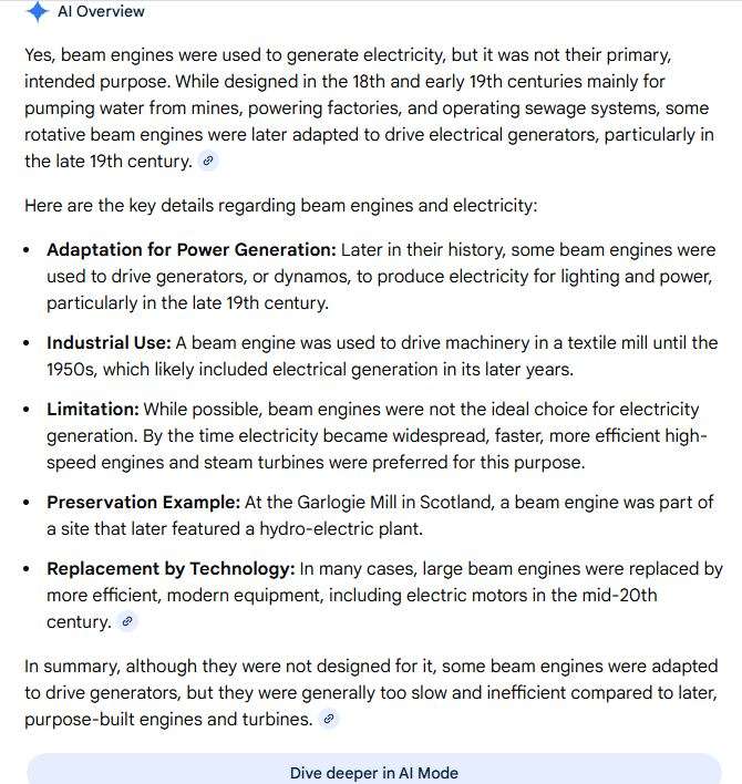

                                AI if you want to believe it also suggests that is was done. Much as Pete suggests.
                                ai beam
                                Also there are some full size beam engines in preservation that get turned over by electric motors as they no longer have a steam supply.

                                  Just as an aside [being disinterested but not uninterested] … Although incorporating gears would be prototypical, and fun, I can see no practical reason for so doing.
                                  The Poly-V arrangement from Motor to Flywheel should be quite sufficient to turn-over the the standard  model.

                                    It seems to me that Pete wants something that looks plausible and in keeping with a model hence the question about gear sizes and speeds/ratios.
                                    Yes a modern belt onto the flywheel would be practical however it would not really look the part.
                                    Beam engines seldom drove directly off the flywheel so a crankshaft mounted pulley to give a reasonable ratio would need to be as big as the flywheel.
                                    Having the 4:1 initial geared ratio is not only prototypical is allows diameters to be kept smaller.
                                    If a similar ratio were used from a pulley on the end of the geared shaft you would only need something like 4:1 again so sensible sizes.
                                    4:1 driving 4:1 gives a total of 16:1 while keeping a bigger wrap angle and sensible sized gears/pulleys. And if you were wanting to replicate real full size ratios then you would be representing an engine running at 48rpm to drive a typical dynamo at 750rpm as mentioned above.

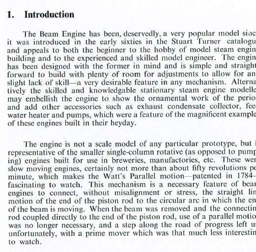

                                            Having nothing better to do whilst I wait for some antibiotics to settle … I thought to ask Chat GPT about the origins of the Stuart model [just to broaden my education]
                                            Question:
                                            Can you identify a likely prototype upon which this miniature was modelled … or was it a freelance design.
                                            Its origin seems to be lost in the mists of time … but YOU search wider and faster than I ever could.
                                            An answer was delivered within two seconds,  and makes interesting reading
                                            #838116
                                              Don’t know about the mists of time but it can be found in Andrew Smith’s book. Took me a similar amount of time to open the page.
                                              intro
                                              #838118
                                                The description from an old Stuart cataloge also says the same.
                                                Good photo to show what I was saying about size, it would not have been a big engine and certainly way to chunky even if just scaled up to the size shown.
