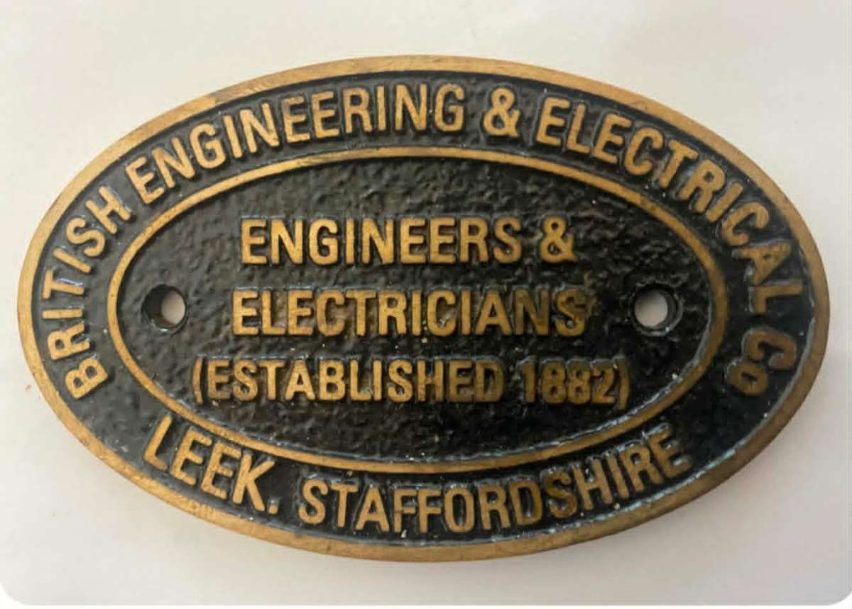

      I was asked by someone on one of the Facebook groups if I could help him to replicate this engine name plate, it is about 80mm wide.

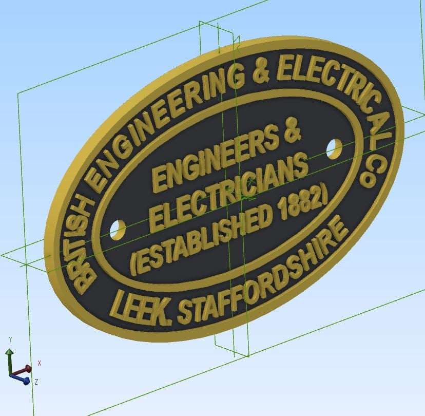

      I soon had it drawn up in Alibre and sent a STEP file off to him

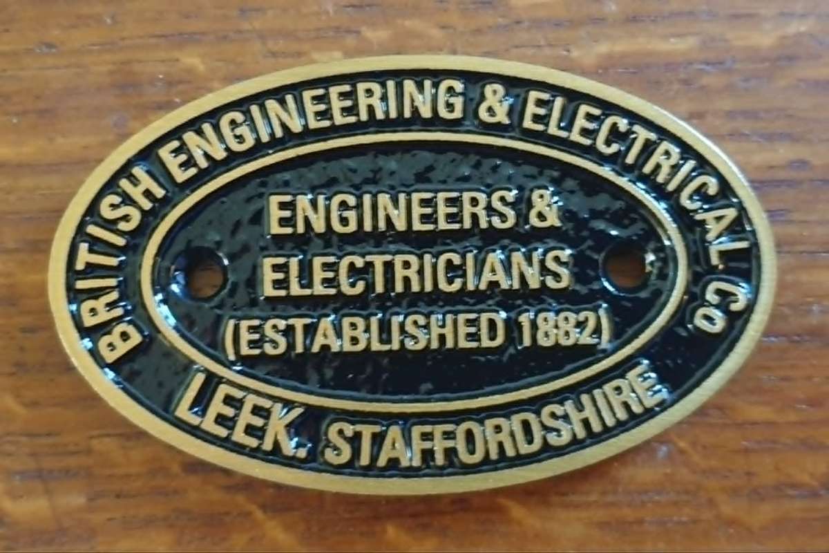

      I just got a photo back of the finished cast and painted plate. Which look to have turned out quite well.

        Excellent result Jason,  proportions of the  cad model spot on.

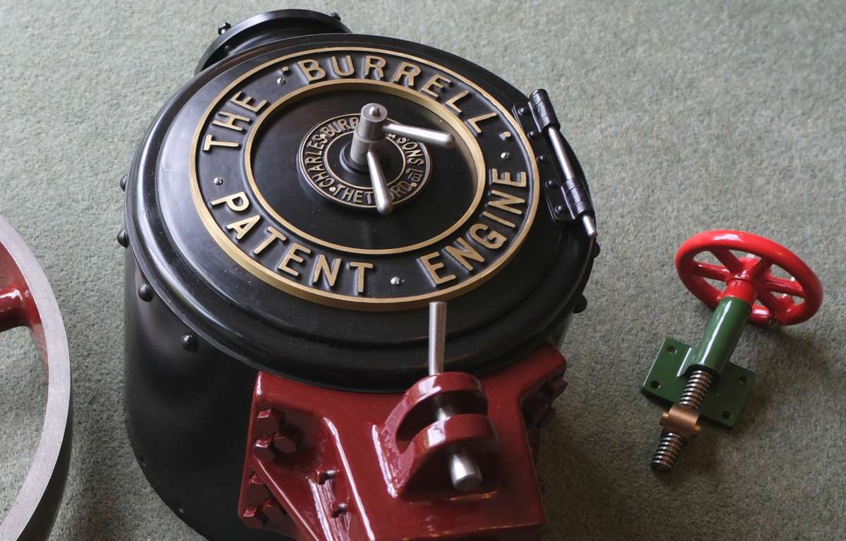

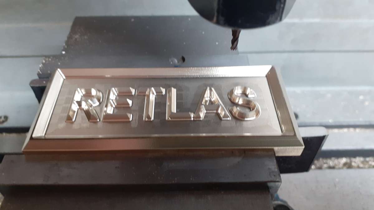

              In the picture the outer ring is a casting, the underside of which is machined to match the curve of the smokebox door:
              Nameplates
              The supplied inner nameplate casting was recycled as it was badly cast and the lettering was incorrect. Instead a brass ring with the lettering was designed to fit into a cast iron turned body. The ring was designed in 3D CAD, placing individual letters as Burrell used a very narrow font which didn’t match any available font in my CAD program. So each letter had to be created specially. The ring was then machined on the CNC mill. Painting in both cases was two coats of etch prime followed by four coats of high temperature black. The sides of the rings were masked but on top everything was covered with paint. After a few weeks to dry 600 and 800 grit wet ‘n’ dry was used to expose the lettering and inner/outer rings.
              The lettering on the outer ring was machined prior to painting, otherwise using wet ‘n’ dry wouldn’t have worked.
              Julie

                  I’m not in any position to know the answer myself, but how viable would it be to create a plaque like that not by casting but by relief engraving it from brass plate using a smallish CNC engraver/mill (i.e. similar to Julie’s approach)?
                  I can see there is texturing on the background, which would presumably complicate things for CNC engraving, but, assuming that kind of texturing were not needed, is doing this kind of job by CNC engraving a viable alternative to casting, or would it be significantly more time-consuming and expensive?
                  #860957

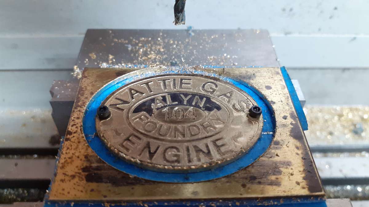

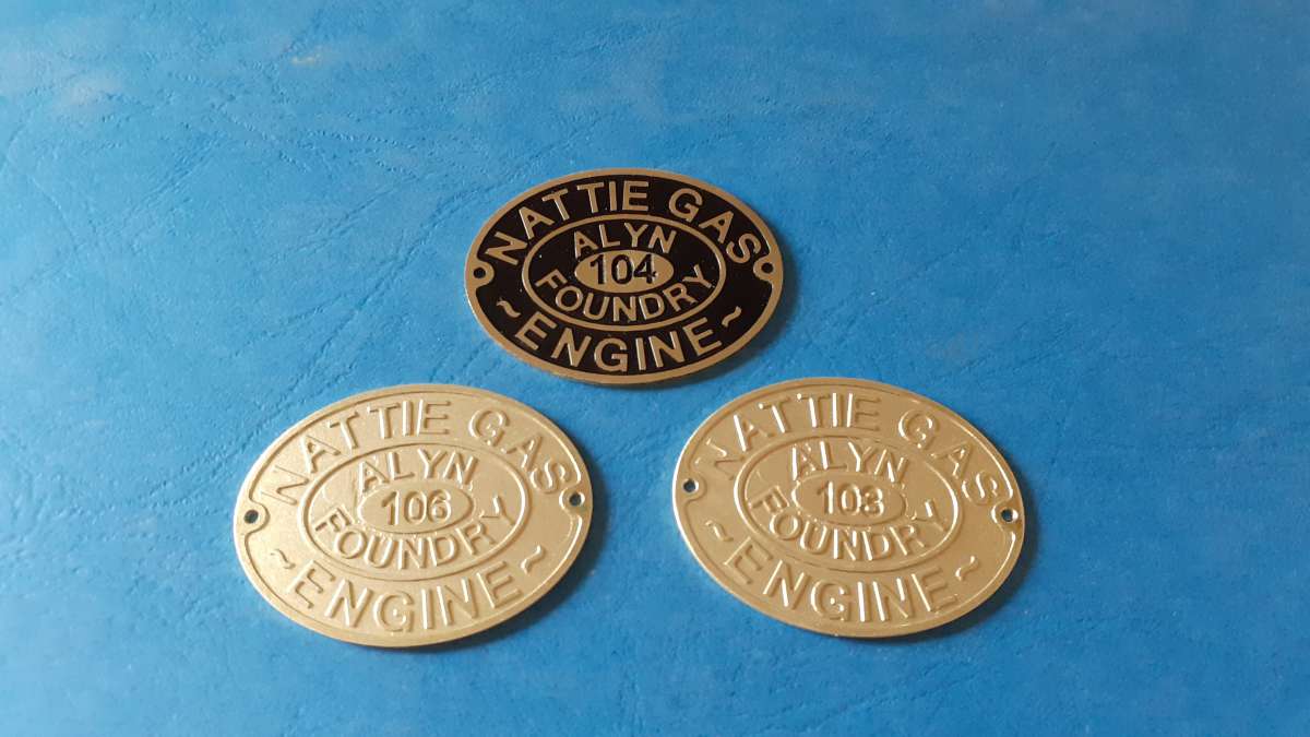

                    Those “Nattie” ones are done on my CNC, ideally you wnat a high speed spindle as th ecutters needed to get in to the inner parts of letters like G and S need to be quite small. Took a long time on mine with a 5000rpm spindle and I think 0.3mm top to the cutter.

                      It looks like it was more than worth the effort with the CNC, Jason, and the same can be said of Julie’s work.

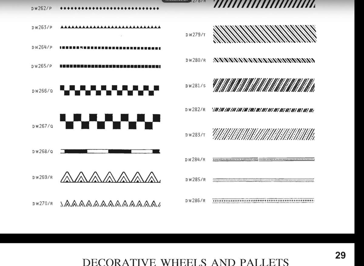

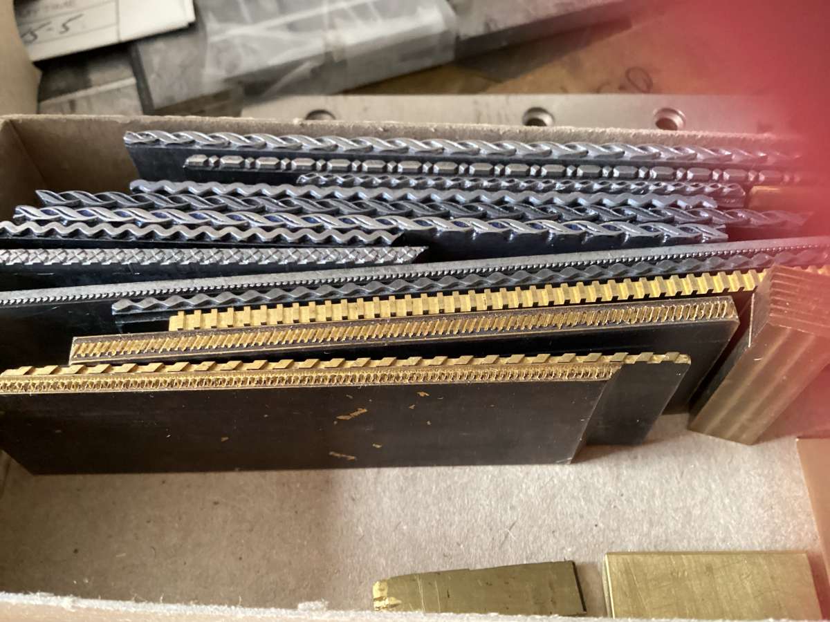

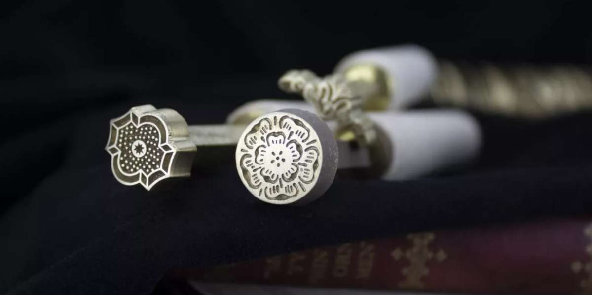

                      I’ve “fond” memories of those 0.3mm sword-like cutters. The most ambitious I’ve been with them was using them on my Proxxon MF70 to engrave the two brass strips in the image that are reproductions of 284/R and 285/R seen in the screenshot taken from a bookbinders’ tool maker’s catalogue. The other brass strips in the pic were easy to machine with a standard 1mm milling cutter.
                      The last picture shows the sorts of tools I’m still hoping one day to be able to produce; I’ve been nibbling round the edges of doing so for longer than I can remember. One day when my round-the-clock care commitments cease,  I hope I will have the chance to attempt this sort of thing in earnest.IMG_2272IMG_2273
