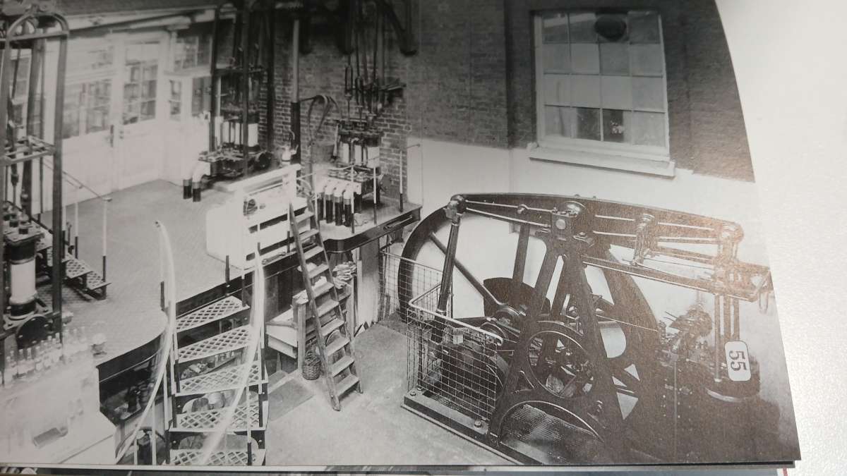

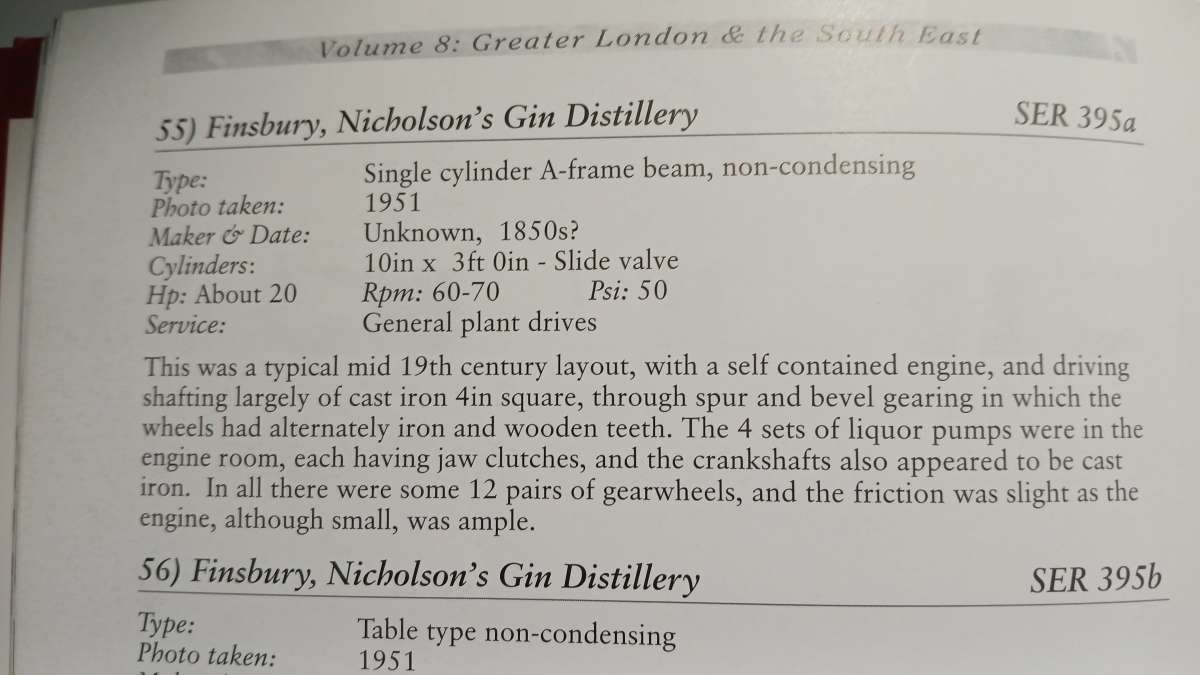

          Yes as I said in the first reply 50rpm would be quite likely for this engine.
          So may people when you say beam engines think of big waterworks pumping engines but they do not consider the smaller ones used in workshops, breweries etc
          Again one only needs look at some of George Watkins books where he gives sizes and speeds of the engines and you can find small beam engines doing 50 or more rpm and they are rotative driving the shafts via gears to work Liquor pumps (on the mezanine)
          20260218_122541
          20260218_122555
