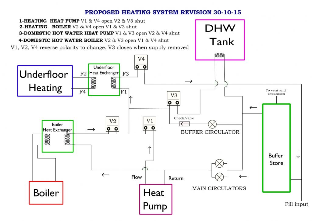

              #568045
              Peter Bell
                @peterbell11509
                I became interested in heat pumps after read ing a book in the early 60's in the technical college library called "Domestic heat pumps" by John F Sumner. Of course at the time nothing was know about them but as the years have chugged on they have become more to the fore and I always thought that some day I would experience a heat pump.
                Our house has underfloor heating with an oil boiler but eventually I got fed up with oil cost so rejigged the heating and installed a 7kw output heat air source pump which worked reasonable well but didnt have enough grunt. Changed this for a 22kw output ASHP (Ebay) and the oil boiler has not been fired up for 6 years now so some sort of a success but I'm sure I'll hear more!
                Not for everyone I'm sure as can be noisy depending on location and gives running cost somewhere near gas. Major disadvantage is it cannot reach the same temps as a normal boiler so not an instant swap for a gas boiler in most cases.
                Peter

                    Peter did you change your hot water tank when you installed the bigger ASHP?
                    Steve
                    Edited By Steve Skelton 1 on 24/10/2021 14:47:56
                    #568073
                    Peter Bell
                      @peterbell11509
                      Yes I changed the cyl Steve. Perhaps better add that we are a new build from 2000 but not terribly good on insulation, wanted better but building regs awkward/dodnt understand at the time. Also have heat recovery ventilation which is excellent.
                      The original system used a large cyl which incorporated a thermal store and heat exchanger for the underfloor but was designed to run UF at 65/70C. Not very good for effienciey but nice and hot as was the house, and used lots of oil. Cyl was showing signs of leaks at the time of the small HP experiment.
                      Now run UF from a heat exchanger direct from HP, output from heat exchanger goes to a dedicated thermal store then pumped back to the HP. This prevents the HP cycling. When the thermal store is up to temp(48C) HP is off and another pump circulates the contents of the thermal store to the UF heat exchanger. At 42C HP it changes over and HP on again and the cycle repeates. Could have just circulated HP to thermal store but this way UF get the benefit of quicker temp rise.
                      I have motorised ball valves to change HP over to heat the cyl as needed, can be automatic but cyl has seperate thermostats to control HP. As most of the time a lot of hot water is not needed run cyl at 35C and have undersink instant elec heaters to boost to 50C which also works for the shower.
                      The UF piping is plastic/rubber as was designed for us, could be better on heat transfer especially through carpets. If I was doing it again would use rads and UF but circulate to rads then onto UF on return from rads. Did this on my sons house(gas fired) and it gives the best of both worlds, UF heating very nice and cosy!
                      Peter

                                #568150
                                Steve Skelton 1
                                  @steveskelton1
                                  Hi Peter,
                                  Thanks for the information. Likewise, we are also a new build, from 2008, but with lots of insulation – 140 mm in walls, 150mm in floors and 200+ in ceilings. We have a lot of windows (D/G) so that is the main heat loss. We also have whole-house ventilation with heat recovery which as you say is excellent – never seen any condensation on windows in any room except bath/shower rooms and then for only a short time.
                                  We have a 500L thermal store with wet solar panels and a wood burner with a back boiler feeding the store. Main heating is an LPG boiler through a coil in the T/S – this is the biggest restriction we have in using a heat pump, the contact surface in the coils is only 1.2m2 which limits the size of heat pump I can strap onto it – probably to about 5kW. Pipework to this coil is 22mm and is about 28m from the boiler (and proposed ASHP site). I do not really want to change the store at this stage.
                                  Feeding new ASHP feed pipework to the store would be very difficult due to the UFH in all rooms and therefore lifting floors is not an option so I was looking to use the same pipework for the ASHP as the boiler uses. I would do this with interlocked motorised valves to isolate each system and use a control system to send appropriate signals to the LPG boiler, ASHP and valves.
                                  Our house thermal loss is between 225 and 275 W/K so in theory, a 5kW pump should be adequate for all but the coldest of weather. I would like to keep the LPG boiler as it can be run in a combi mode for hot water if the store temperature is not high enough ( ie when using an ASHP). We like to run the wood burner in the evening when we are in the house so again this helps with heating the store.
                                  Our annual gas heating bills on bottled LPG are less than £500/yr although that does not take into account the wood that we burn which is free (we have a lot of trees).
                                  I am very interested in the fact that you still get a high efficiency from the ASHP when it turns into a block of ice – I was under the impression that ice acted as a good insulator to prevent heat transfer. It has been this one issue that has prevented me from experimenting with an ASHP.
                                  Where in the country are you? We are in the South West.
                                  Thanks, Steve
                                  #568220
                                  Peter Bell
                                    @peterbell11509
                                    Hi Steve,
                                    I did very similar to what you are suggesting (see pic) so I retained the use of the original boiler if I wanted it, in practice never used it for ages. Sometime think it would be useful to do a costing of each system but l'd rather do something more interesting….
                                    Think our original themal store was around 300l but replaced this with a 90l thermal store and presurised SS cyl which I think is 150l. I hoped the SS cyl would be less prone to leak /corrode and seems fine up to now.
                                    Not sure what the COP is when its in block of ice mode but the parameters for a defrost can be set, think I've got mine set for the min of 1/2hr continous running also taking into account the condensor temp.
                                    Being a "budget" ASHP its suffered from spade connectrors overheating/burning, replaced with eyelets onto the existing studs and capacitors failing. I've replaced the start and run caps with decent run polyester ones. The two schroll compressors are Toshiba. It also has 2 fans pulling air through the condensor. Earlier this year I noticed one fan seemed slightly slower than the other so removed panels etc. When I put my Smiths tacho onto the top fan discovered it was doing 500rpm and when pushed the tacho onto the bottom fan it slowed and stopped-mmm! More digging revealed that the fans are 960rpm and the caps had gone from 4uf to 1.5uf. Changed these and its producing a howling gale once again which should improve the low temp performance and perhaps help keep the condensor freeer from ice. Not sure how long its been running at the lower effiency though.
                                    I still have the smaller ASHP sitting in the garage Steve but unfortunatly I'm in Staffordshire else you could have had look at it all and even borowed the smaller ASHP to try/play.
                                    Peter

                                      #568308
                                      Steve Skelton 1
                                        @steveskelton1
                                        Thanks for that Peter and the offer of borrowing your old unit. I am thinking that a split system, which seems to operate at a higher output temperature, maybe my best approach.
                                        I am in no hurry to jump into buying something yet as it is mostly an academic study as my heating costs are not excessive, even with bottled gas! However, I would like to do my bit to reduce my carbon footprint.
                                        My concern has always been that the efficiencies are never what the manufacturers quote, I have tried to discuss this with them but they refuse to answer my questions – I have approached two of the major manufacturers with technical departments in the UK and they have not got back to me despite repeated requests. They just quote the DIN tests as this is all they have to quote on their technical specs. The trouble is the values quoted are for laboratory conditions with much lower humidity values than we experience here in the South West and I am still unable to determine whether the water removed from the test air is replaced as it is condensed. If it is not then the efficiency of the unit will rise as the test progresses.
                                        The thermal conductivity of ice at 0 deg C is about 2 W/mK compared with a heat exchanger material conductivity of about 385 in the case of copper and 205 for ally. So any build-up of ice (which will occur at air temperatures of less than 10 C) will have a seriously detrimental effect on the ability to remove useful heat from the air.
                                        Maybe this has been taken into account in the design of these ASHPs, I do not know.
                                        Anyway, I will watch what happens in the heating industry with interest.
                                        Steve
