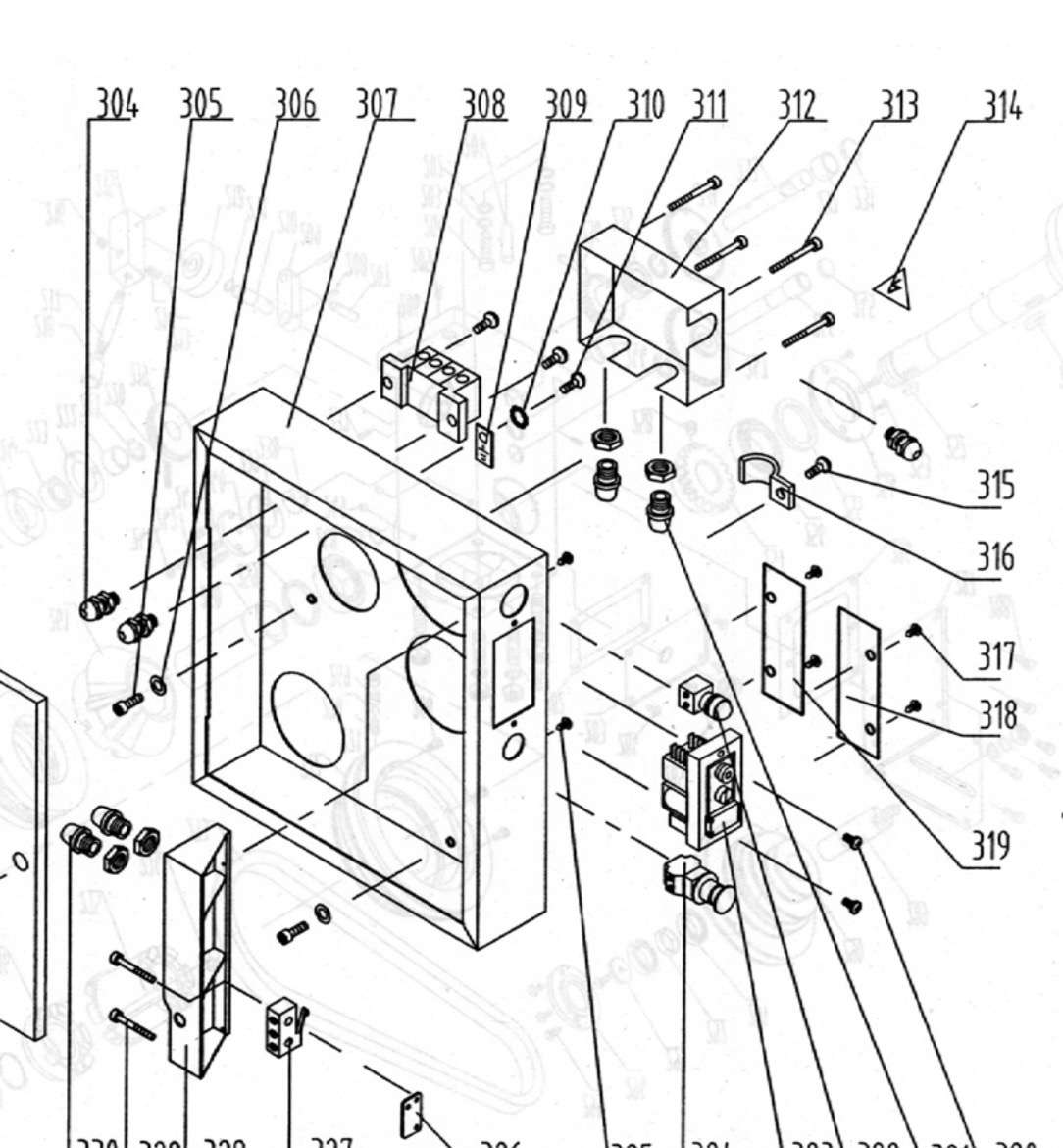

      Hi I’m derrick and, having now retired, want to resume my hobby of model making and hobby engineering. To this end I’ve just taken possession of a Chester MF42B lathe from a relative who has recently passed away.
      But I need to move it to my workshop.
      It weighs 180kg, so to move it I’ve removed the tail stock, tool post and carriage, chuck and motor. But I need to remove the milling tool.
      Any advice on removing the milling tool please. I cannot find any bolts that clearly locate it. And if I do does it just slide up?
      Where it is currently located is in a cramped shed with no room for a beam or engine hoist. Thanks

      Adrian R2
        @adrianr2
        Is it this one? Looks like head is on a big screw thread, wind it up a bit and look for bolts underneath?

          This is essentially the same as a Clarke CL500M.
          You can download a manual here https://www.clarkeservice.co.uk/manuals/metal_lathes/CL430_Metal_Lathe_REV_3.pdf
          That link may trigger a security warning, but it’s just and expired security certificate and the PDF is clean.
          The square slab on top of the headstock (somewhat thinner on the Clarke version) should be held in place by four cap screws (see page 10).

              #853326
              bowmandj1953
                @bowmandj1953
                thanks neil
                <p style=”text-align: left;”>the four screws released the flat plate that fixed mill head pillar, but I couldn’t remove the plate  it was loose but would not come off. in the end I found a screw that held the protector box for the pulley system was threaded into it (305 on picture)  The screw was located behind the dog clutch for the mill head drive.  once I removed that the plate could come off and I could remove the mill head drive transfer shaft</p>
                thanks again
