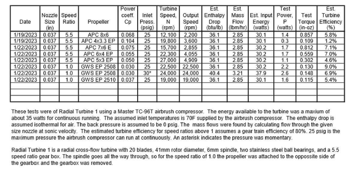

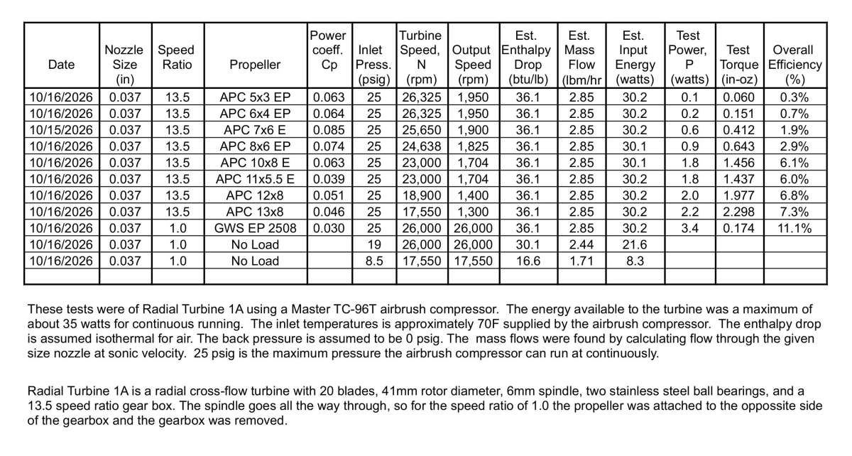

                    I purchased the turbine and gearbox mentioned in the last post that I call Radial Turbine 1A since it is identical to Radial Turbine 1 except for having a two stage gearbox instead of a single stage gearbox. The following spreadsheet shows the performance of Radial Turbine 1. All the test data recorded for this turbine was done without any changes to the turbine or gearbox so it was exactly like delivered. I planned to make similar tests with Radial Turbine 1A and compare the performance with Radial Turbine 1. I ran Radial Turbine 1A off and on for a total time of about an hour to ensure the gears and ball bearings were fully bedded in. I used an APC 8×6 EP propeller for a load during these runs and added the test results in the second spreadsheet. I was disappointed in the very low power I got with the APC 8×6 EP propeller so I tried a few smaller propellers but got about the same results. It only requires removing three screws to take off the gearbox as shown in the following photo. I ran a test with a GWS EP 2508 propeller with the gearbox removed and added it to the second spreadsheet.
                    Comparing the performance of Radial Turbine 1 and Radial Turbine 1A shows that Radial Turbine 1A reached a speed of 23,000 rpm with a pressure of 25 psig and Radial Turbine 1 reached a speed of 22,500 at this same pressure. This shows that the turbine portion of Radial Turbine 1A is performing slightly better than the turbine portion of Radial Turbine 1. Comparing the performance of these turbines including the gearboxes and with the APC 8×6 EP propeller, Radial Turbine 1 did much better than Radial Turbine 1A. The extra friction of the gears and bushings in the second stage of the gearbox appears to outweigh any benefit from the extra speed reduction. I will see if I can find a way to improve the performance of the two stage gearbox.

                        The larger propellers arrived and I did a series of tests of Radial Turbine 1A at the maximum pressure of 25 psig. As expected, the performance with the larger propellers was much better than with the small propellers using the two stage gearbox. This is due to the large windage losses of Radial Turbine 1A at higher speeds. The following spreadsheet shows the tests I ran yesterday and I included two tests with the gearbox removed and no load. These two tests were to illustrate how large the rotational losses are with this turbine. The test at 26,000 rpm was the top turbine speed obtained with this turbine and without a gearbox at the maximum pressure of 25 psig. The test at this speed without a load showed that approximately 72% of the available power was required just to run at this speed without any power output. Running at the turbine speed of 17,550 rpm that got the maximum output power with the gearbox, 27% of the available power was required to run without a load and without the gearbox. 45% more of the maximum input power was available to turn the load at the lower speed.
                        I also show the spreadsheet with the tests of Radial Turbine 1 with the single reduction gearbox for comparison.

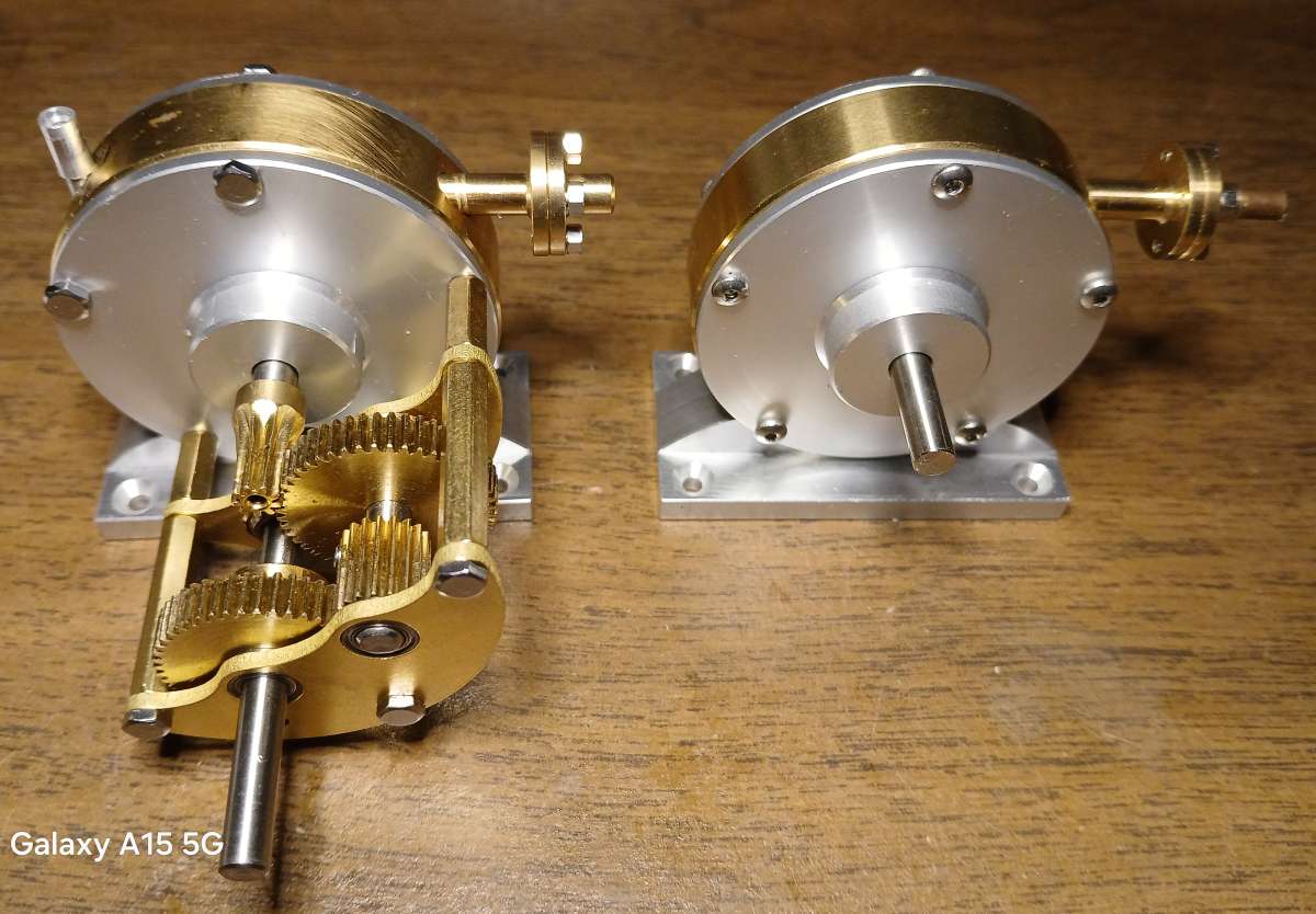

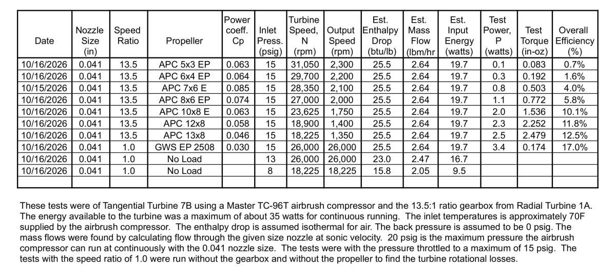

                          I decided to remove the two stage 13.5:1 ratio gearbox from Radial Turbine 1A and install it on Tangential Turbine 7B as shown in the following photo. I call this assembly Tangential Turbine 7C. Tangential Turbine 7A gave me the best performance of any of the rotors I tried in the radial housing. Tangential Turbine 7B is identical to Tangential Turbine 7A except for the ball bearings. Tangential Turbine 7A used ball bearings with shields that required periodic oiling and Tangential Turbine 7B replaced these ball bearings with sealed and grease filled ball bearings that don’t require any maintenance. The extra drag of the grease lowered the performance but is the type of ball bearing used in Radial Turbine 1A so it makes a fairer comparison. The following spreadsheets show the performance of Tangential Turbine 7C with that of Radial Turbine 1A. The maximum efficiency of Radial Turbine 1A running without the gearbox was 11.1% compared with the 17% efficiency of Tangential Turbine 7B running without the gearbox. The maximum efficiency of Radial Turbine 1A running with the gearbox was 7.3% compared with the 12.5% efficiency of Tangential Turbine 7B running with the gearbox.

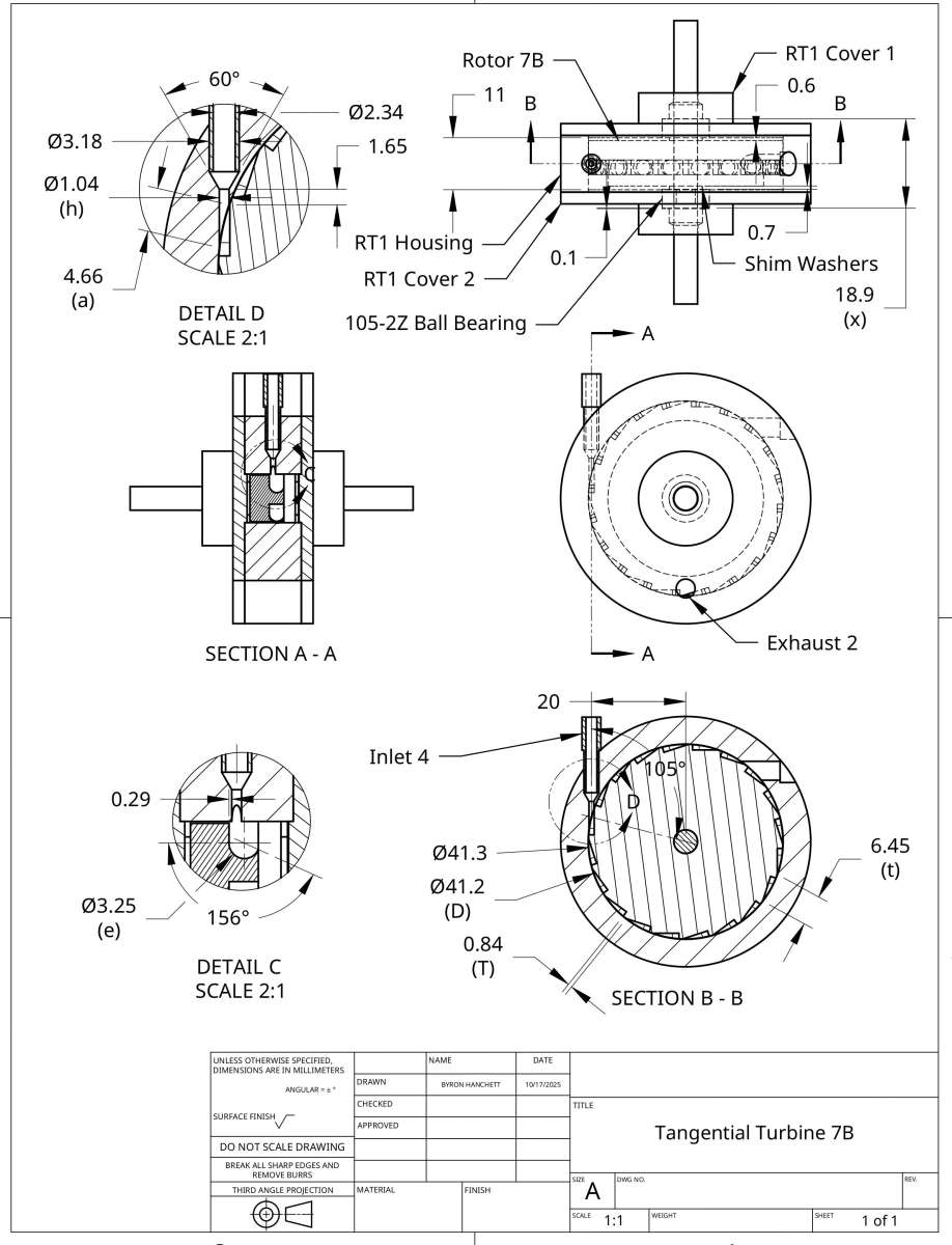

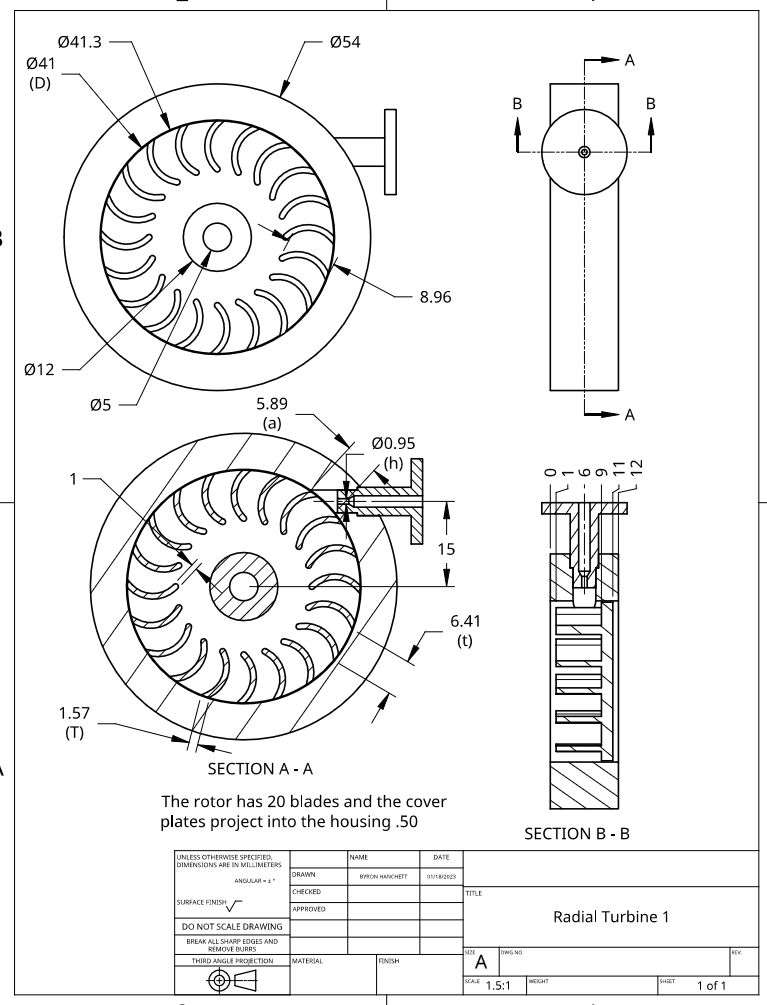

                          I will show the drawings for Radial Turbine 1A and Tangential Turbine 7B in the next post.

                            The following drawings are the ones  I said would be shown in this post.
                            RT1
