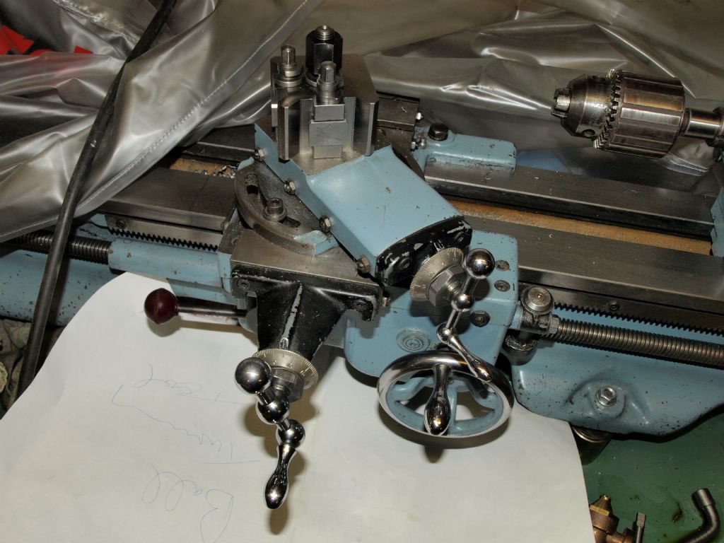

      I'm in the process of starting to restore an old Myford ML7. I've stripped the tailstock and cleaned all the parts in paraffin, now I want to try and make the levers, handwheels etc look nice and shinny like new.
      I also want to polish up the slides and other bits to look new.
      Any advice would be gratefully appreciated.

                    By all means polish the handwheels etc., but slides should not be polished. A slight surface irregulaity is needed to retain lubricant. Two flat, polished surfaces will tend to stick together. I would just use wire wool with a bit of oil to remove the surface rust.

                        The handwheels were of course chrome plated originally and the levers chemically blacked.

                            Just a thought but if you are going to the trouble to restore your machine to the level you sugest, then why not replate the hand wheels and associated parts. I bought a set of new hand wheels for my Bridgeport as they were damaged when I got the machine. When the new ones arrived they were untreated steel. With the moisture in the air and on your hands, I expected to all these parts to corrode in no time. So I had everything bright nickel plated. The result is lovely and here we are two years later and they are still good as new. It's not very expensive and most chrome platers will offer nickel as an option. The other plus with nickel over chrome is that the plating gets into all the corners which can be a problem sometime with chrome.

                              Decent quality chrome plating on steel always started with copper plating, then nickel, then chrome. It will then last a lifetime.

                                Agree with Russell, this plating is 40+ years old
                                K
                                ML7 Carriage
