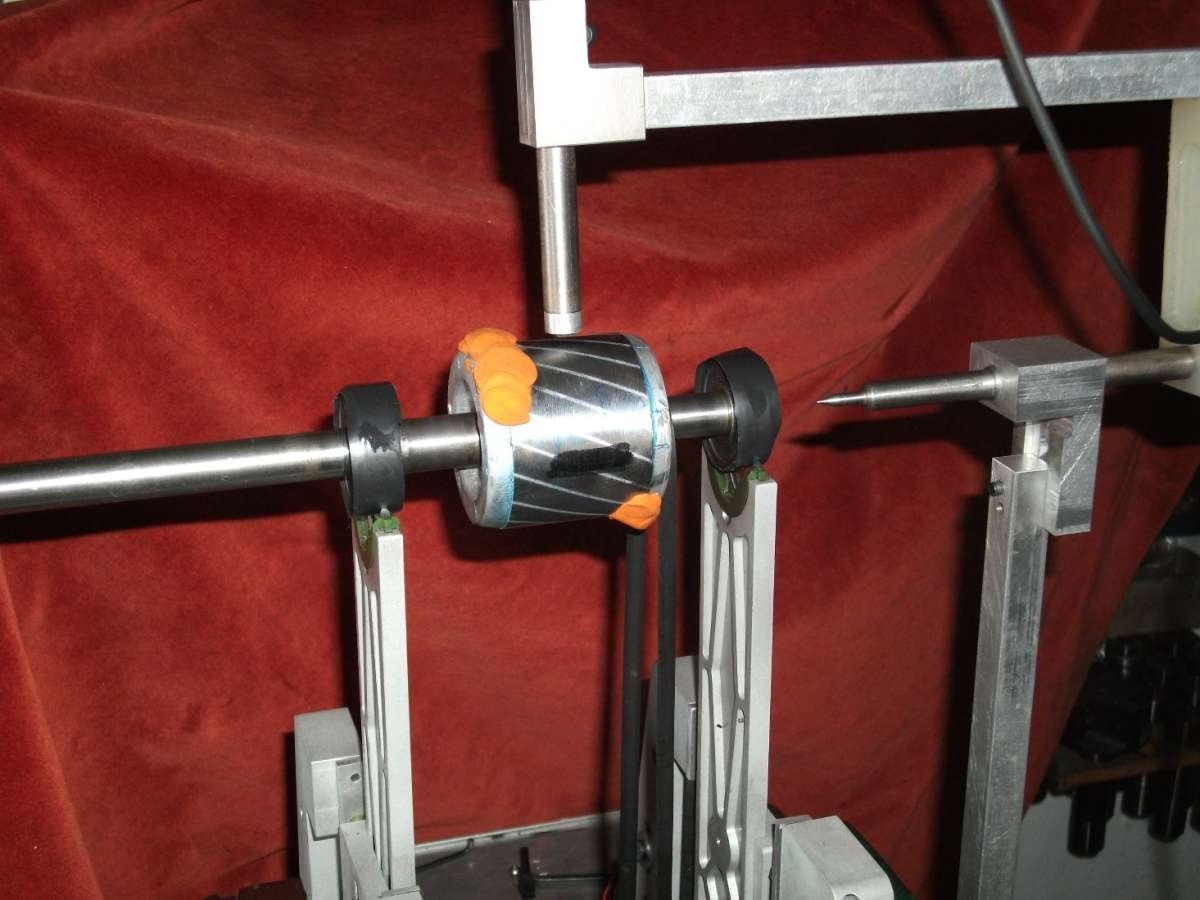

            The photo here shows the rotor assembly from a coolant pump,as you
            can see this is is on a balancing machine,the two plasticene weights are
            nearly 180 deg apart but of different sizes.
            If you are unlucky enough to have a rotor where the unbalance masses
            are 180 deg apart and of similar weight testing on knife edges will show
            as in balance but running at speed will vibrate .

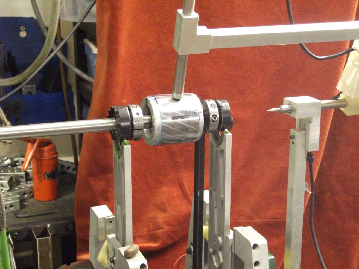

            The problem in how to correct this without grinding away at the rotor
            drum is seen here in the next photo,two split collars are clamped
            around the shaft to allow material to be removed to balance the
            rotor.As you can see they are as far away from the rotor as possible.
            In this example when balanced the speed of the motor increased
            by nearly 100 rpm.
            I have had a bench grinder that i bought 40+ years ago that also
            vibrated badly until i was able to balance it properly using the same
            method as above.
            The downside of this you need a dynamic balancer or as in my case
            make your own.

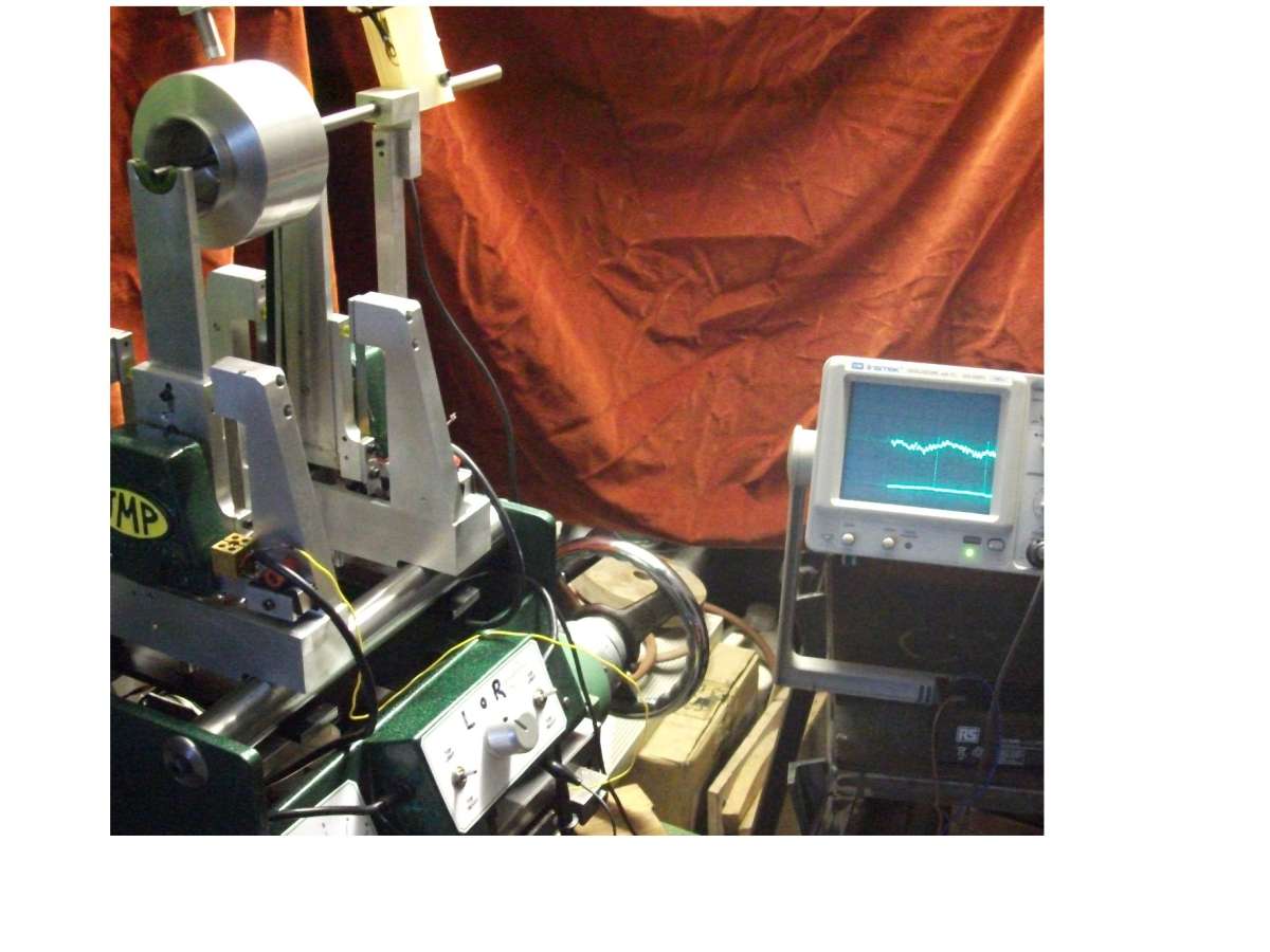

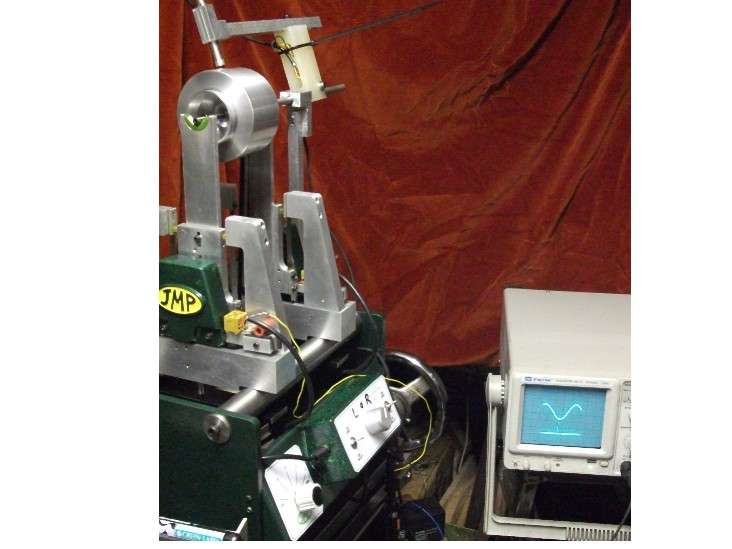

              Hi
              Had some problems with previous post photo’s
              just some examples of the indication of balance
              on scope screen .
              As before this rotor from a centrifuge before and
              after balancing.
              The first photo
              there is a clear imbalance showing and the reference
              pulse at the bottom of the screen.
              The second photo
              The trace is not so clear although you can still see a rotational
              cycle between the the reference pulse at the
              bottom.
              When the signal is so small the trace is corrupted by small
              mechanical vibrations within the balancer.
              At this point the imbalance is just a few millgrams.

              Refering back to my previous post the example
              shown in the first photo shows how much imbalance
              there was on that rotor.
                I’m not sure I understand this. If the unbalance mases are 180 degree apart and of similar weight then why there are going to be vibrations? The rotor doesn’t have to be homogenous.
                What sensor you used? It looks like a pickup coil. Is it sensitive enough or you had to amplify it?

                  This video explains the types of unbalance and the causes it is worth
                  watching all through at around 5 min 30 sec describes the situation
                  you may have.
                  If you have just a disc to balance the knife edge method works well,
                  when the object in question has a length that is equal to the diameter
                  it is then really considered to be a drum and can have this dynamic
                  imbalance.

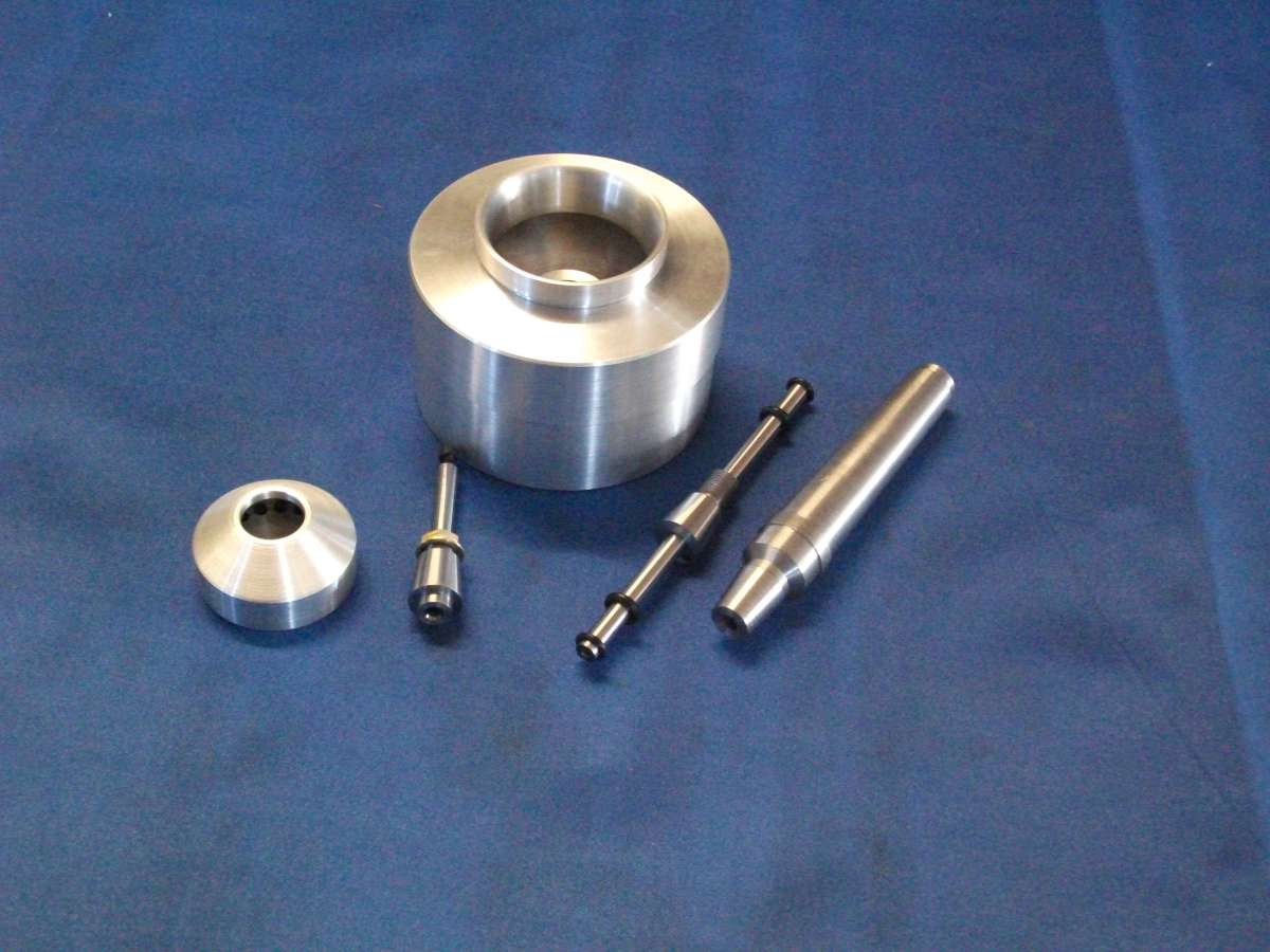

                  The downside of having a balancer like this is that to make
                  the balancing spindles for some of the items such as the rotor drum
                  seen earlier , you need to have a cylindrical grinder
                  as they are hardened and cannot be turned as seen here the
                  balancing spindle for the centrifuge rotor the one with o rings on.
                  However the the rotor seen in the first post was balanced in its
                  own bearings which works well enough but produces a more
                  noisy signal.
