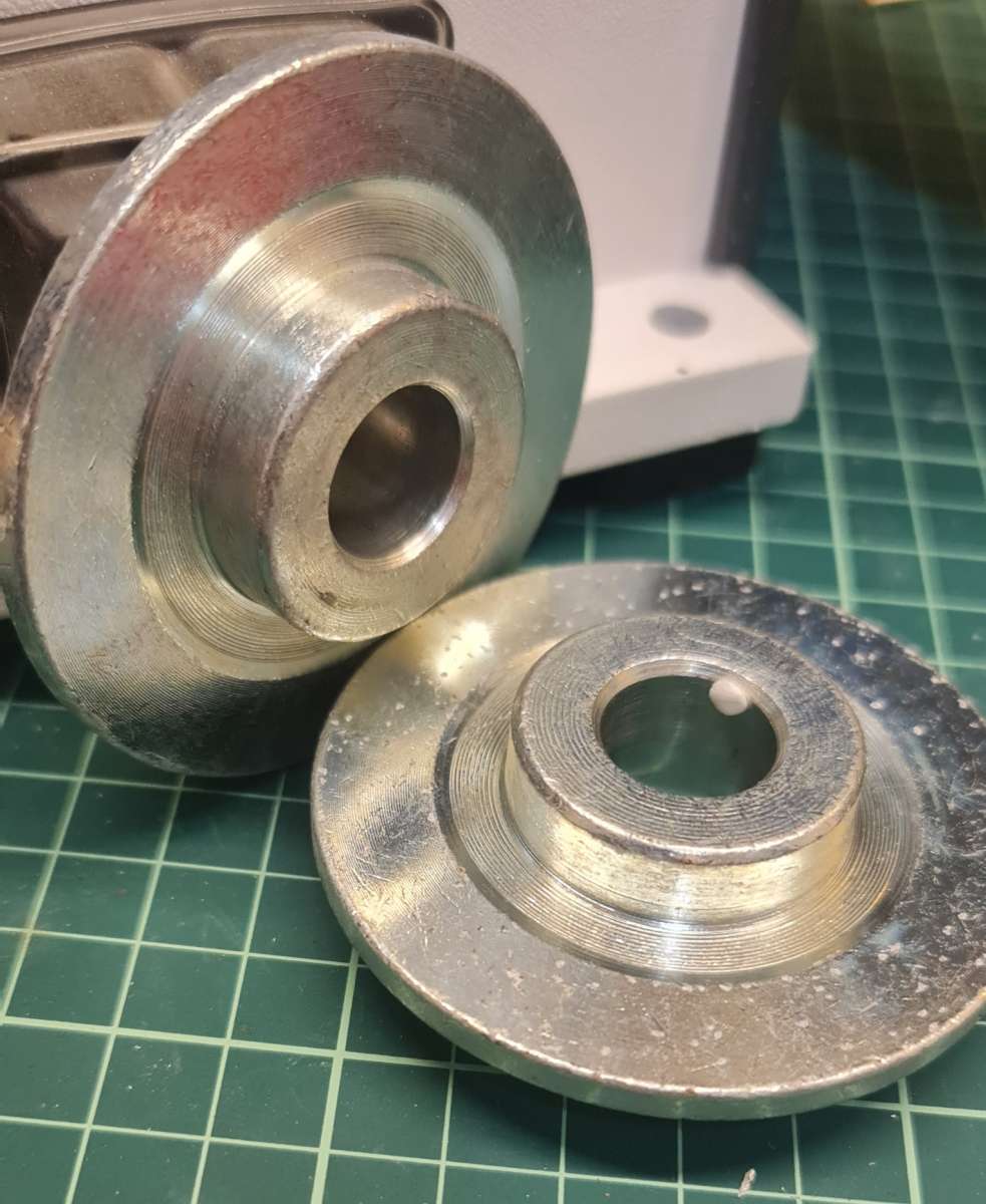

      I bought an Optimum GU18 bench grinder and I complained a lot about it here. I was thinking about buying another type. But how to find a good model? I was particular disappointed when I saw the stamped flanges from a Makita GB602. I almost ordered that model. At least my grinder has a more solid flange:
      flanges
      Next on my list was a more expensive Rikon. But I saw a video where a brand new one had significant vibrations before dressing the wheels. I started to believe that there is no grinder, at least not in my price range, which works fine out of the box. If you think otherwise, I would like to know your opinions about this.
      So, I decided to try to fix mine. Here is what I did so far:

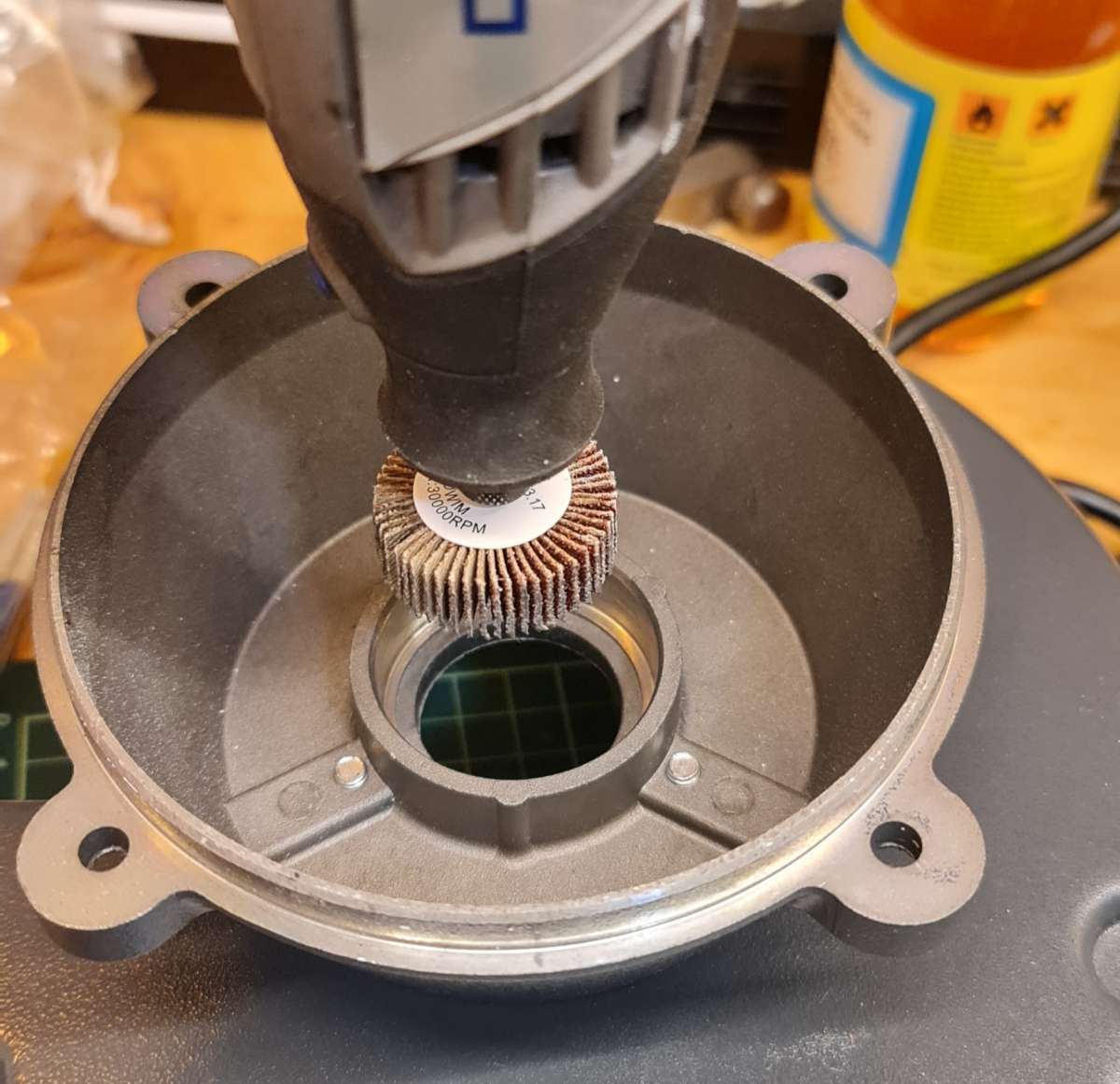

      – I enlarged a little the bearings housing so there is an axial play. Now the wave washer can do its job.

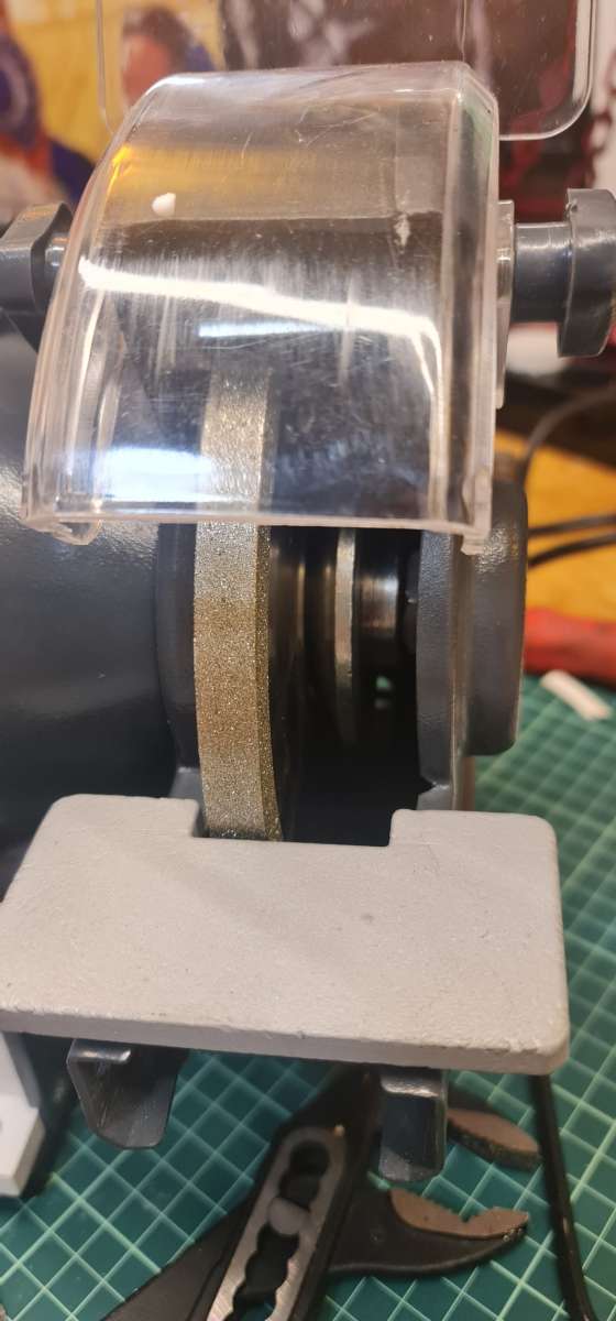

      – I removed the original wheels and mounted only one 150x10mm electroplated diamond wheel. It fits with no play on one flange. Since it is too narrow I mounted the second flange in reverse.
      diamond
      – there is an annoying vibration. I tried to grind a 10×10 HSS blank. It worked reasonably wheel, it didn’t jump when touching the wheel. But the vibrations are noisy.
      Next I’m thinking to remove the side cover and to add a diamond cup wheel. On that wheel I could make some threaded holes and by trial and error maybe I can find the position where a screw will balance the whole assembly.
      If this works then it means there is a cure. I’ll add two more diamond wheels on the other end and repeat the process.

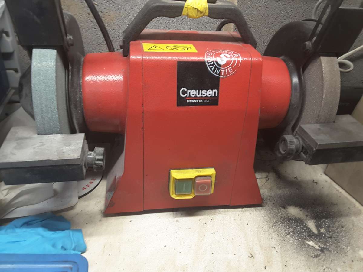

          I bought a Cruesen grinder and other than having to reinforcing the tool rest I have not had to do any work on it since I bought it four years ago. I have seen grinders with very poor wheel mounts which were either loose fit on the shaft with insufficient location as they were not wide enough to stop a grinding wheel from wobbling sideways as well as circular loose fit on the shaft and in the grinding wheel.
          20190602_185707
          The wheel holding mounts should have a band on the grip face which is proportionate to the grinding wheel and there should be a card washer to even out any small deviations in the side of the wheel.
          I would never use diamond grinding wheels for grinding any steel parts as steel reacts with diamond particles at speed and temperature and don’t work very well.  I always use white aloxite for steel and green grit for tungsten carbide. If the inner wheel supports do not run true it can cause the armature to oscillate side to side quite noisily. I also use a diamond dressing tool to dress the outside of the wheel which also stops bounce if not true.
                How are the flanges of that Creusen grinder?

                If you know a grinder that has machined flanges, 20 or 32mm arbor, cost bellow 300 euro and is guaranteed to run silent and have a balanced rotor I’ll order it now.

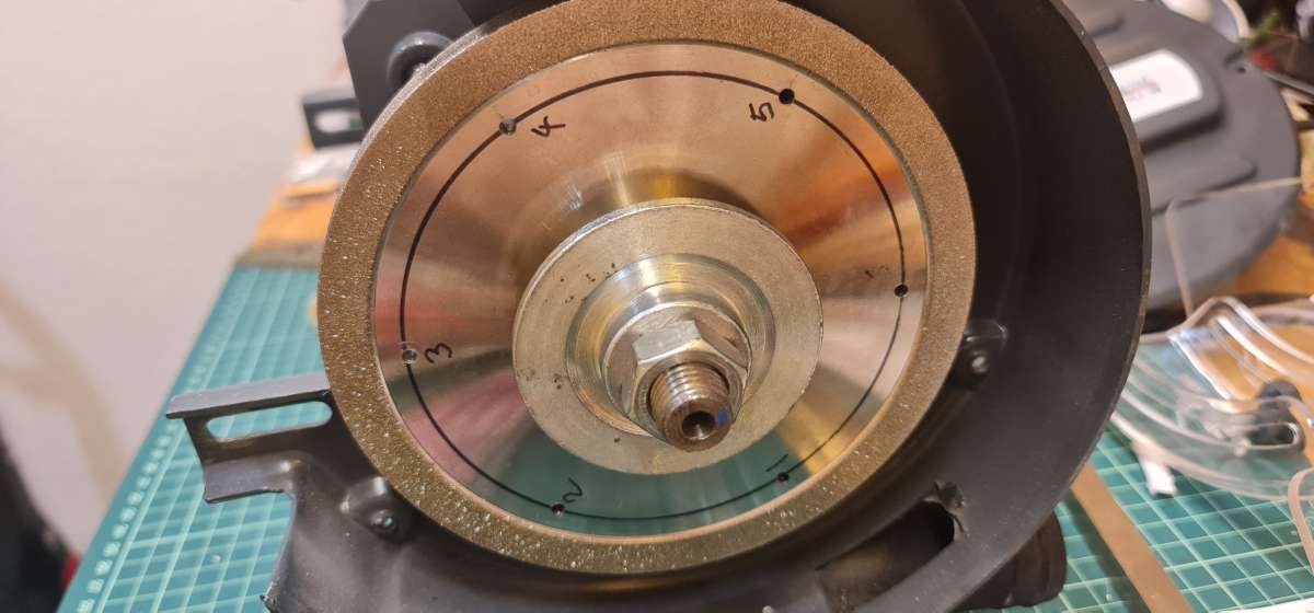

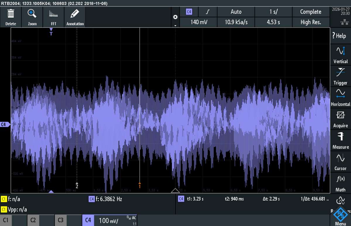

                        I made 6 holes in the diamond wheel to add some weights to try to balance the rotor.
                        20260127_185109
                        A small weight (an M3 screw + a large washer + nut) on hole number 1 produce a slight improvement. Adding weights on any other position increases the vibrations.

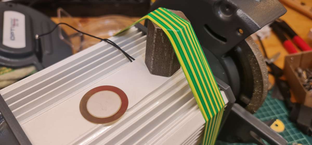

                        I added a piezoelectric disc on the grinder to have some visual indication of the magnitude of the vibrations. In this was is easier to find the right spot. Fortunately such a buzzer output is few hundred millivolts and it is easy to spot on the scope without any amplification.
                        20260127_185057

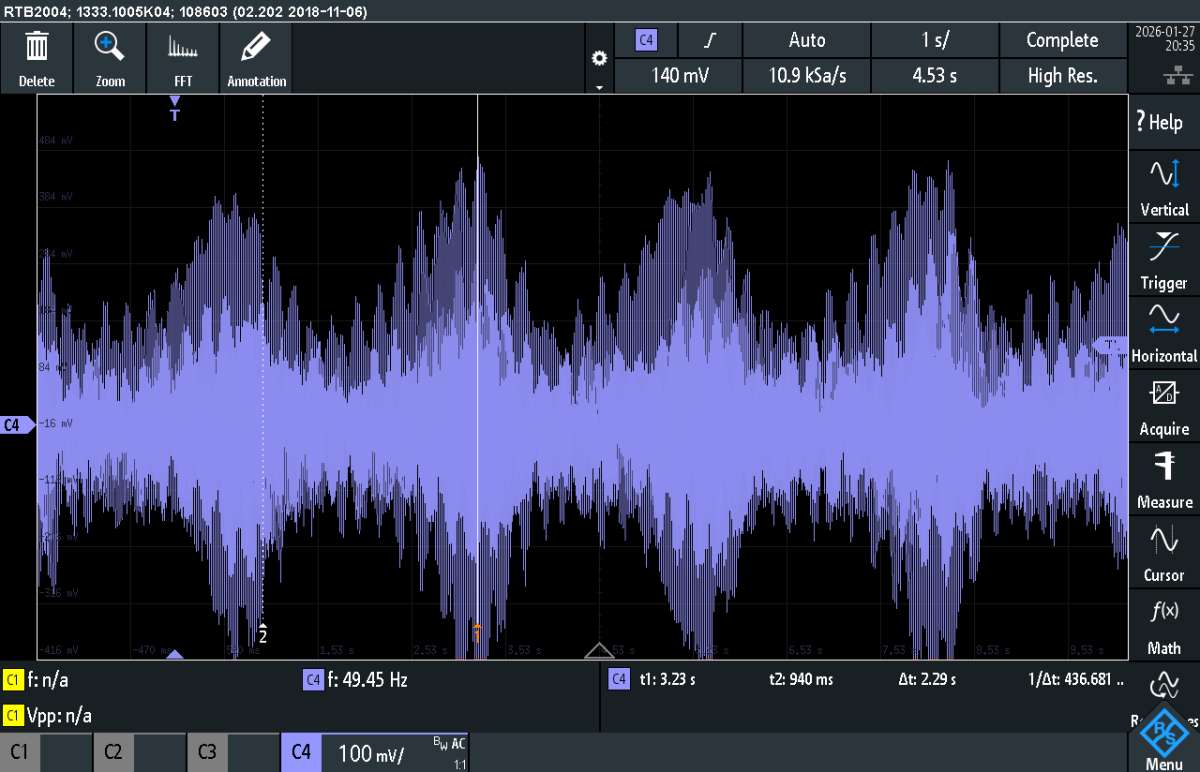

                        This is the sensor output without any weight:
                        SCR02
                        There is an strong oscillation with a period of ~2.5s. I can hear it very well. Adding a weight on hole 1 cures a little this oscillation but the average vibrations are higher:
                        SCR01
                        As I suspected I’m afraid is not possible to balance the rotor by adding weights 10cm away from it. I need to find a way to add a screw directly on the rotor.

                          Regarding the pressed steel side plates – I recently had to swap a wheel out on one of my bench grinders. When I fitted the new wheel, with the proper blotters it wobbled visibly. I put the cheek plates on my surface grinder and ground the centre a tiny bit until there was a flat land showingall around the hole, put it all back together and the wheel ran lovely and true.

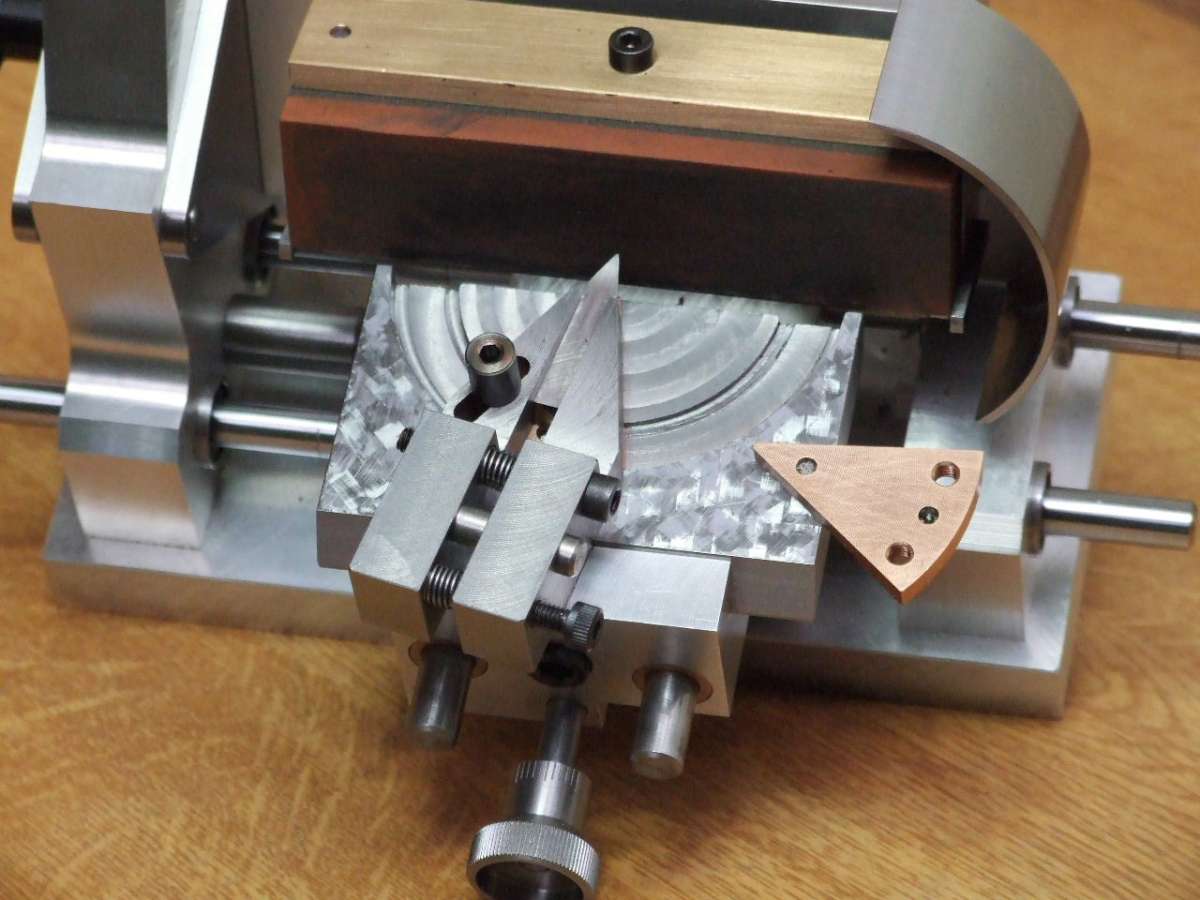

                                              In my experience a “Honed” edge will outlast a ground edge on a tool. It will also improve the finish on the work.

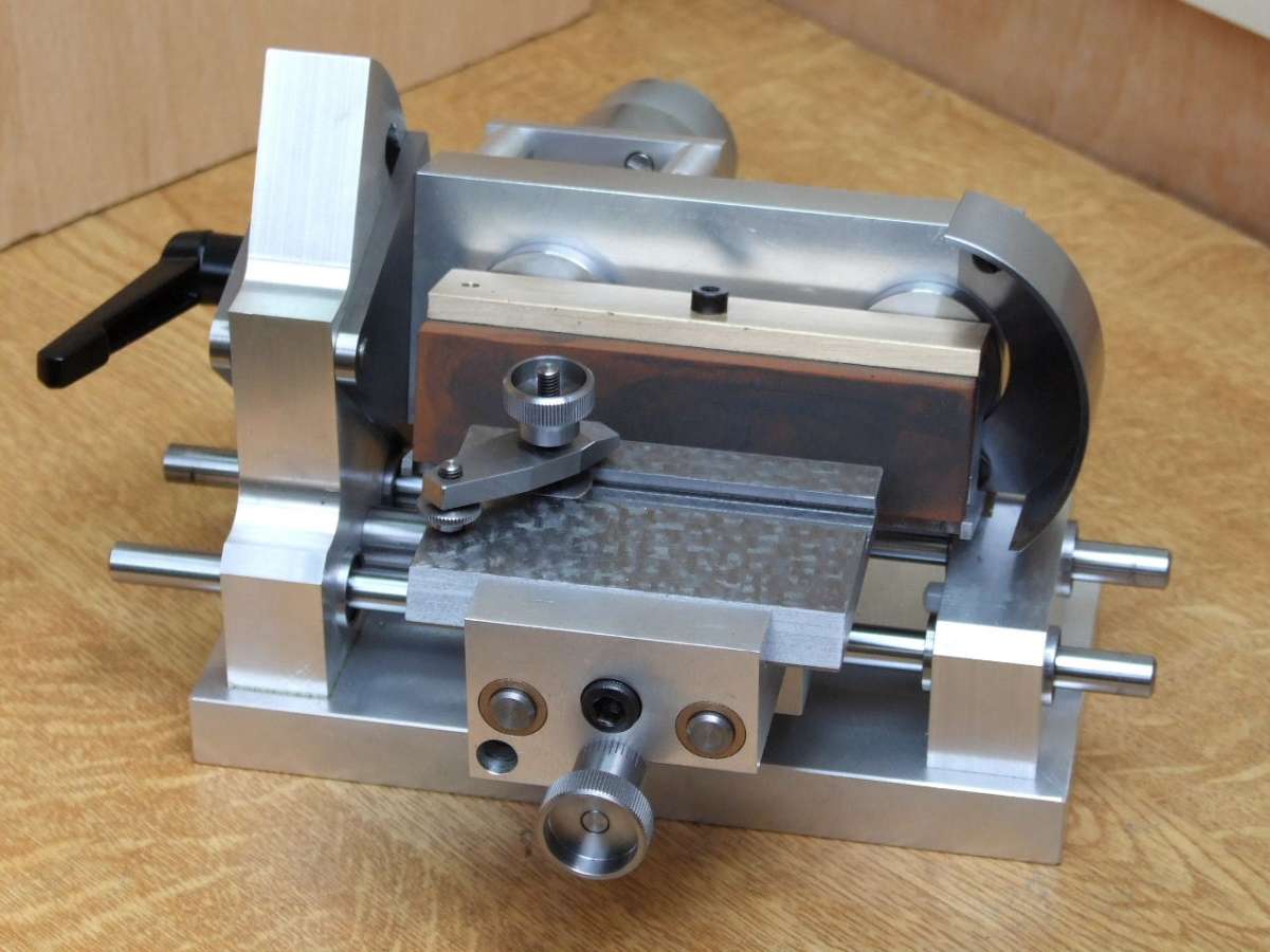

                                              Below is something I made a few years back now. By swapping the stones the keenness of the edge can be changed. The stone can also be changed for a diamond faced one and carbide tools touched up.
                                              Fig Lathe Tool Honing Machine
                                              Birds Eye View, Note spare Segment
                                              Regards
                                              Gray.
                                              #834957
                                              Pete
                                                @pete41194
                                                WOW Graham, that’s simply beautiful work. 👍👍👍

                                                Sonic Escape
                                                  @sonicescape38234
                                                  Regards
                                                  Gray.
                                                  This looks super nice!
