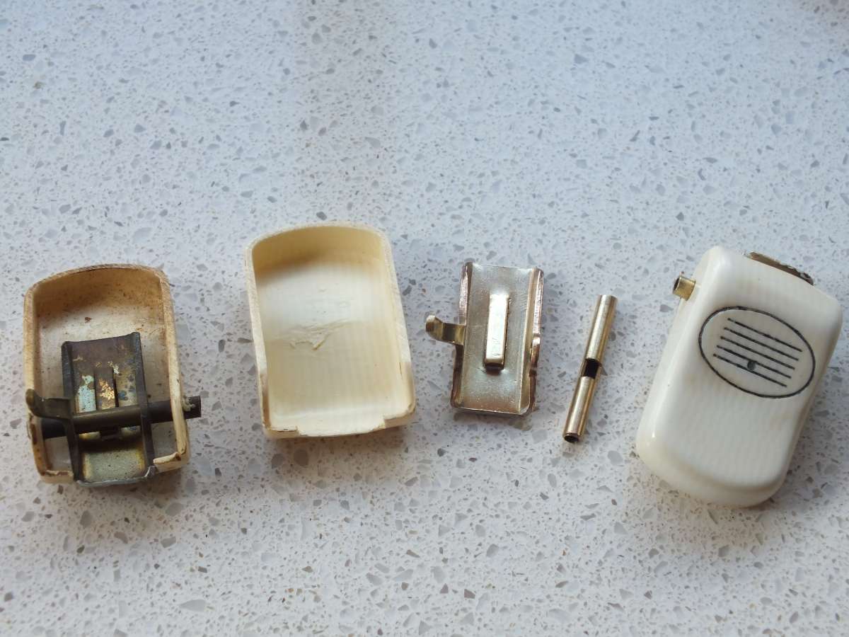

                                I was also worried by possible de-zincification and surface damage to some tarnished brass components of an old accordion. Without much expectation of a cosmetically-satisfactory outcome, I tried some (NaCl) salt and vinegar solution I had to hand for ferrous de-rusting. ‘Fraid I can’t remember the composition of the concoction, it was not following any recipe. Immersion time was less than 10 minutes. There was minimal patchy pinkish discolouration on a few components, but it rubbed off easily (if I’ve remembered correctly – there is none remaining, and I’m too lazy to have done any significant work on the bits other than a bit of a rub with a toothbrush…). The before and after pic of a sample shows a gratifyingly satisfactory result: no post-dunking polishing required! Not up to horological standards, but probably how they left the factory 70 years ago, and good enough for bits that can’t be seen…
                                Worth a try?
