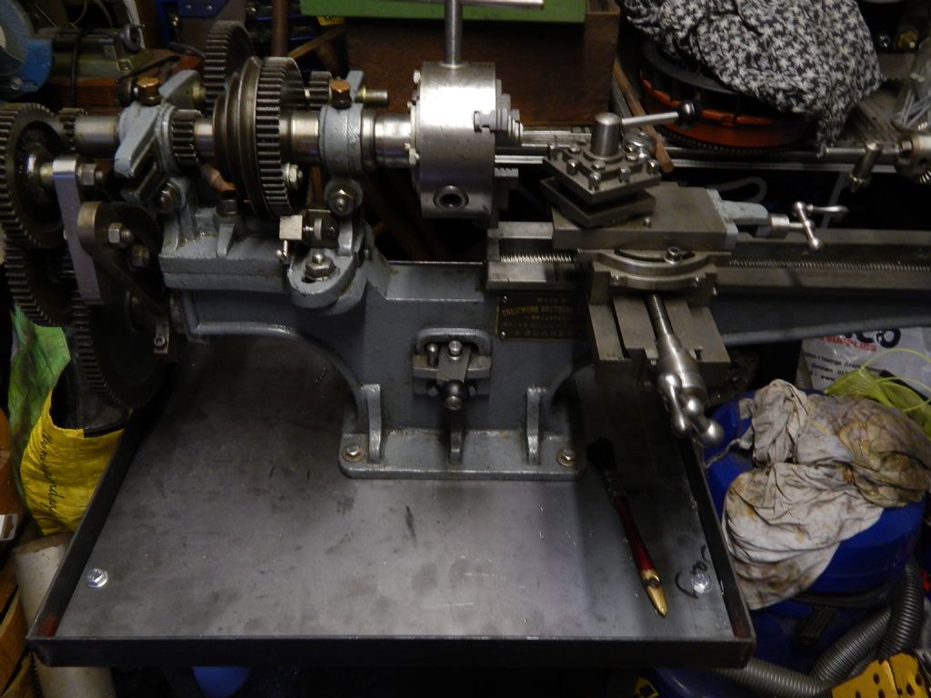

      HI I am new to this forum and have not used a lathe since I was at school and had access to some fabulous machines.
      I have obtained a Drummond and am in the process of re-designing a bench to hold it . This has been constructed from angle iron with two plates of 6mm. One on top and one on a shelf underneath for a motor drive.
      I need to cut a slot in this top 6mm plate to allow the belt to pass through to the motor on the lower shelf. my pulley block is 100mm x50mm and is a standard three step pulley system. Can someone tell me please how much additional space I should add to the 100mm to allow for belt flex . I am using hoping to use a a chronos belt system. I am presuming that if the pulleys are 300mm located over the hole . I need to factor in that this will cope with tappers and enlarge the hole for this too . Does anyone have any useful help please

          I have been told that about 1/2 deflection should be allowed for in the belts . This consider would it be better to have an X with the lines representing box slots with joined cut across tops or a regular larger rectangle be better?
          #219750
          Hopper
            @hopper
            Welcome to the wonderful world of Drummond lathes. What model do you have? (M-type here)
            Are you using a counter shaft between the motor and the lathe pulleys? Are you talking about flat belt or V belt here?
            Some pics of your set up would help. But basically, err on the side of a bigger hole rather than smaller. I would just cut a rectangular hole with maybe 25mm clearance all round the run of the belt.

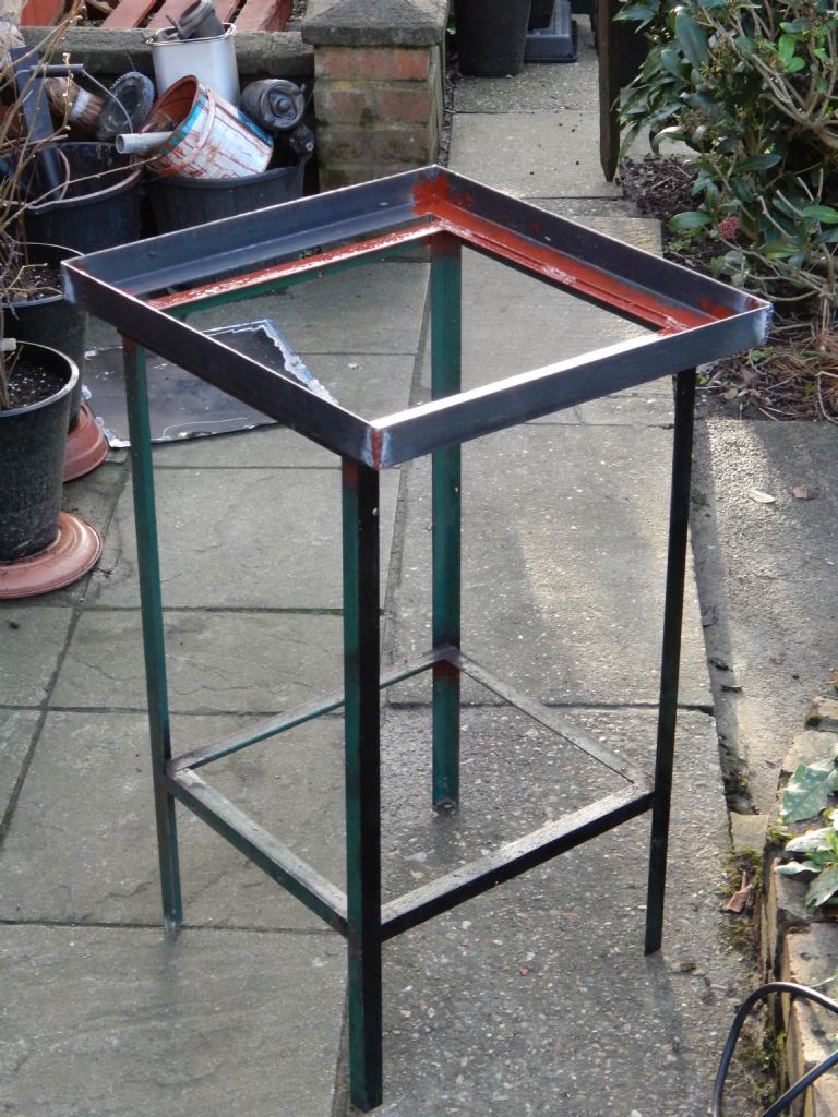

                Here is the frame work have made wanted it small so it would not take up so much space.

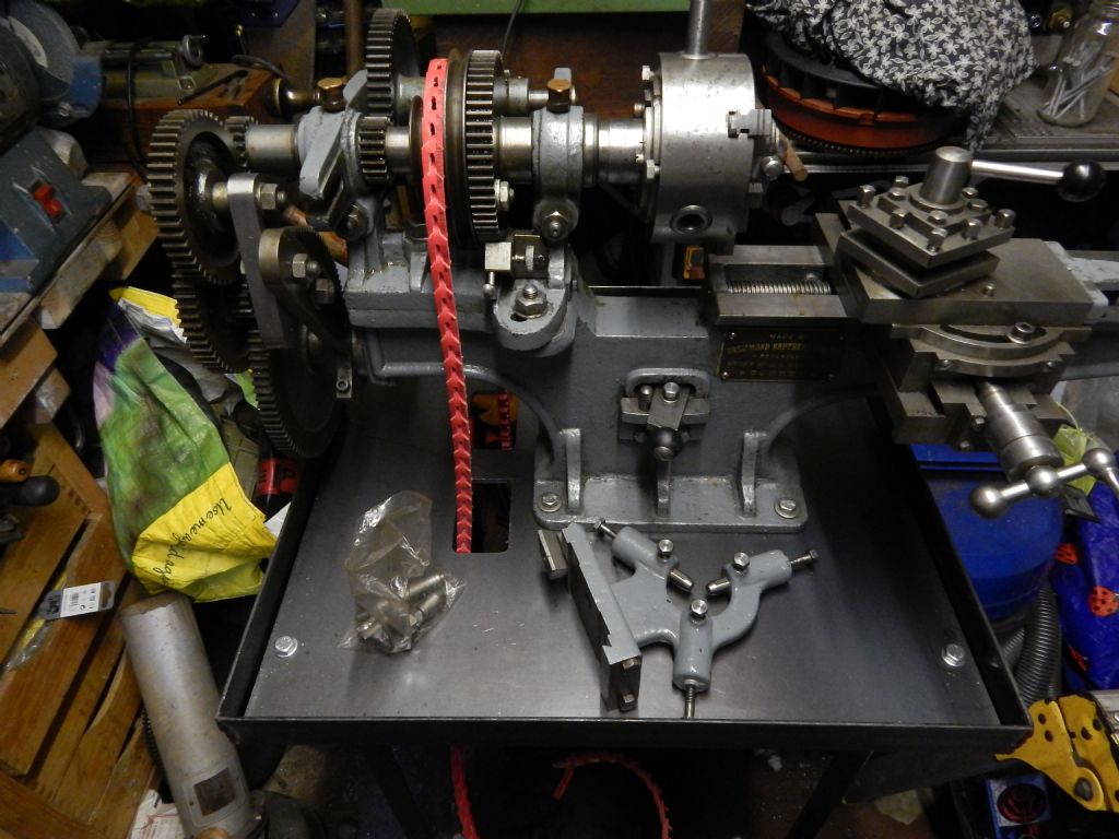

                  Have top plate mounted and lathe mounted . Have to work out the size of the belt holes am going for two i think as it will maintain some structure . I hope someone can tell me the size of the original cuts into the bed on the original stand to take this there is lots of pictures on http://www.lathes.co.uk/drummond/ but no dimensions of the slots to take the belts sadly.
                  #220584
                  Martin Newbold
                    @martinnewbold

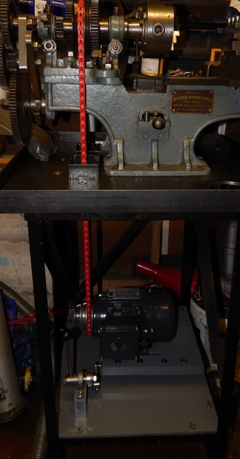

                    This is as far as I have got . Cut some holes not sure they don't want to be bigger. Need motor next and a system to release and tension drive does anytone have any ideas please?dscn5032.jpg

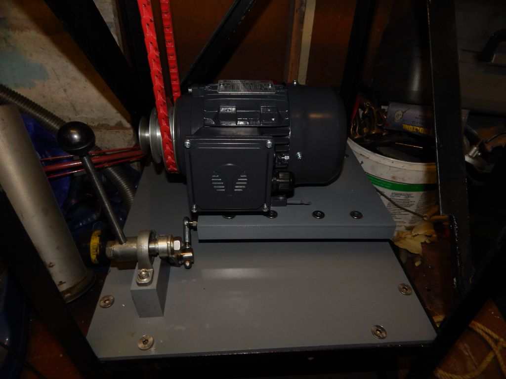

                        Ok have been quite making a motor plate and obtaining a motor these are now installed am looking for anyone who knows where I can obtain a small idler pulley with bearings in the UK as the smaller pulley on the bottom motor is allowing the belt to catch on the lathe. Is there any reason why I cant put the inverter in the door I want to make for the bottom.

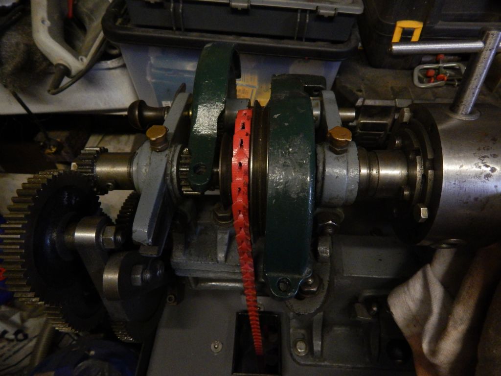

                          As you can see the belt is good, but need to make a tensioner to bring the belt away from the lathe so it does not rub on the side and wear through the belt. Yes I know the gears will rotate and they need a cover Health and Safety
                          #229191
                          Gordon W
                            @gordonw
                            A very good and free idler pulley can be got from any repair garage- tensioner pullies for camshaft belts
