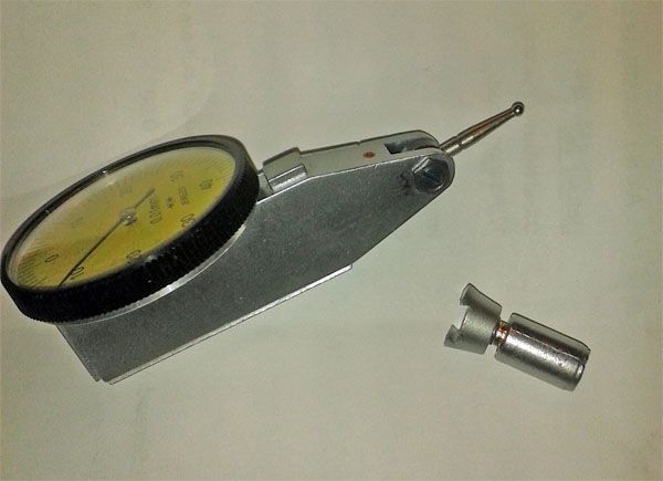

                                    Colin
                                    I bought one of the cheap Chinese important dial gauges from a here today gone tomorrow eBay vendor – it’s held by a dovetail that screws onto either a supplied 8 mm or 6 mm spigot.
                                    I figured that as a beginner there was a good chance I might break the thing by accidently extending it further that it’s maximum range of travel, and that’s a lot easier to swallow if you’ve paid £15 as opposed to £70. It’s certainly proved be more accurate than my ability, but unfortunately yesterday the dovetail mount broke (i.e. fell apart!) making it useless. I have just ordered the marginally more expensive DTI gauge made by Silverline and from Amazon. Still relatively cheap, but hopefully more robust but still not a disaster if I break it. We shall see when it arrives …..
                                    (Does anybody new where I can get a spare dovetail mount from ?)
                                    David
