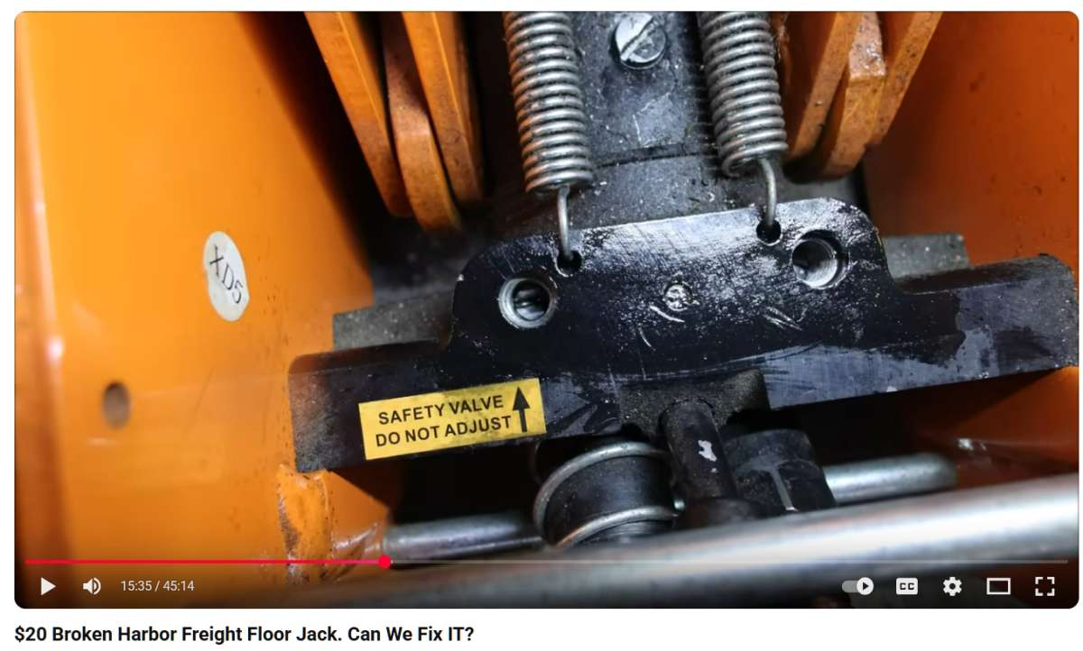

                      Mustie1 repairs a faulty floor jack here…  https://www.youtube.com/watch?v=UtnraagSEXA
                      It has two pistons, one quick-rise/low pressure and the other slow rise/high pressure.
                      There was at least one part missing from his yard sale buy, but I think the problem(s) were to do with dirt in the system and low oil.  And maybe someone had tried to ‘repair’ it before him.
