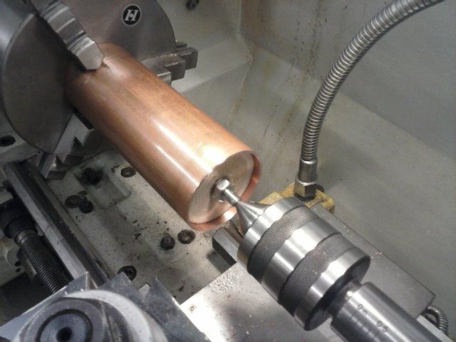

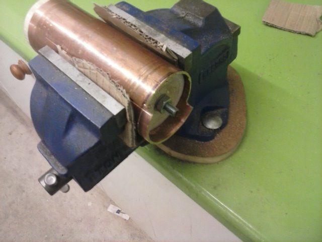

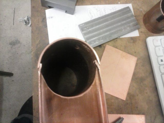

        I'm planning on this thread being picture heavy and as much a diary of an inexperienced guy feeling his way through the build. Hopefully I'll find some more pointers along the way for the next guy following and hopefully not too many 'in hindsight'.
        Everyone has their own way of working. I'm going to have to plod. I don't have the mindset to duck and dive on different bits so I'm just plodding through the build book and this report is while I'm sitting waiting for the saw to cut a large piece of scrap rusty hot-roll for my first former.

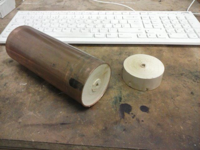

        The boiler barrel first. This was a 12" piece of tube cut to the required length. I chose to cut that on the bandsaw and that really sliced through fast.
        Two wooden plugs spaced by all-thread are to be fixed inside temporarily. I have some pieces of silver birch from my woodland that has sat in the shed for 4 years. It turned beautifully.. almost a waste to use it for this but i have plenty.
        I centre drilled and drilled these through and actually threaded them M8 before parting off 25mm wide pieces. I had to over-drill one threaded hole to 8mm when i realised that a firm fit couldn't be twisted into place but had to be tapped down the all-thread. All-thread centre-drilled at one end for tailstock support.

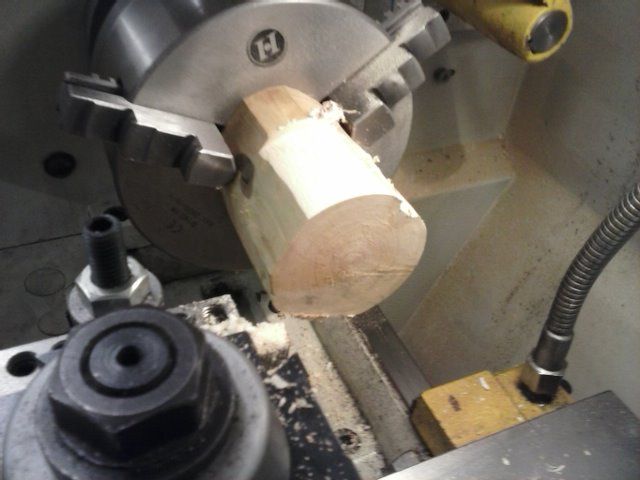

        Back in the lathe for squaring the ends and marking out. It was only when marking out i realised i had been a bit rash in assuming the 3-jaw would centre and hold this parallel to the axis without checking and i suppose I was lucky that there was less than 1mm deviation at the tailstock end when marking out from the viewpoint of the toolholder scribe touching the work.
        If I ever make another then I must remember to dial and bump it in. Bt i got away with it.

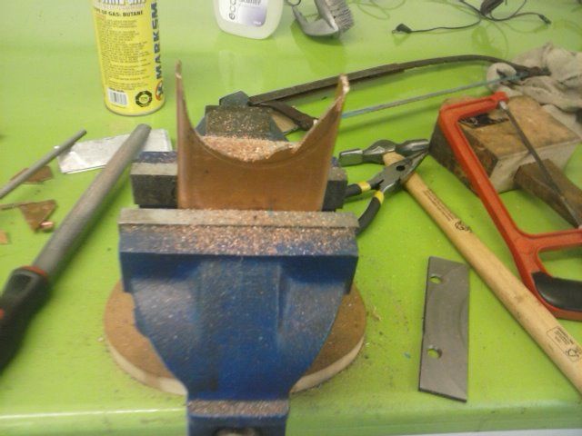

        The cut out was hand-sawn and filed. I left the corners curved as suggested for final fitting later and sawed leaving the scribe line intact again for possible adjustment.

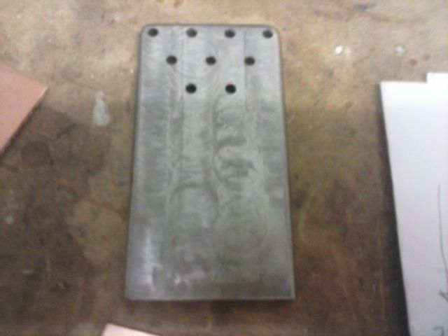

        The throatplate is next but it's going to take a while to turn this hot-roll into a nice former. I have a large supply by way of local scrappy and I'm in no rush so we'll save pennies where possible.

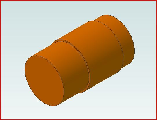

                    #232082
                      If its visualisation that you want then this is good provided you can run te 3D pdf which needs flash, move it about and zoom in etc.

                          However the link to the 3D pdf image only goes to a jpeg. It must have lost it's link to the original file.
                          #232147
                            Goes to a PDF for me. here it is again
                            When you get that up click somewhere on the image, as you move the mouse over the image it will say "click to activate"
                            You may get a yellow bar along the top, go to options and trust the document and the OK the next box, finally click the image again.
                            J

                              All I achieved today was finishing the former. the 3/32 radius is close enough to 5mm that i made a quick simple radius gauge by cutting a 5mm endmill into the edge of some scrap. Radiused the plate mostly on my bench belt sander then a little draw-filing. The time wasting was over milling the plate to size..it started as 10mm rusty plate and it has to be the 1/4" for finishing the flanges. A length of bar would have saved 2 sessions.

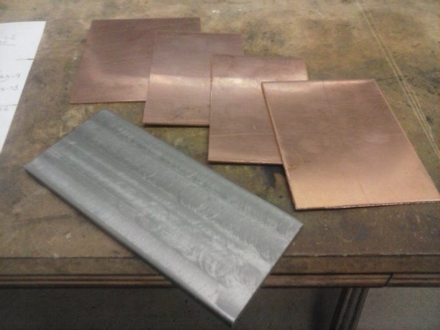

                                pgk pgk
                                  @pgkpgk17461

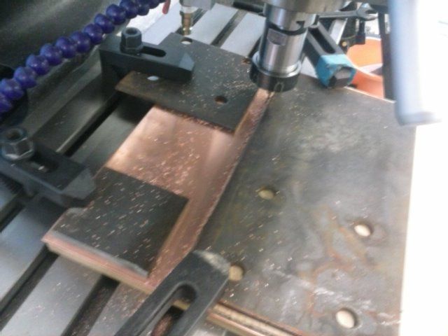

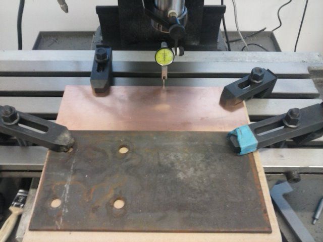

                                  After mulling things over I decide the easiest solution would be to cut it on the mill. That avoids all the issues of wobbly saw lines and leads to a nice easy rectangle. yeah, the setup is more of a pain but I don't have a fence on my bandsaw when vertical and overall this might have been as quick..plus it's hopefully easier to align with the templates with right angle sides.
                                  I chose to use a 3mm 2 flute because my last play with a 1.5mm cutter was — well the cutter wasn't around long. I also cut in 3 passes to avoid any risk of the cutter pushing itself sideways. the actual cuts didn't take long.. more time was in juggling hold-downs so there were always at least 2 clamps in place.
                                  Cutting this with 3mm slots out of a 12" square means that the width ends up 2.25mm less than drawn but a) a saw kerf would take some up as would filing straight and b) that's on the flanges which can't be critical and get tidied up for neatness anyway.
                                  I've got other commitments tonight so my first flanging goes happen tomorrow when I've dug out the emergency gas cooker

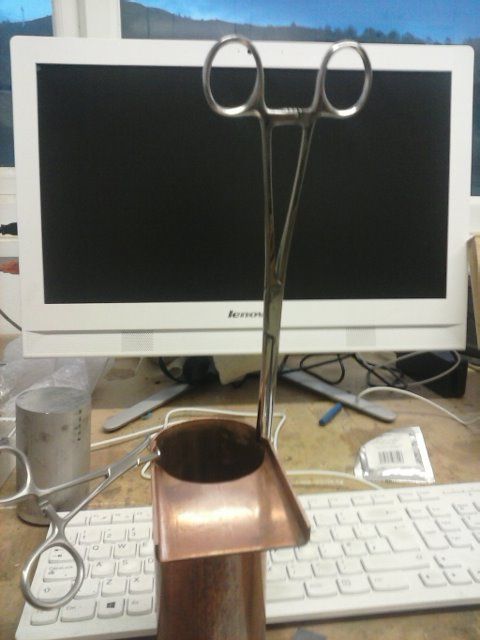

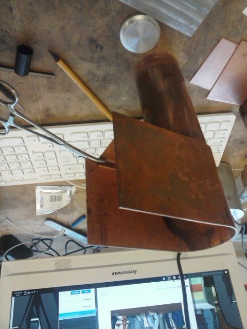

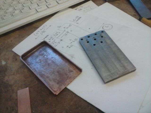

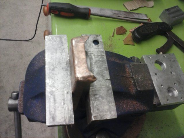

                                        This evening's efforts:

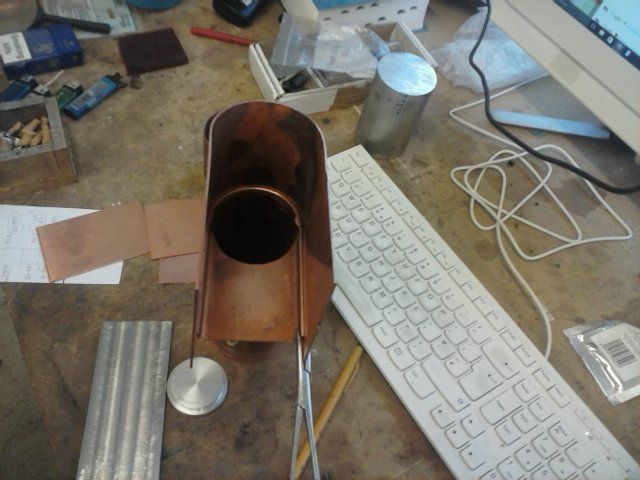

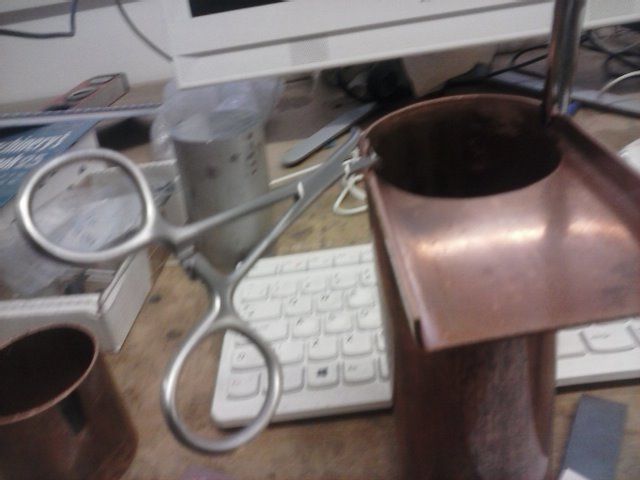

                                        I annealed the throatplate blank on a camping gas ring. I expected a slowish change to plum and red since I've never annealed copper before. It turned plum where the ring flame hit it very fast with a pale center then seemed to suddenly flash-over a sort of silver colour?? Grabbed and dropped in a bucket of water.
                                        I used a rubber mallet to flange it and with the benefit of hindsight that plate could have been way thicker..or the copper piece narrower and where it overhung the mallet rippled it a touch and i had to beat it back flat – no biggie as it goes and I was gratified to find the radius sat a 5mm rod neatly in it – close enough to the imperial target. and the flanges measured square.
                                        It would have been nice to have a fretsaw to cut the circle out..i had to make do and hack with a large saw and then lots of filing

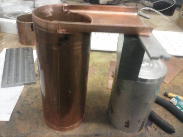

                                        the instructions then require filing the boiler tube tabs to a sharp edge and bending the flange ears of the plate to fit inside them. Its a lot of fiddling and there's no precise approach apart from eyeballs and juggle. I didn't find that very satisfying to do and there's inherent spring in the junction so it's hard to hold and measure.
                                        I trimmed the flange to match the tube using the mill with very light cuts and several passes. The end result looks OK to me… we'll find out in time.

                                        julian atkins
                                          @julianatkins58923
                                          Hi pgk pgk,
                                          That silver flash you saw whilst annealing is way lower than dull red of the copper. Do not be beguiled by the surface colour of the oxide. You need to concentrate on the base colour of the copper in subdued light. When you get to silver soldering up the bits you will see what I mean. You get to that silver flash and you keep going till the whole lot glows dull red! It goes black oxide after the silver flash. Then it starts to heat up properly and gets dull red.
                                          Try out a test piece of decent sized copper and take up to glowing red and note the oxide colours during the process.
                                          Cheers,
                                          Julian
                                          Edited By julian atkins on 30/03/2016 23:12:30

                                            #232606
                                              You have quite abright workshop which will make it harder to see the colours of teh metal, I often turn of some of my lights when soldering inside.
                                              The straight flanges (just a bend really)  will be a lot easier than when you come to do the curved ones and start needing to loose metal, they may even need a couple of heats as the metal will start to work harden and become more difficult to manipulate.
                                              If your formers are a bit thin then add a piece of wood to the back to thicken them up a bit.
                                              Edited By JasonB on 31/03/2016 07:54:00

                                                  Not much to report on yesterdays session. Most of it was sitting and stressing about the job (I stress over all my hobbies ) and fiddling with the throatplate ears so they'd lay right for clamping to drill and bolt up- which i'll do when imperial drills arrive. It's where i miss some of the wonderful bone-fragment holding tools I used to have…not that you'ld want to use pricey stuff like that on a dirty job at £1-200+ per clamp. Artery forceps don't work too well here but some of the cheap disposables could easily be bent to work well if one had access to them.
                                                  It was also a session of working out what supplies need ordering for the next stage.. which has been done this morning (and makes one appreciate why folk 'cheat' and buy a boiler). In the end all i managed was to cut and deburr the wrapper sheet. S afr cutting on the mill is working out OK.. it takes longer to setup but then less finishing work.
                                                  If one as doing a lot of these cuts then making a fence for the mill for a straight edge would be cool. Or checking if the slots are true enough to use as they are. I'll wedge a piece of plate in there and run a dti along later.
                                                  #233478
                                                  pgk pgk
                                                    @pgkpgk17461

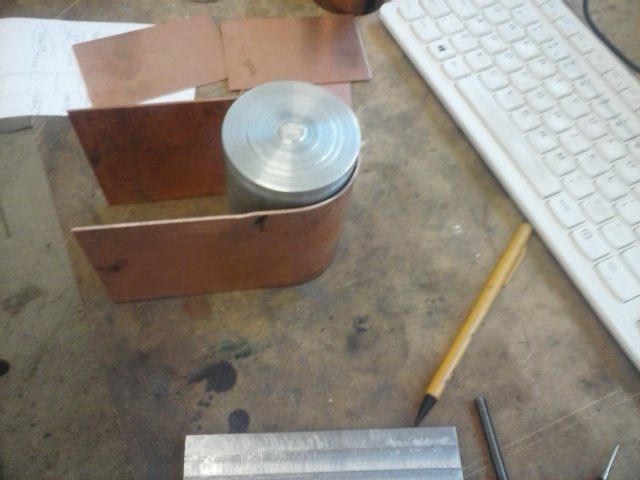

                                                    Only very slow progress to report. I did cut and bend the wrapper.. again using the mill to slice the sheet and then bending over a handy bit of ally rod the right diameter. I also cut the reinforcing plates. Yesterday and today saw several deliveries.. now the owner of torches and solder and gas cylinder, imperial drills, rivets and other supplies.
                                                    Meanwhile i had decided to make a new former for the next plates instead of repurposing the first former.. as much 'cos i can see a second boiller attempt on the horizon…and since i had the imperial drills i was able to make more accurate radius gauges.
                                                    My previous coments about bone fragment holders caused me to look on ebay fr clamps. I remembered the backhaus towel clips are a similer (if weaker) tool and quite cheap. Also rochester pean artery forceps have much longer jaws than halstead or mosquito pattern… so more spring and the possibility of bowing the jaws if necessary. Ebay prices are really quite cheap on these and the quality isn't as bad as you might expect. I;ve included a pic of one of each clamping the throatplate ears.
                                                    I'll try and flange these two plates then probably practice riveting and soldering scrap..

                                                      The second firebox plate came out better than the first (practice) so I made a third. I've also got the motion pad and cylinder pads made and marked ready for bending.. next will be cutting the two bits of plate to sweat together for the pump pad… and starting to practice soldering. I've got all the supplies for the hearth but I'd prefer to build that nearer the shed than the nearest safe barn…and welsh weather in april..well won't stay dry long…so we'll get things ready for soldering and then look for a weather window.
                                                      Next time i make one of these I need to make a copper and a lead hammer first..wooden or rubber mallets didn't work for this flanging.
