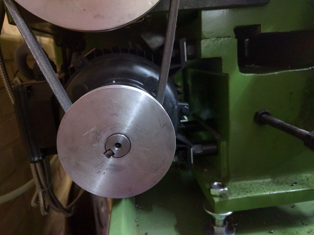

      Photo of motor mounting below – the cold may have finished me off but I don't see much useful adjustment.

        Looking at that picture you could make up a jockey wheel to tension the belt. Plenty of room to tap some holes in the end of the bed. I wish my lathe would go down to 50 RPM I find 80 to quick for some screw cutting.

            It's a bit strange that they haven't allowed for belt tensioning. Maybe there is some scope in the motor mounting. They shouldn't need to be that tight with sensible pulley sizes as they tend to pull in and grip on the side that is transmitting the power.

                        it is a bit of slack fit, and I doubt it helps that the motor pulley for low range is small – about 4 or 5cm diameter without measuring. As suggested above, a tensioner would be easy enough – in fact it could fit on the stud to hold the cover on without any further drilling required.

                            Grrr. Just in case anyone ever has the same problem and is as daft as i am, the tension can be adjusted.
                            The axle for the middle pulley (top one in picture above) is mounted in a vertical slot with a t-nut behind, so it can be shoved up a bit. The slot was covered by a washer and I hadn't noticed it until I started looking at which pulleys would be easiest to change to alter the speed range.
