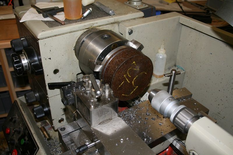

            Spurry
              @spurry
              As there seem to be plenty of parters-off about, how about this task?
              It's a bar end of 5.5" (140mm) which was too small to fit onto the steel stockholders bandsaw, so it fell into my lap. &quot
              Slightly too big for the vice on my little bandsaw, so how to get a 20mm slice off?
              Pete

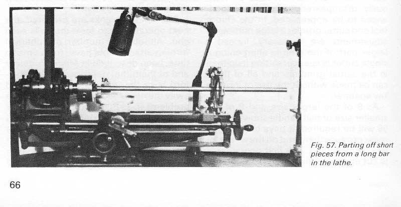

              ega
                @ega
                Michael Gilligan:
                Yes, a job for the fixed steady as in this extract from DHC's Quorn book (the infamous ball handles):
                Parting the DHC way
                Note the improvised extended cross slide handle.

                Muzzer
                  @muzzer
                  Posted by Spurry on 20/01/2016 11:15:02:
                  It's a bar end of 5.5" (140mm) which was too small to fit onto the steel stockholders bandsaw, so it fell into my lap. "
                  Pete
                  • Use an indexable parting tool (blade is less brittle and fragile than an HSS blade and the holder will help to reduce overhang of the topslide)
                  • Minimise overhang of the tool from the topslide to an absolute minimum.
                  • Tighten up the gibs so they hardly move – and lock the top slide and carriage. The topslide is particularly prone to twisting due to the need for the tool to overhang so the cross slide clears the jaws. It's not ideal!
                  • Coolant if you have it
                  • Power feed – for consistency
                  • Rubber pants
                  • If you are superstitious, use the tool upside down and/or at the back of the cross slide, turn round 3 times, pat your head and say something lucky.
                  Or cut it from a piece of 20mm plate instead?
                  #221857
                    Posted by Michael Gilligan on 20/01/2016 09:15:20:
                    Posted by JasonB on 20/01/2016 07:51:43:
                    As Phil says it was completed by hacksaw, also I would not want to be making that cut without tailstock support – the weight of the long length of bar would tend to tilt down and close up the cut which would definately cause a smash up. And as for the alternative of cutting at the far endcrook
                    Jason,
                    This is a purely 'Armchair' question [because I have little interest in working lumps of steel that size] but: "as for the alternative of cutting at the far end" … Might this be an opportunity to use the fixed steady ?
                    Michael I find that doing the parting (deep groove) at the chuck end works better as things are more rigid than working at the other end with either the tailstock or a steady where I get a bit more chatter. This is based on my findings in the workshop rather than thinking about it in a comfy chairsmile p
                    Looks like the pic Ega posted found the same issues and parted at the chuck end, either way you would not want to part all the way through.
                    J
                    Edited By JasonB on 20/01/2016 13:27:02

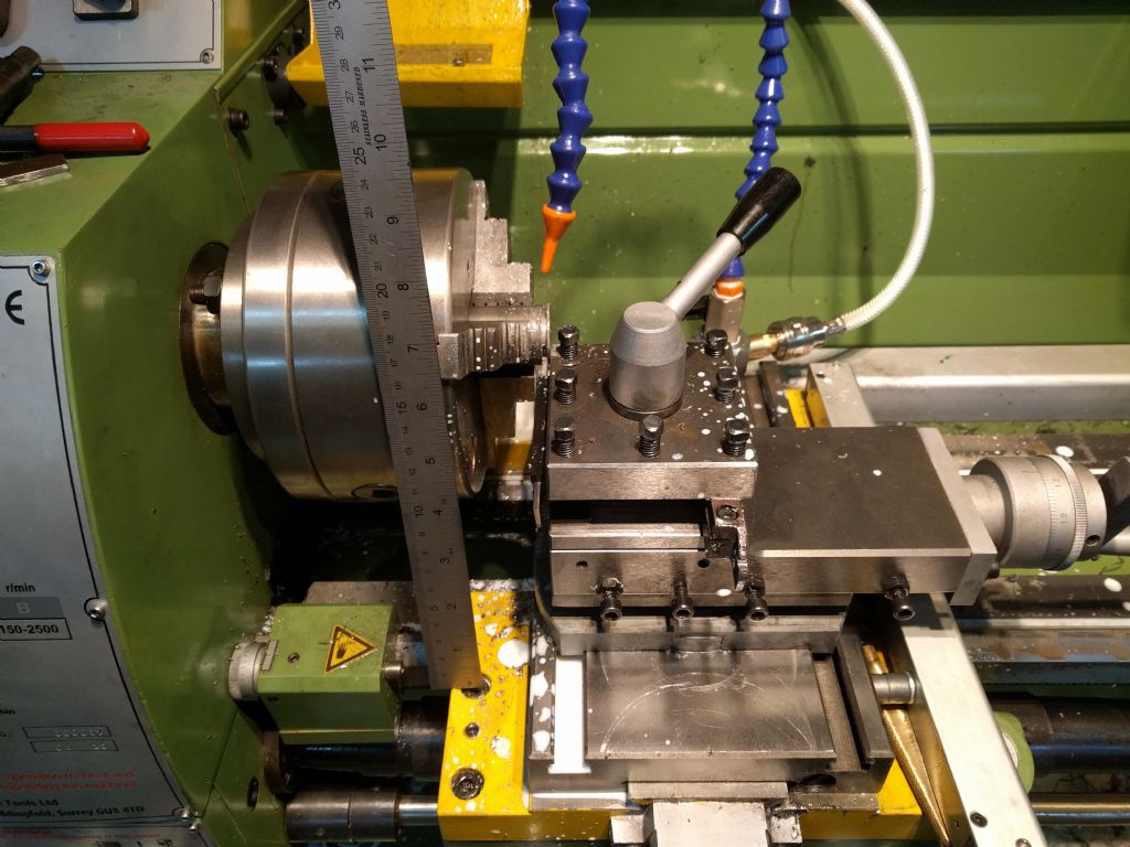

                            Dan Carter
                              @dancarter89683
                              Thanks all for replies. I have been trying a few things, without any notable progress:
                              Setup as in photo – now with 4 way toolpost, compound locked, cross slide gib tighter than I want it, carriage locked. Moved on from En3b to a bit of EN1A leaded. Should be a doddle right ?
                              using hss tool (http://www.axminster.co.uk/axminster-parting-off-tool-holder-800377) as no tips left.
                              Still no Joy. Constant stops. If I use power feed (3 easily available feeds something like 0.035, 0.017, 0.009 mm/rev) it jams almost instantly, so is not an issue with rubbing on the sides. If I feed manually I can get further, but not for long.
                              It does not appear (as JasonB said) to be the backlash – I can see the X value on the DRO does not jump when the jam happens. There is now no perceptible movement anywhere in the carriage/slides with my not inconsiderable bulk tugging on them.
                              Could it be a motor/vfd problem ? I noticed that it is not particularly difficult to pull the chuck around by hand after it stops, which I would not have expected from a proper dig in – also the tool is not damaged, deflected etc.
                              This is my second 290v , and I did notice that it took a lot longer to spin up than the first one, but didn't think much of it at the time.
                              Someone asked earlier in the thread about my dickson clone – although that doesn't directly seem to be the problem here, I am pretty sure they do sometimes move under load. It is the Warco one marketed specifically for the 290V.
                              Sorry for the long post …
                              Dan

                                #221878
                                Emgee
                                  @emgee
                                  Dan
                                  I think you have answered your own question, the VFD is not coping with the torque required for the cut, perhaps it needs some adjustment for low speed output.
                                  Jam up is either too much infeed or a too heavy cut whether you are turning,facing or parting but all are related to available torque at the spindle.
                                  Emgee

                                          Dan Carter
                                            @dancarter89683
                                            Many thanks for all the help – especially the suggestions since my last post – finally some success:
                                            You were all correct, stall not dig in (mostly, I am sure my clumsiness caused some actual digs)
                                            I had originally been in high range (the low range is a bit annoying on the 290v as is 30-450, so bit low for general use) and it was definitely stalling then. I had then moved to low range first thing this morning, and thought it was stalling, but was actually the belt slipping (thanks Muzzer). The belt from the motor to the idler for low range (M26) was quite loose and slipping under load.
                                            Cleaning some of the muck off the pulley helped and I got my first successful cut under power feed for the day. It started slipping again quickly, but at least I know what the main problem is.
                                            I've had the lathe about 4 months – is it likely to have stretched in this time or am I going to find a replacement is also slack ? (There is no adjustment for this belt)
                                            Thanks again,
                                            Dan
