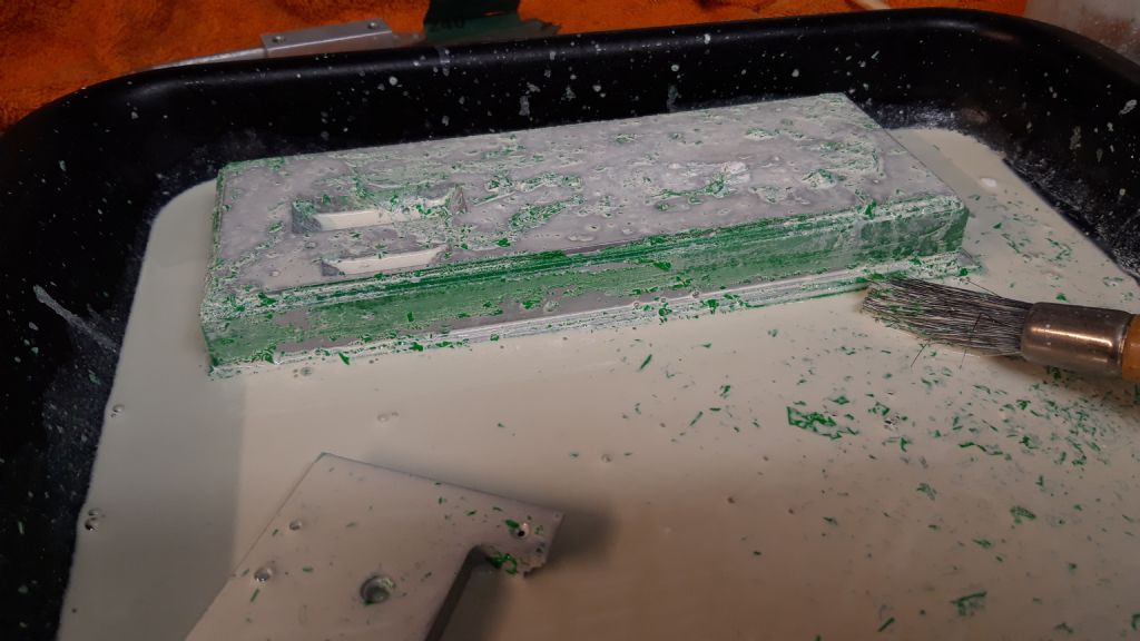

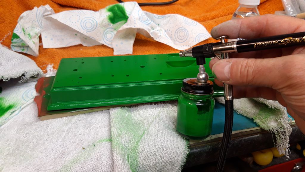

      I've been building the Stothert & Pitt beam engine for what seems like an eternity! And despite putting it off for ages, the time has now finally come to painting it. I like green by the way.
      So I got out the trusty Aerograph, filled the pot with green acrylic gloss. The unlucky base, beam, bearing stand and top plate was duly sprayed, and bingo! nuclear pea green! complete with runs and blotchy finish! That was Wednesday (see nuclear pea green photo).
      After about three seconds of deep thought I came to the conclusion it had to be destroyed, so the very next day all the bits were immersed in a bath of Acetone, the paint melted off.
      I'll start again with gloss or satin enamel, with a slightly nicer shade of green, probably sprout colour or runner bean maybe! And practice my airbrushing skills too!

            Build it up in thinner layers, with acrylics it can also help to warm the part beforehand to speed up initial tack so stand on a radiator for an hour or so before you spray it.
            Largest nozzle/needle you have so paint does not have to be thinned excessively. Use an acrylic thinner rather than water which will dry faster between coats.
            Also can't see if you have primed it or not, for a Kermit green like that a white primer will give best results and need the least thickness of topcoat to give solid colour, grey for a darker green.

                  Some good advice here. Thin coats are good. I did thin it down with Acrylic thinner, and maybe I should have done more practice on a bit of scrap. I did undercoat it you can just make out the white paint (the Acetone is old used stuff from decorating the house the other week). And the air pressure is tricky to get right, I've not airbrushed for a while. And it was a tad cold.
                  So! Plan B is try again with enamel, I do get better results with that stuff. And I'll give the airbrush another go before I get the paint brush out.
                  I'm undecided if it's really worth undercoating or priming aluminium before painting with enamel. I have painted bare metal without primer and it is still there after many years, so stand by for disaster number two!
