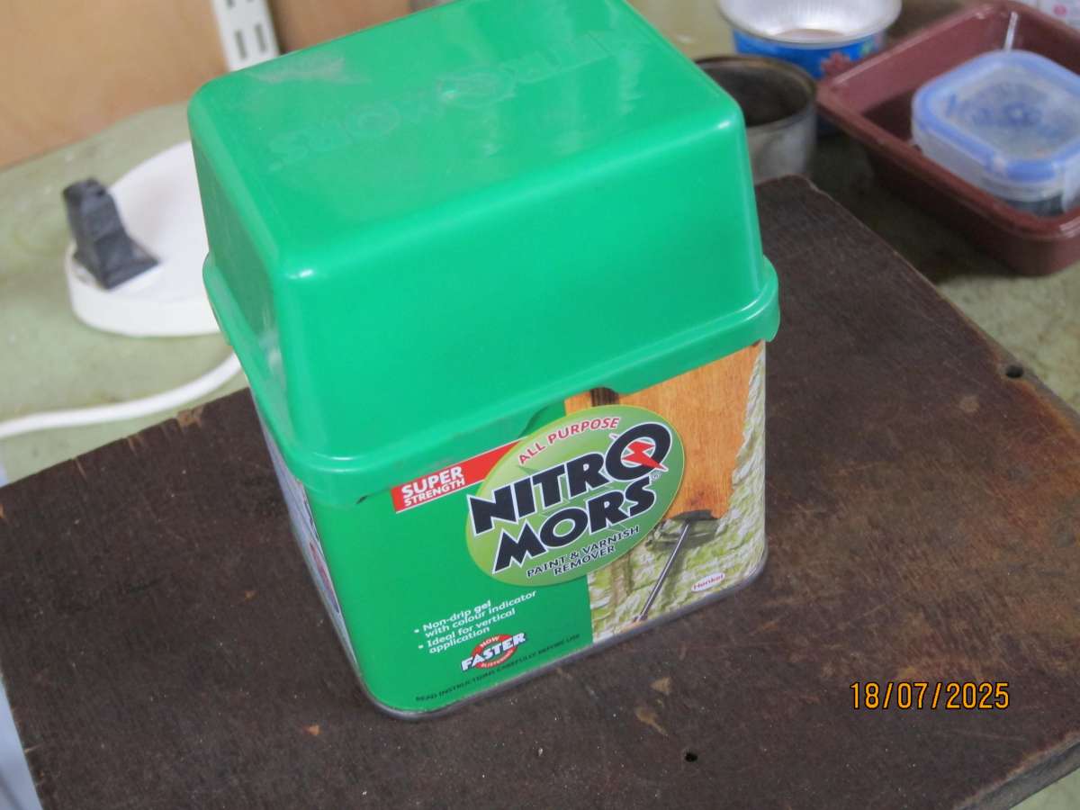

      I am trying to recover some straight and potentially useful lengths of ¼” diameter mild steel rod salvaged from an unwanted wine rack but the bad news is that the black coating does not respond to my current tin of Nitromors paint stripper.  Given the cost of steel these days, this is very frustrating and I am sure that Nitromors I bought in the good day before ‘elf’ and his mate came on the scene I would  not have this problem. A part from using abrasive means or perhaps a scraper, are there any other possible ideas out there?
      I should perhaps add that the tin of Nitromors although some 8 years old now is perfectly fluid and brushable and to be honest has been effective in the past when applied to some DIY aerosol painted partsNitromors

                Problem now resolved.  What turned out to be I’m sure a powder coating did in deed come off with mild heating and scraping. Many thanks to all who replied. I now have some very useful lengths of mild steel bar for future use.

                          Sure enough, when the coating had been removed, the rod did mike up to 6mm diameter. In fact, the whole process of removial was quite simple,  all that was required being a single longitudinal cut with a Stanley knife and then peeling back the plastic layer. Oh well, put it down to experience!
