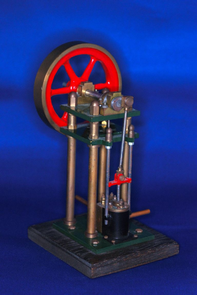

                                    It is getting on for ten months (doesn’t time fly !) since I started building Stan Brays Opus Proximum and whilst it has been a struggle I am now pleased to report that at last it is up and running. Those interested can see the step by step build log and the final outcome at
                                    John S

                                          John Shepherd
                                            @johnshepherd38883
                                            I am afraid to say my Opus is not a runner. I had a lot of trouble with the valve gear and I gave up as I became convinced it was not going to run well anyway.
                                            Photo as requested – it is a  bit dirty and tarnished as I have just got it down from the loft.
                                             Perhaps now it is down I might have another go
                                            at it and tidy it up.
