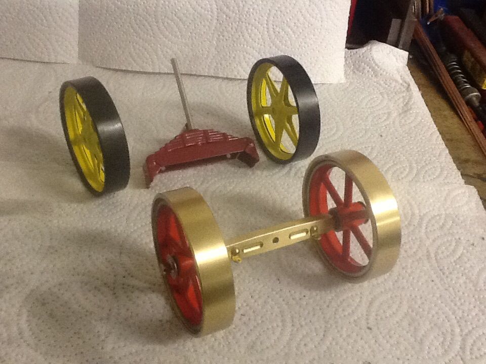

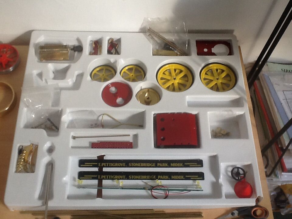

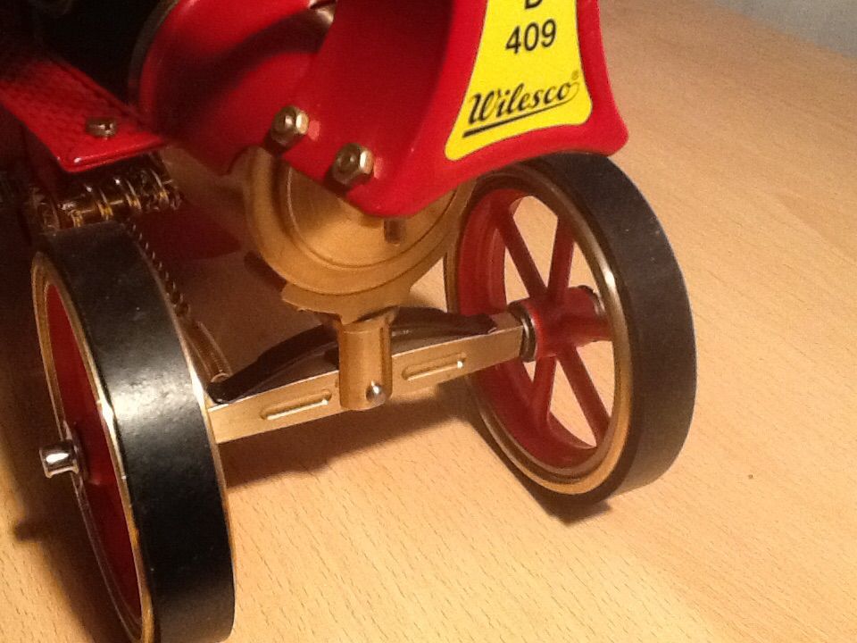

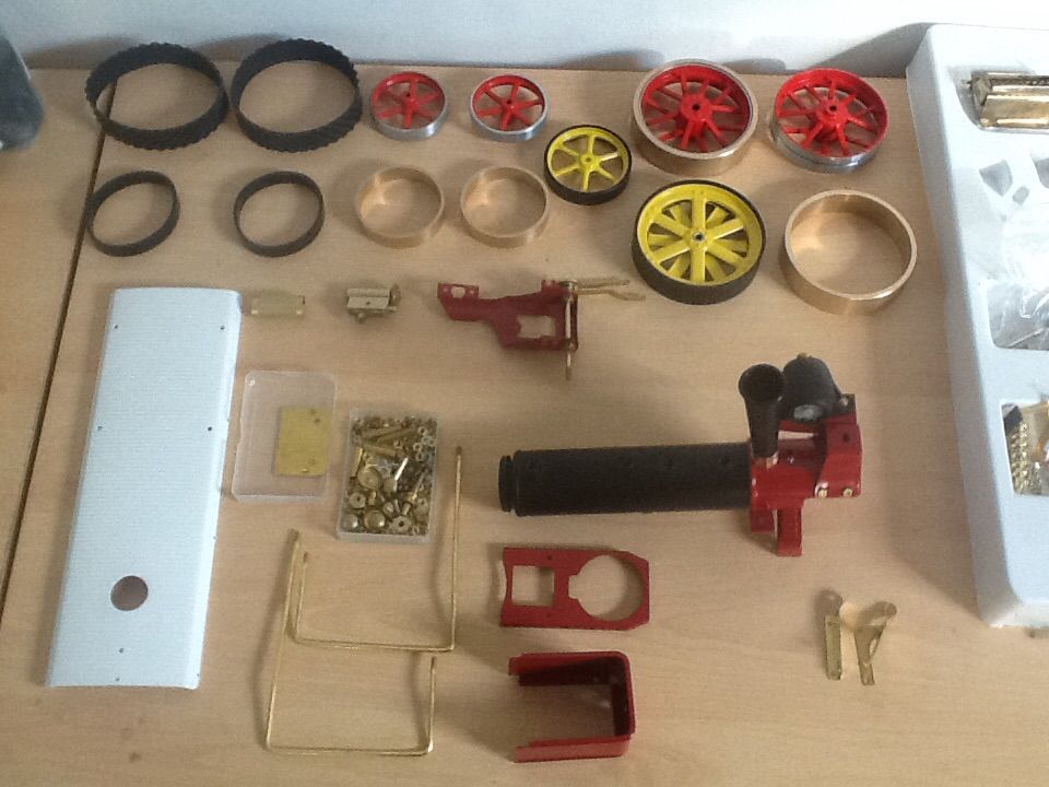

      I purchased this new Wilesco traction engine kit as a birthday gift for someone of, shall we say, slightly more mature years. But despite it's price tag it was a little more crude and toylike than expected. So I have been remaking some parts to improve the look of it and give it a less toylike and higher quality feel before I hand it over to its new owner.image.jpgThe yellow front and rear wheels shown below are the ones supplied in the kit. As with most of the kit they are formed from thin steel pressings, this leaves them a little crude and unrealistic.
      The red wheels are from Mamod and are far more solid and realistic zinc alloy castings. But they are a little smaller in diameter, so I machined up the solid bronze wheel rims shown, the rear ones are 100mm diameter. A single rear Mamod wheel with bronze rim weighs at least as much as the whole of the original Wilesco model.image.jpgHere is the new front axle I made complete with the bronze rims and Mamod wheels. In the background is the Wilesco version, all made from thin pressed steel.image.jpg

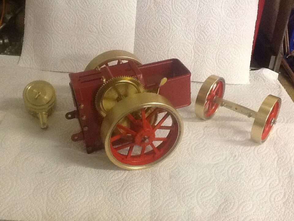

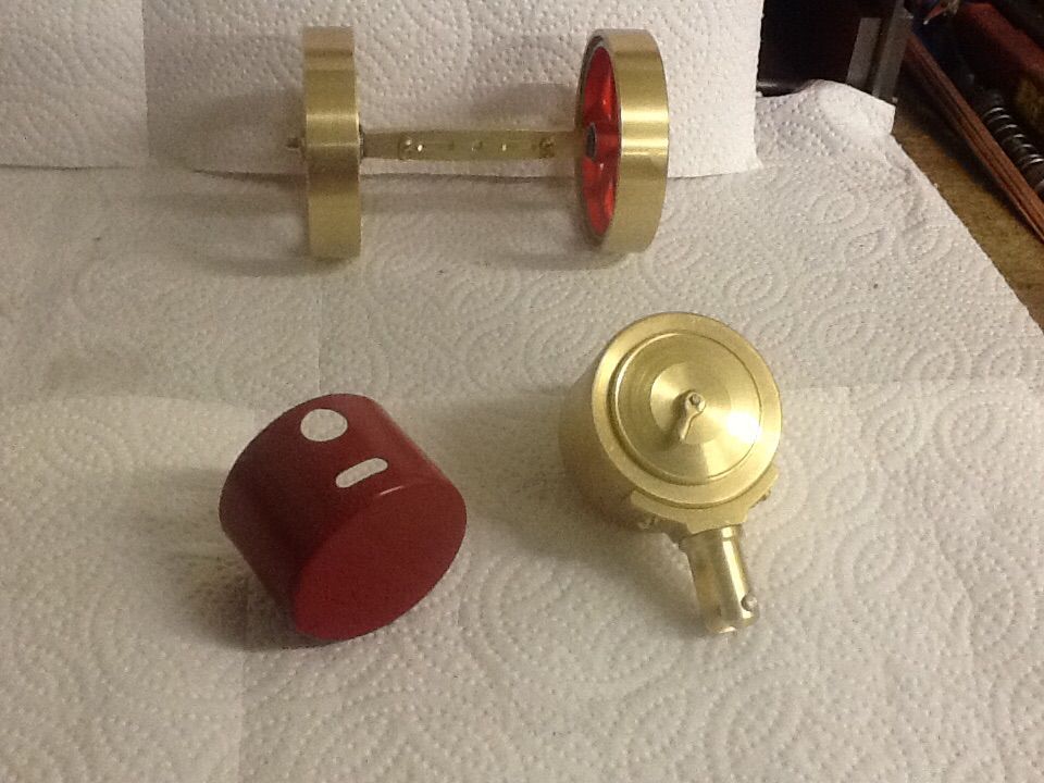

            Below shows the new bronze smoke box with door and steering fork. The very simple pressed steel Wilesco smoke box is on the left.image.jpgThe almost complete new front end in the background, the new leaf springs not yet fitted. The Wilesco version on the right. Instead of pivoting on a pin the Wilesco axle rocks with the steering pivot shaft slopping from side to side in the top slotted hole.image.jpgA bit of assembly finally taking place, with the replacement rear wheels and a bit of gearing installed shown below.image.jpg

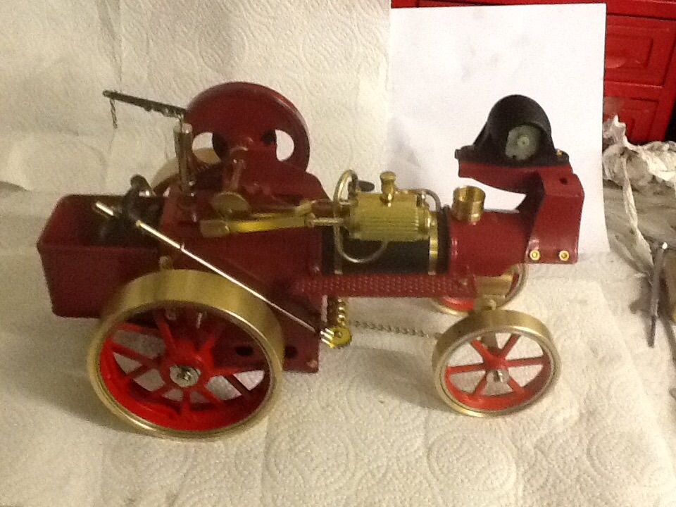

              It's beginning to take shape, the new front axle leaf springs are yet to be made and fitted.image.jpg………………….A bit more progress with the engine assembled and fitted. Quite a bit of tweaking, flexing and adjusting was required to get the engine and rear wheel drive gears to turn smoothly without binding or tight spots.image.jpg…………………Below shows the working Dynamo fitted, and a new Wilesco lever operated whistle from one of their stationary engines that replaces the kit supplied type. The working steering mechanism has also been fitted.
              This self assembly kit is supplied with nuts and bolts to secure it together. The engine is also available ready built from the factory, but then it is secured together with eyelet type rivets. There is no difference in the price of the ready built kit or the self assembly type.image.jpg

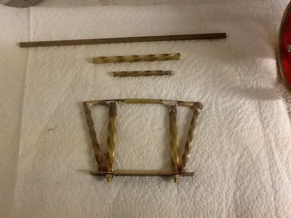

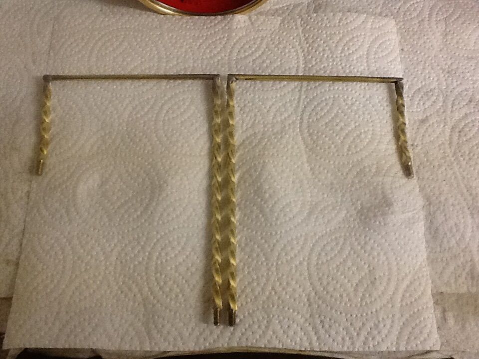

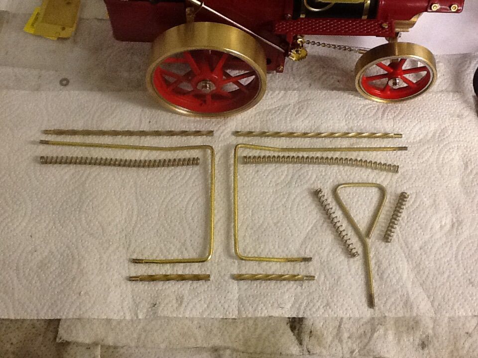

                    The canopy supports are supplied as shaped lengths of 4mm brass rod with a coil spring slid over to simulate a twist. The two U shaped frames with springs shown below form the rear and middle supports, the Y shaped frame is for the front support. The twisted brass sections are what I formed from some 4mm square brass bar.image.jpg………………I thought the brass bar might just break as I twisted it, but it was quite flexible enough to take several full turns without problems.image.jpg…………….The rear and middle brass twist supports were formed and soldered to the chopped up Wilesco supplied brass rod.image.jpg……………..A new front support was also made, a little more realistic than the Wilesco made Y shaped thingy. I originally used ordinary soft solder on the joints, but it had no strength and just snapped at the slightest contact. So out came the big guns and I silver soldered it which cured the problem.image.jpg

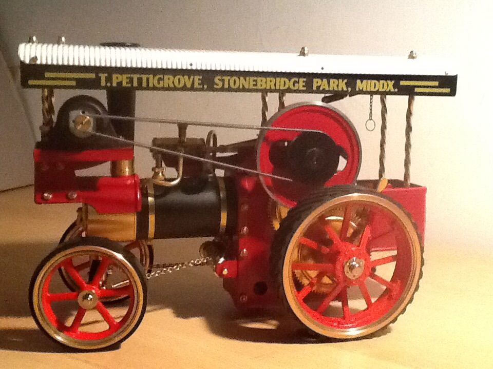

                            Nearly finished now. The twisted brass canopy supports are in place, and they don't seem look too bad.image.jpg……………..I also made and fitted a couple of leaf springs on the front axle, I almost wish I had stacked three of them in there, but they seem to look ok. The springs are cut and shaped from the steel banding used for packaging.image.jpg

                              I also made a couple of brass boiler bands to brighten things up a bit.
                              The kit comes supplied with these quite good T Pettigrove facia boards.image.jpg…………..But I decided to personalise it a bit, so I made some new facia boards shown below. The engine is also supplied with eight lighting diodes that should be attached to the back of the facias, fitting them and wiring them to the Dynamo is just about the final job.image.jpg
