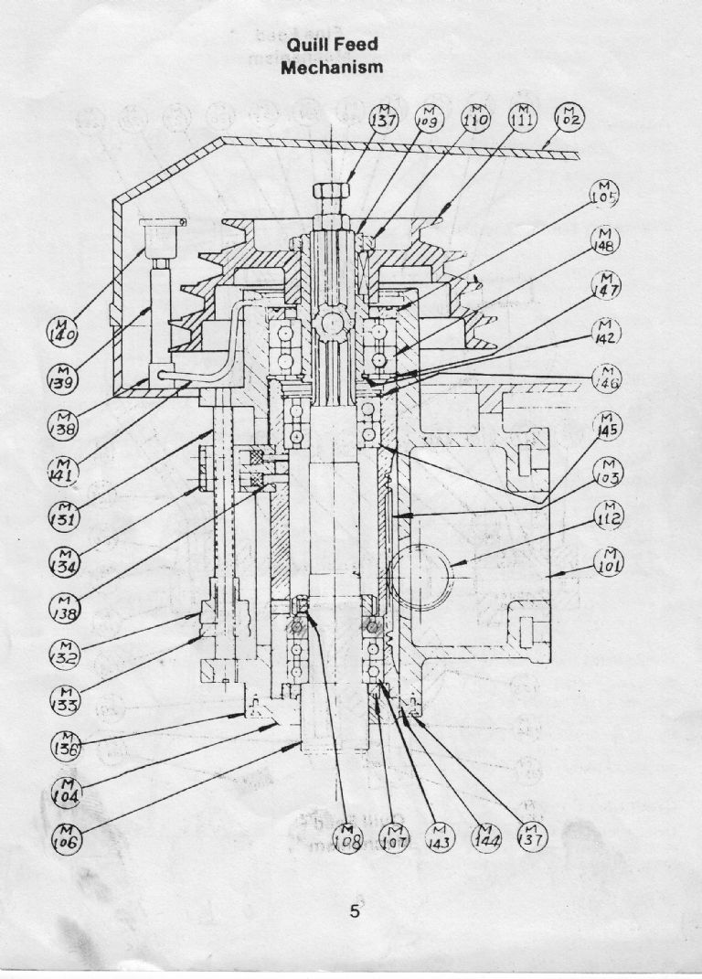

      What kind of runout is typical/ acceptable on a Myford/ Warco VMC mill spindle as measured on the bottom of the spindle taper? I'm getting 0.035mm and not sure if that's terrible and if so what I can do about it?
      Edited By John D on 13/11/2022 14:19:34

              Thank you for the reply, Brian. It's an R8 taper and I don't have any R8 drills, only ER32 and Clarkson Autolock collets. I don't seam to be getting much worse a reading when the quill is lowered. I have measured on the inner edge of the taper and the outer edge of the spindle nose and get the same reading. I bought it from a guy who i thought reputable and well thought of on here. I've spent ages fitting a 3 axis DRO and now gutted to find this.
              I can't find much info on line about the Myford Taiwan imports and which other branded models might share the same spindle. (e.g. it doesn't have fine feed quill) Is there any way of re-machining the taper to take out the runout? Is replacing the spindle the answer – if indeed i could find one? The parts diagram is pretty unclear – i'm not sure how to remove the spindle.

                          There is in my album for the A2F mill the complete handbook
                          which has a parts list ,i don't know if these machines are identical,Chester
                          still sell this machine as as the 830 VS so may have or be able to get parts.

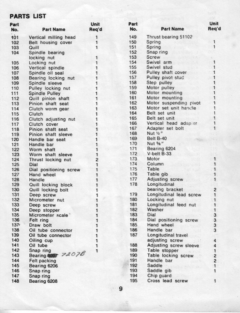

                                                    I don't know if it will be any use to you but you haven't said whether you have a diagram of the headstock/spindle but here is the one for mine. As I said earlier mine was made in Taiwan same as the Myford so may be of some use.
