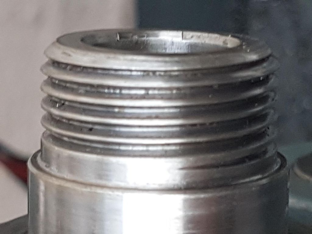

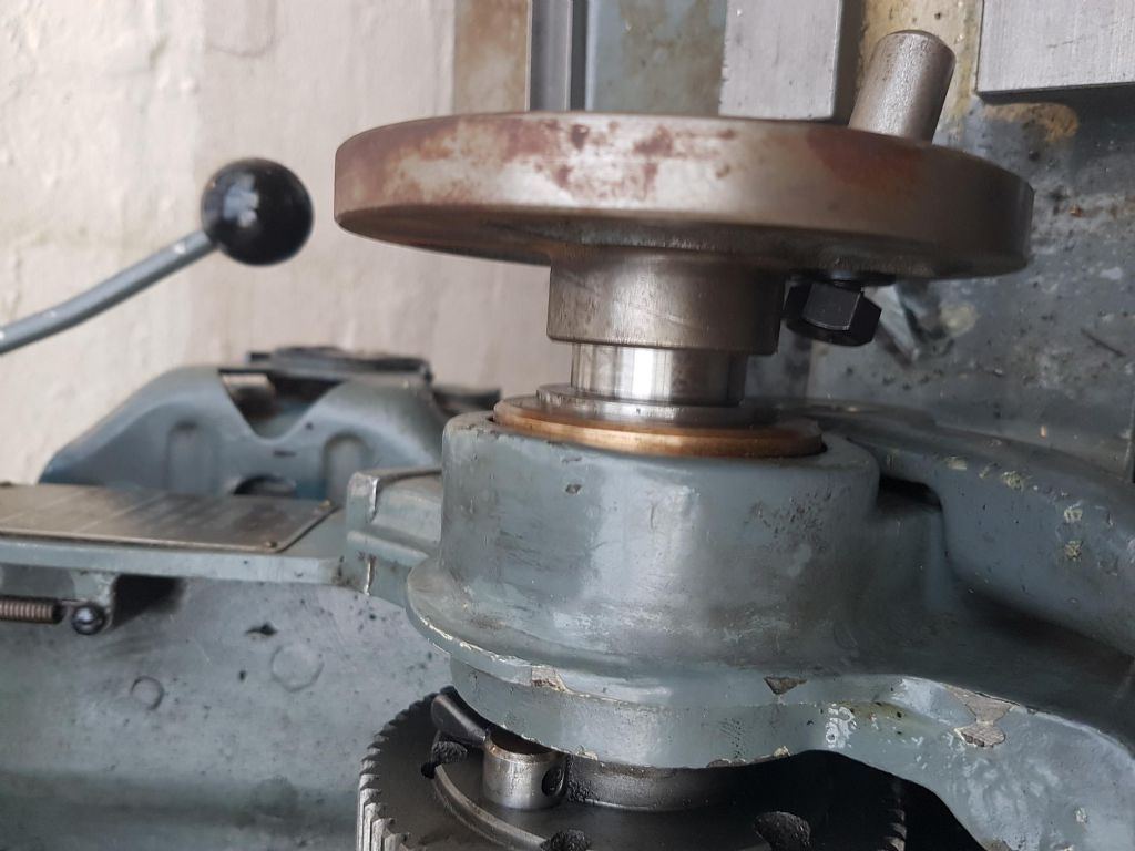

                              Hello again, and thanks for the replies. Bearing in mind the information about where the chuck should sit, and the force required, I have come to the conclusion the spindle is the problem.
                              I tried today with two different chucks and two different face-plates, and got the same results. After about half a turn, it sezies up completely, still a good 1/4" away from the collar.
                              The threads look ok, on both the spindle and the chuck / plate threads, so I am at a loss…I want to get the chuck / plate on first, before I think about the bearings, I am still hoping I am doing something stupid, but screwing something on seems so straight forward I don't quite know what.
                              To my eyes the threads look ok, but here is a picture of them:
                              This is as far as I can get anything on:
                              Nick…

                                Posted by Nicholas Hill on 03/07/2017 20:56:00:
                                Look at that thread with a magnifying glass, I can see bits of swarf in the photo.

                                  Following on, what is the thread of the spindle? I thought it was a Whitworth, but for a 1 1/8 Whitworth, it should only be 7 or 9 TPI, but the Myford is 12 TPI…which relates to the 1 1/8 UNF..I am thinking of getting a die to go over the threads…

                                    You will have to check the spindle thread very thoroughly, small chips can embed themself in the thread and swiping it with a cloth or brush will not remove them. You will have to remove them with a small tool. The same is true for the thread of the chuck you try to fit. Niko.

                                      I use an old toothbrush to clean swarf out of my Boxford spindle -nose and the chuck backplate threads.
                                      Dont really know the Myford, but I certainly wouldn't put a UNF die on the spindle theads. I'd expect it to be Whitworth form.

                                        The thread on my S7 is 1.25 whit x 12 TPI Chronos do a die link

                                            The Myford spindle nose is 12tpi 55deg Whitworth, I doubt you will find a die as it is non standard. Taps are available. the nose is hardened and would not be kind to to a die. The nose thread should be perfectly clean before fitting a chuck and also the thread in the chuck backplate. As you have tried a couple of things on the nose it may well have a piece of swarf pressed into the thread. A brass wire brush is useful to clean the thread and a pick or scriber to remove anything that will not brush clear. The chuck thread is a little more difficult to clean but people often bend a piece of thick wire so it has two points to engage in the thread and screw it down the thread to clean it. The chuck thread will need to cleaned every time before mounting it. I would strongly resist the temptation to do anything drastic to the nose as it is a precision piece of machining. Get it spotless and inspect very closely for any damage and do no more than is absolutely necessary to correct the damage. The register which is the diameter and face beyond the thread is made to a very tight tolerance and unless it has sustained any identifiable damage should not be touched. Any polishing will affect its dimensions even with very fine abrasive.
                                            Mike
                                            Well while I was typing Harry has found a die but I would seriously resist the temptation to use one on the nose.

                                              I shall try the suggestions regarding cleaning the thread, I didn't realise how sensitive things were.
                                              Thanks for the recommendation on the Chronos Die. If I can't sort things by cleaning, I shall be getting one.
                                              On the good side, no one has spotted any obvious damage to the spindle, so hopefully a good clean may sort things out.
                                              My slight worry is that it was such an effort to remove the chuck, that it may have been forced on by the previous owner, who didn't have access to this very informative forum. Any swarf may be firmly embedded.
                                                  Nick…
                                                  It appears in the picture that the catchplate screws on until it comes to the register collar. Check that the register collar has no burrs or bumps on it and that the recess in the chatchplate is free of burrs and rust.
                                                  How is the thread as it screws on up to this point? Does it go on easily, indicating the thread is ok? Or is it tight to screw on up to this point, indicating the thread needs cleaning up on both spindle and catchplate?

                                                    Hopper is heading in the right direction I feel.
                                                    If that catch plate has a thread that goes right through, screw it on back to front. That should show you if the threadsare tight. Don't force it right down and bruise the parallel register. If the thread enguagement is OK blue up the parallel register using micrometer blue and screw the catch plate on as far as it will go. You should then be able to see where the tight spot's' is/are. It may just be a bruise on the edge of the register. If so you should be able to stone that off gently without doing any damage.
                                                    I really would not start winding dies onto the nose.

                                                      Posted by Martin Kyte on 04/07/2017 08:20:00:
                                                      regards Martin
                                                      I was going to suggest the above but be aware the unused portion of the thread is very likely to have loads of swarf in it.wink
