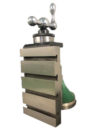

        Myford makes two vertical milling slides for the ml10. A fixed unit, and a swivelling base unit. Are there any issues with flex/movement on the swiveling version?
          Yes … widely documented
          No personal experience though, as I only have the fixed version.

              Get the fixed model.
              I have both for the ML7 as i found the swivel model too flexy in general use. A real pain. Have just been using the fixed model recently and it is a vast improvement over the swivel model. Deeper cuts. No chatter. No unwanted movement. Very nice.
              You only need the swivel model about once in every two lifetimes to cut special helical gears. Cheaper these days to buy the gears if needed.

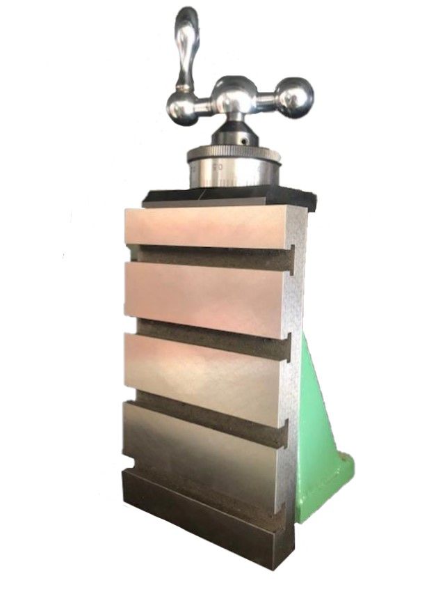

                          Are there any “better” options out there for a vertical milling slide, instead of the one direct from myford, for the ml10?

                            My 'other' vertical slide is the fixed 'own brand' version from Warco, and I don't think it's anywhere near as good as the Myford double-swivel – though I think the WM250V lathe is very good. Providing you keep your demands moderate, I can't really think a better one than the 2-bolts double-swivel is practical or possible.

                              I got some stick last time I mentioned it [*]… but the Schaublin design is probably definitive in terms of monolithic solidity: **LINK**

                                Other yes, but not necessarily better or as good a value for money. (Cost of the Schaublin = ??)
                                I've only seen one of the eBay copies of the Myford-type vertical slide, made in India, and the quality was laughably bad. Absolutely ludicrous. Don't even go there. Buy a secondhand genuine Myford. Both the ML7 ones I bought off eBay UK were in as-new condition in their original Myford boxes and from memory were priced about 70 quid each if you watch for long enough.
                                You can actually pivot the fixed steady in the horizontal plane by using only one holding-down T bolt and turning the slide body to the desired angle. Then use a milling-machine-style clamp and bolt to clamp the base to the cross slide at a second point for security.
