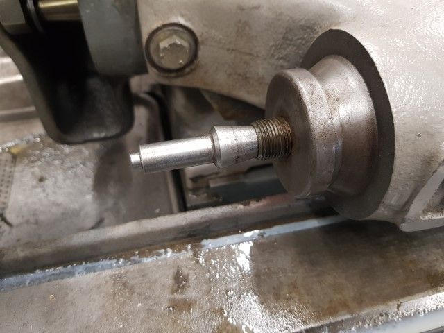

      I have a MG9 grinder which came with the internal grinding attachment. It has one single arbor for holding ID grinding wheels which is obviously home made. I want to make a selection of arbors for the vaious grinding wheels that I have, it would help me a lot if I could get some pics and/or dimensions from anyone who has them.
      The arbors have a steep cone that locates in the spindle and is held in with a collet nut.
      Can anyone help me with this?

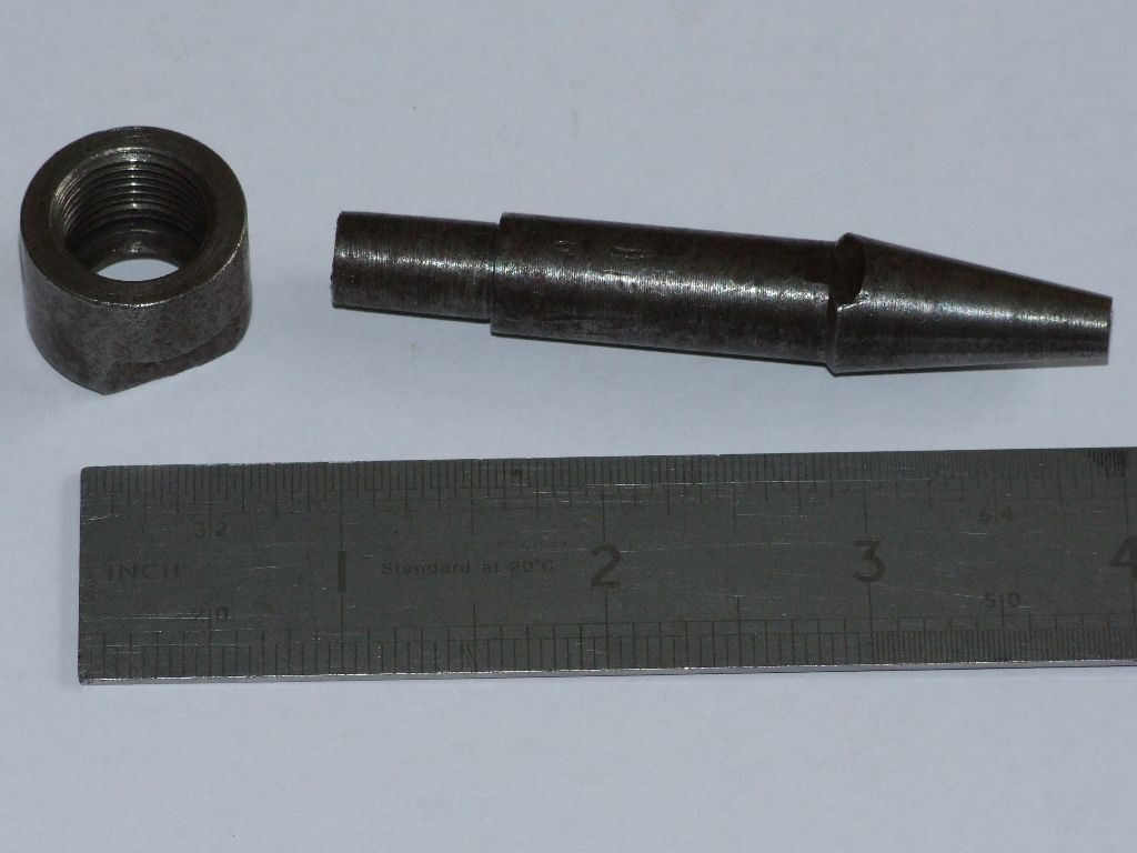

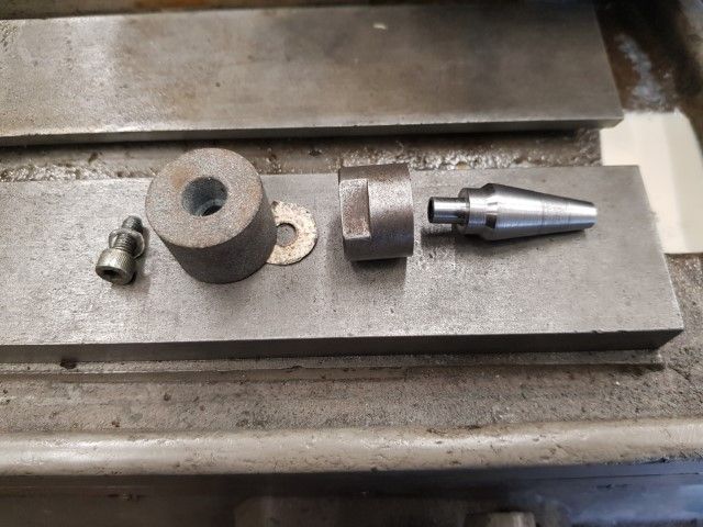

          I knocked up a quick and dirty arbor to get me through the job at hand. It worked appreciably well but since I didn't have a LH retainer I had to watch for the retaining screw coming loose.

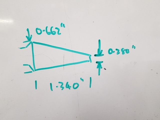

          Incidentally, I found an arbor in the box of bits that doesn't belong to my grinder, it's much too large. I have no idea what it fits but the taper is a very close fit so I'm guessing it might be for a MG12 or some other ID grinding head. If anyone can identify it let me know please. I've put the basic dims below.

            I have an older MG12. The internal spindle bolts to the front of the wheel spindle, replacing a plate, as opposed to the later pulldown internal spindle. The dimensions given above do not relate to the internal arbor I have. As far as I am aware the internal spindle didn't change between the MG9 and MG12.

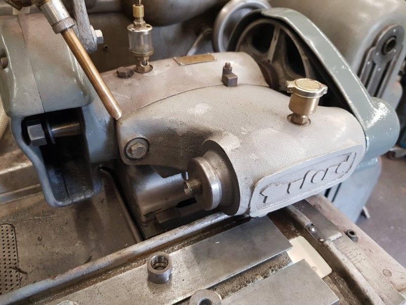

              Mine is the same design Andrew. You remove a cast iron name plate then bolt the internal head in it's place. Remove the belt cover and bolt a large cast ally pully to drive the head with a flat belt and fit a cast ally belt guard.
              My arbor nut has a 5/8"-20tpi RH thread and passes through 0.442". Does that sound similar to yours? If so I'd love to get some pics/dims of whatever factory arbors you have.
              Also, how are your wheels retained? LH screws?

                This is my internal grinding setup (I don't have the belt guard casting):
                I got one internal spindle arbor with my grinder. Judging by the patina and style I judge it to probably be original Myford manufacture:
                My spindle thread is the same, 5/8" 20 tpi Whitworth RH. The key dimensions of my arbor are:
                Taper small end: ~0.235"
                Taper large end: 0.547"
                Length of taper: 1-1/16"
                Diameter of plain cylindrical section: 0.471"
                Diameter of grinding wheel cylindrical section: Nominally 3/8", but is tapered by ~12 thou along the length
                The internal thread for the screw that holds the grinding wheel is 1/4" 26tpi RH, ie, BSF.

                  Thanks Andrew. Your dims work out 3.486" / foot of taper my guess is that it's 3.5" / foot given the difficulty in measuring such things precisely.
                  I think that our ID grinding heads are very similar if not identical. The covers are obviously different because the MG9 motor is in the cabinet.
