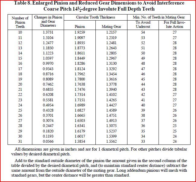

                    It's in the 1st post, small gears are often over size to avoid an undercut particularly if being cut with an involute cutter.
                    #534671

                        HPC's Technical guide shows how they increase the dia look at "corrected teeth" and you will see why you came up with 13 teeth for that OD,
                        #534761

                          As Jason said the small tooth count gears are modified with a 'long addendum' to reduce the under-cut and strengthen the gear. The amount of profile shift depends on the tooth size and tooth count.

                              Thanks Pete for posting that copy of table 8 .I never had any information on these corrections
                              for 14.5 PA gears.

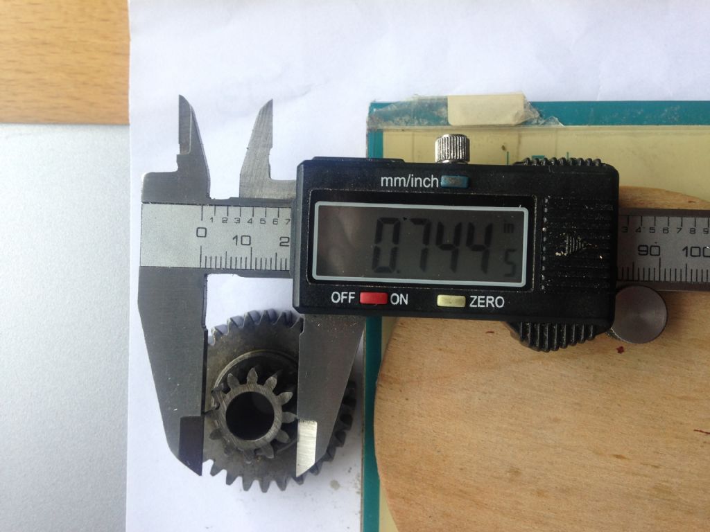

                                Gentlemen, thanks to all who contributed, this has been most helpful. It is difficult to understand how two S7 tumbler gears from Myford could have different diameters for the 12 tooth pinions. Without wishing to upset anyone, perhaps Mr Stroud measured his pinion across two diametrically opposite chords instead of across two diametrically opposite teeth. The attached photo illustrates my point.
                                I will probably use the 0.746 inch dimension as it appears to have produced a suitable gear form. I assume the 'standard' depth-of-cut for the hob is used on a blank of this diameter to produce the desired profile shifted gear.
                                Regards to all, Jeff

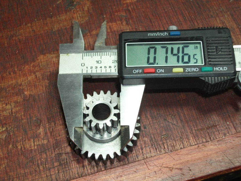

                                  mea culpa, I had measured in situ. I have taken the gear off and remeasured
                                  #534989
                                  jeff thyer
                                    @jeffthyer82007
                                    Thanks for that Mr Stroud, looks like 0.7445/0.7465 is the go!
