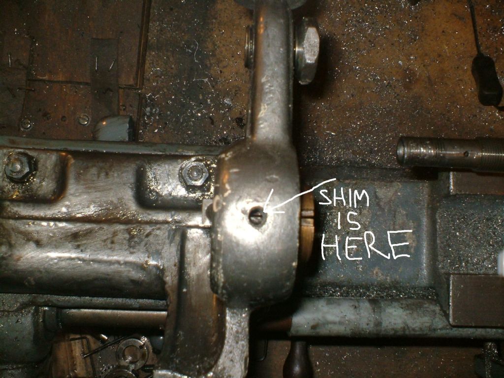

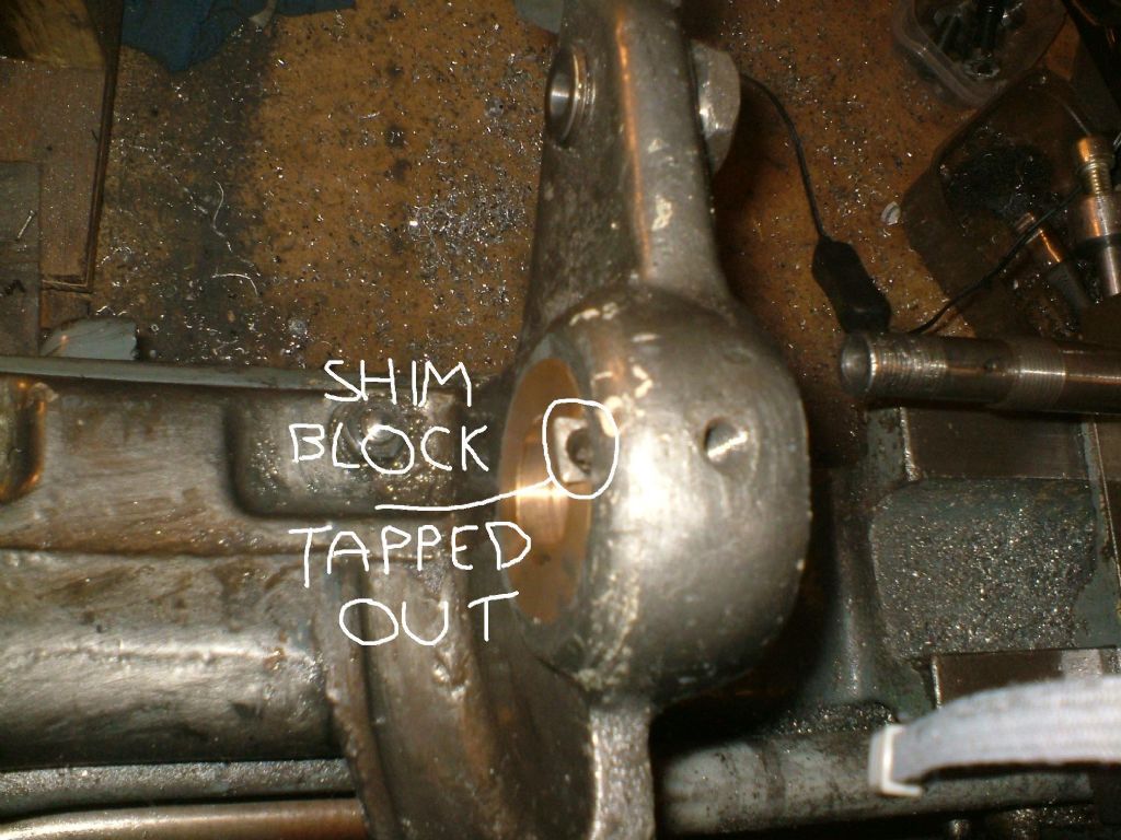

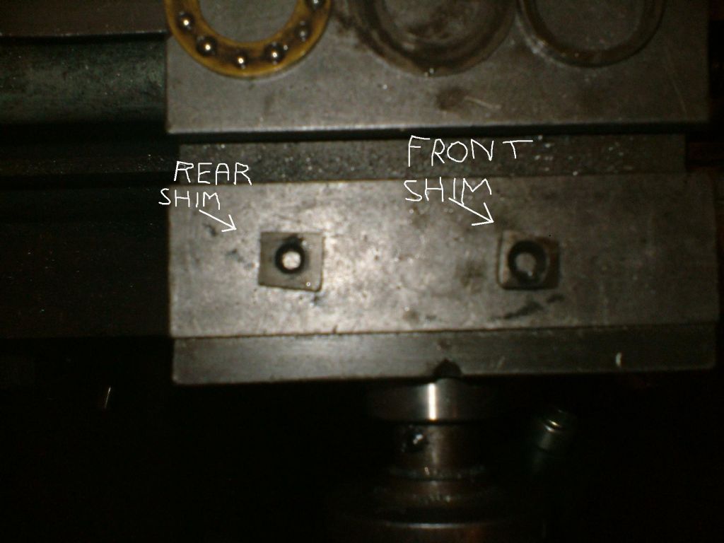

          The oiler has a little shim at the bottom, inside the headstock, and this forces the bearing minutely outwards, away from the spindle and jams the outside surface of the bearing against the headstock bearing support, loosening the spindle up again
          Do the same thing with the second bearing and that should be you

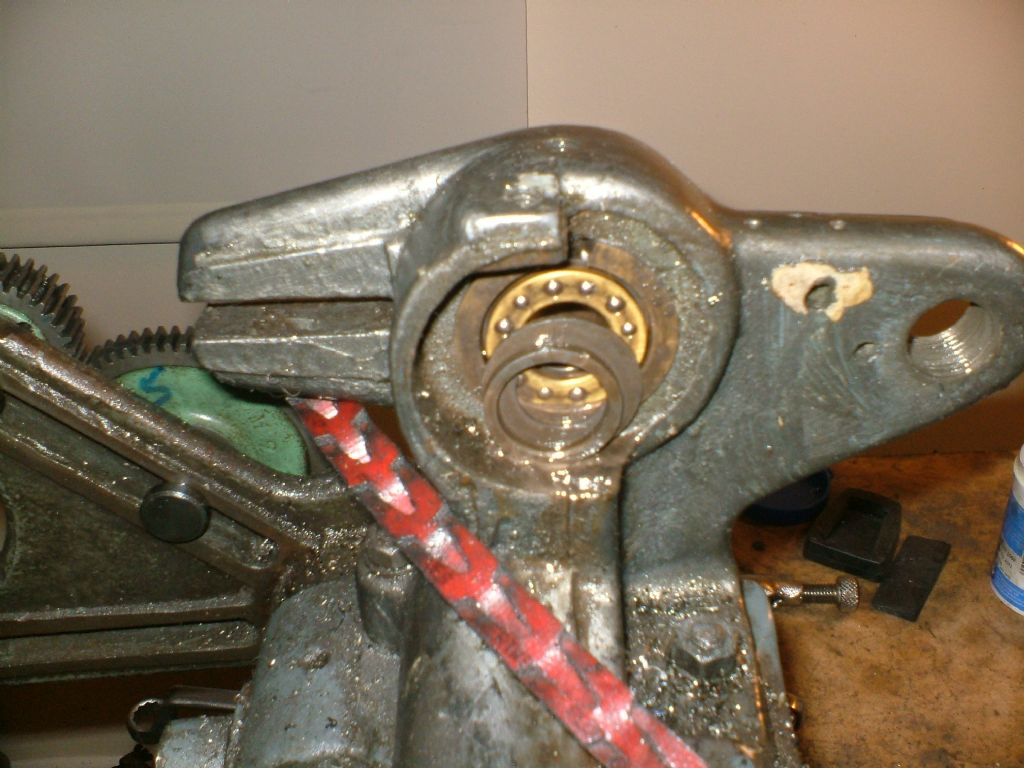

            I have some old photos from a total stripdown I did a couple of years ago which I will dig up and put in here
            The Thrust bearing
            The Shims under the oilers
            Edited By Ady1 on 28/04/2015 11:18:51

                  Helpful advice there and interesting to see pictures of the shims.

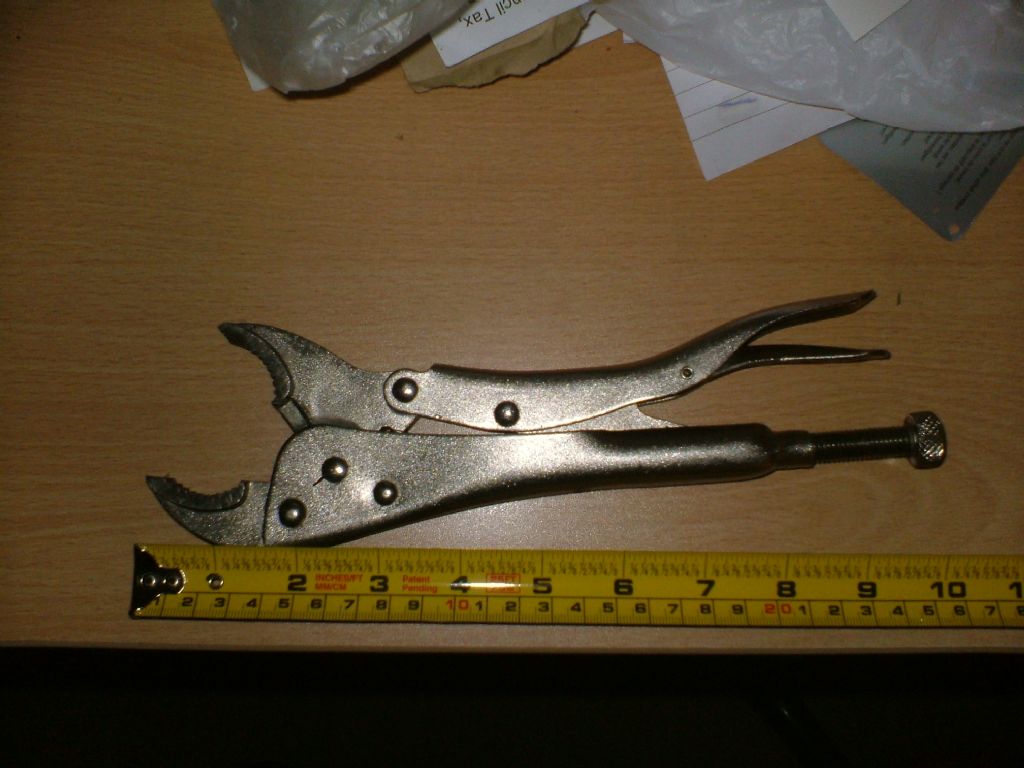

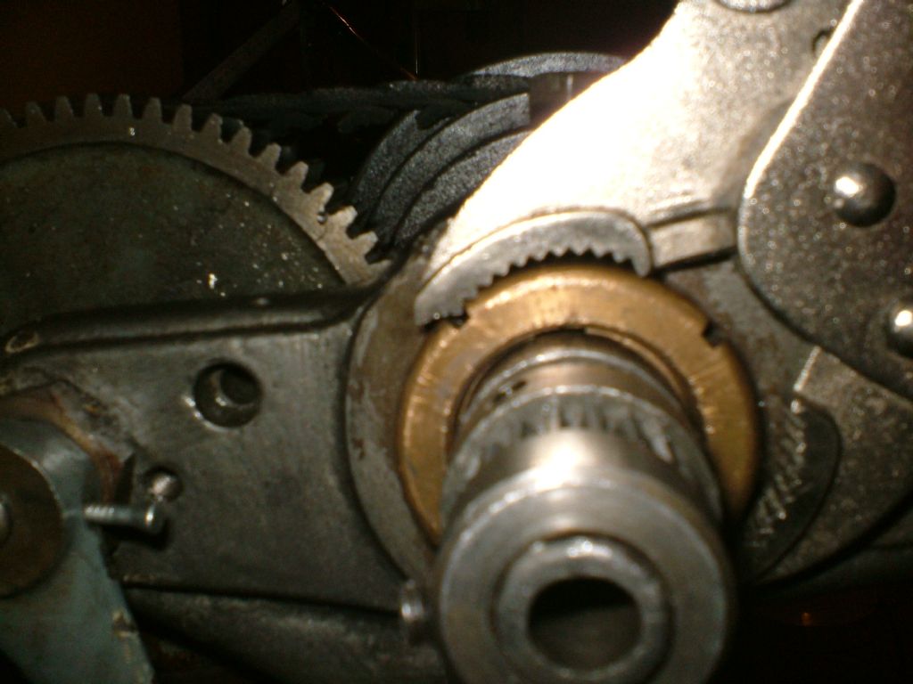

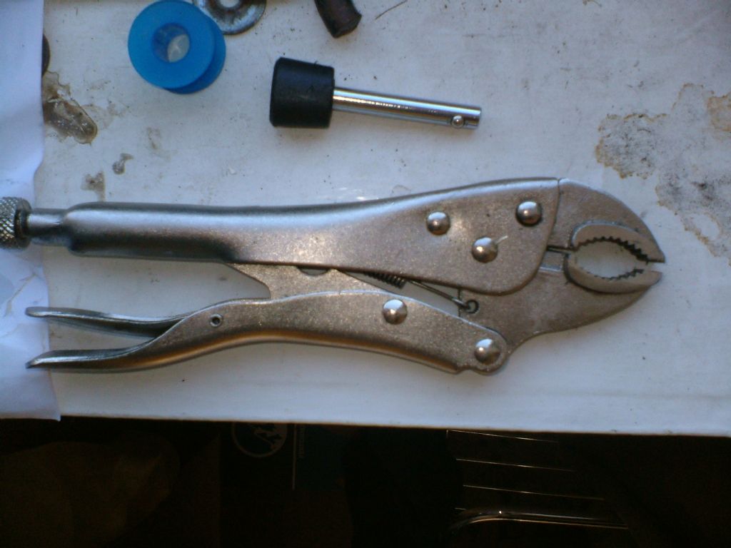

                                      I'm also including detailed pictures of the molegrips I use because there are a few different jaw types and when first confronted with these huge headstock nuts they present a bit of a problem
                                      The lower jaw has an edge which grips into a cut of the castellated nut and avoids any chewing issues so in the picture shown that would be the position for tightening a nut, it's the lower jaw which is the "key"
                                      Edited By Ady1 on 16/05/2015 07:50:01

                                        Are those 8 inch molegrips or are they 10inchers? Anyone know for sure?
                                        I'm assuming 8 inchers
                                        Edited By Ady1 on 16/05/2015 08:08:45

                                            If you are going for the full stripdown watch that thrust bearing when the spindle is being removed
                                            I had a couple of bearings drop out and had to hunt about for them

                                              Flatbar handle mod – AAAAAAAAAAAAAAAAAAGH Ok I haven't got a cross slide handle at all on mine at the moment but it won't be one like that kulou devil
                                              Mole grips – AAAAAAAAAAAAAAAAAAAAAAGH fist
                                              How about filing a bit of metal square to fit the slot in the nut but rectangular, slit it and solder it over a longish length of steel pallet banding so it wraps round the nut but part of the rectangle is on the outside for grip. then the moles grips can be kept from direct contact with the nut.
                                              Easy way to make a C spanner. Bore a bit of plate to size, Drill 2 holes radially and opposite each other, turn a fat headed pin to fit the hole (preferably silver steel) and file off the excess head to a T shape and solder in (on the inside of course), saw in half to make 2 Cs. Fit handles as required.

                                                  I'm planning on fitting a new thrust bearing – spoil the old girl a bit. Might even fit a second one so they can be set up with a little preload as described recently on the Drummond Yahoo group.

                                                    I would also add that the rack feed is barmy, winding the hand wheel clockwise and the saddle moving towards the tailstock. How anybody thought that was a good idea is beyond me.
                                                    Do fit that second thrust bearing as recommended by Eugene, trust me it really is worth doing.
