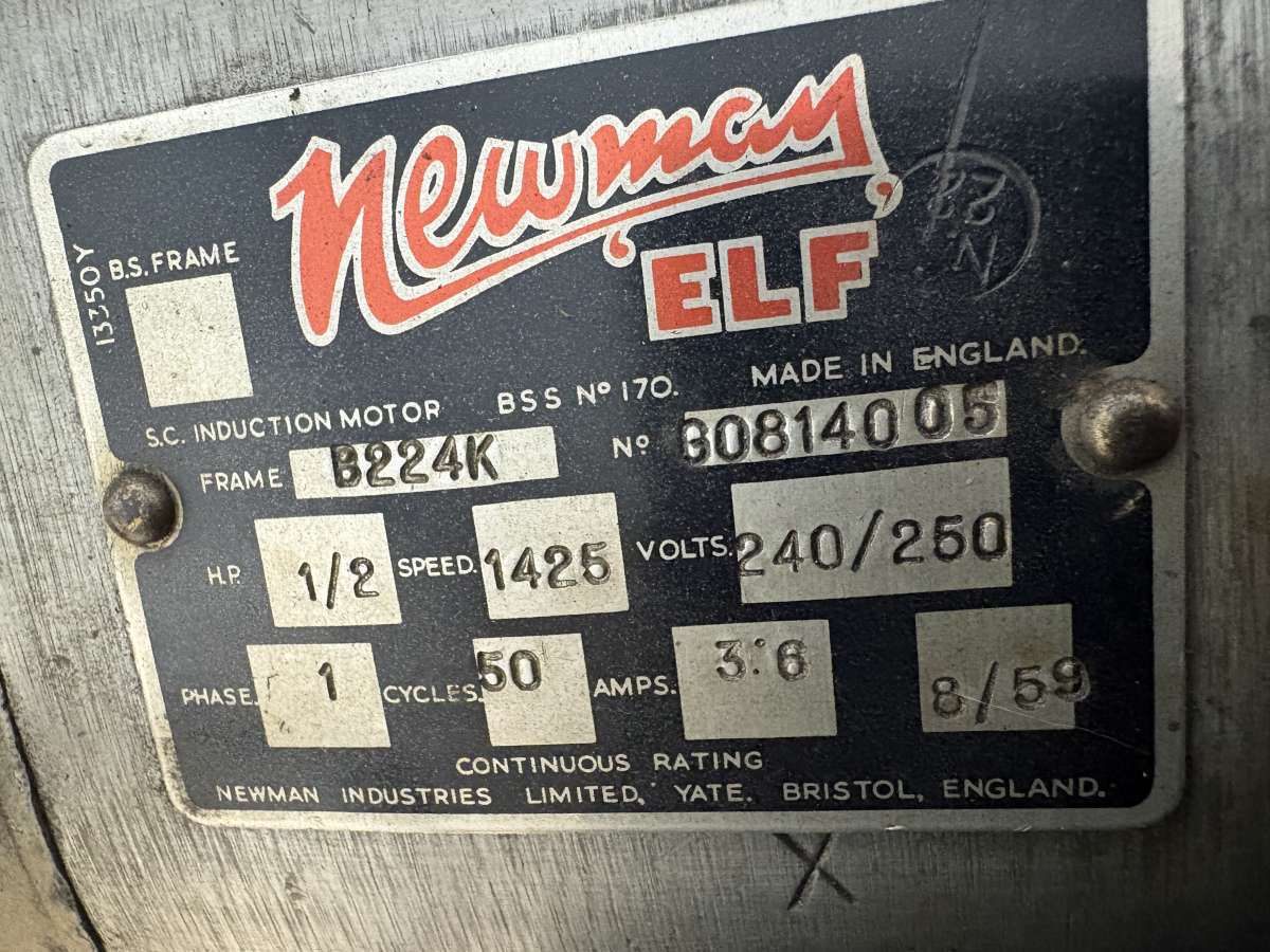

                                      This is the plate from the motor fitted.
                                      FYI – No humming from motor – no slow starting – no obvious cracks bangs or smoke – it just runs in a different direction each time its turned on – there’s no logic to the rotation 3 out of 4 try’s it turns clockwise the next few try’s it turns anticlockwise.
                                      I do have another more modern 1/2 horse motor with a 1400 RPM, its 3 phase but I can fit a Cap to convert to run on single – would be nice to know whats wrong with the original one.

                                        Robert Atkinson 2
                                          @robertatkinson2
                                          Unfortunatly the data plate does no reveal the type of starting, just that it is a single phase squirrel cage induction motor. Can you post a picture of the entire motor including any wiring? Does it have a cylindrical item, a capacitor, attached?

                                          #831146
                                            On Macolm Said:
                                            With a single phase motor with a failed open circuit capacitor, if the remnance in the rotor were sufficient, it might start in either direction. The poorer quality the rotor iron, the more likely this would be.
                                            Macolm’s suggestion seems likely to me.
                                            Electric motors need some arrangement by which the magnetic fields in the stator and rotor push/pull each other so the rotor turns.   There are several arrangements, but, bearing in mind this is a simplified generalisation, once the rotor of a single-phase is turning there is no need for a start winding or capacitors. But something has to get the rotor moving in the first place.
                                            Early single-phase motors were pull-started with a rope, but apart from lots of dislocated shoulders and fatalities, the method had a nasty habit of burning out motors if it didn’t start first time.   Automatic starting systems were soon added.  Usually start and run windings phased 90° apart convert the motor temporarily into two-phase.One type is fitted with a centrifugal switch that disconnects the run winding once the motor is turning; if the switch fails the lightly wound run winding might burn out.  Other types limit current through the run winding with a capacitor, or two, which also provide the phase shift needed to generate push/pull magnetic fields.
                                            Single-phase motors are not simple.  Conceptually more difficult than 3-phase, as anyone who tries to design one will find out!  They’re complicated electrically and mechanically, vibrate, and have poor starting power and torque.  Unreliable compared with 3-phase, and hard to reverse too.
                                            I think remanence explains what’s happening.  The start winding, or start capacitor or the centrifugal switch has failed, but there’s enough residual magnetism left in the rotor to move it when the run winding is energised.  If the rotor moves at all, the motor starts.
                                            At restart the way the rotor turns depends on how it was magnetised when the power was turned off and it alternates 50 times per second.
                                            More information needed to fix it.
