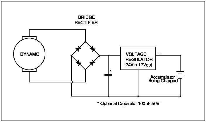

                                    Just in case “here again” has been confused by the debate:
                                    • Jason has confirmed that the MY1016 is a DC motor that generates when spun.
                                    • The MY1016 will output up to 24V and 18A.  Probably less, but a reasonable choice for charging a 12V accumulator.
                                    • Being a DC motor, we confirm “here again’s” fear that reversing his steam engine will reverse the polarity of the generator’s output, which would be very bad for the battery.  This demands attention.
                                    • Simply connecting the generator to the battery is not acceptable for another reason:  the battery will power the generator as a motor, trying to move the engine.  Also very bad for the battery.  This also demands attention.
                                    I suggest the easiest answer is electronic, not mechanical.   I would build this circuit:
                                    dynamoCharger
                                    The Bridge Rectifier sorts out polarity reversals.  Doesn’t matter which way the genrator is turned, the output fed to the voltage regulator is always positive, job done.

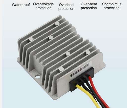

                                    This boost-buck voltage regulator converts any voltage between 9 and 36V produced by the generator to 13.8V at the output.
                                    Screenshot From 2025-12-01 10-08-09
                                    The regulator stops the battery from motoring the generator and 13.8V will charge the battery more effectively than the 12V module I suggested earlier.
                                    The capacitor marked* is optional.  Probably not needed with the boost-buck regulator shown above.  If it is required, to smooth the generator’s output, we can enjoy a long discussion about how many microfarads it should be!  If I were “here again”, I’d leave it out unless there’s a problem.

                                      As the generator outputs DC it shouldn’t need much smoothing…
                                      Also there’s nothing to limit the charge current.  Note item 4 in the feature description:
                                      “4:This product does not have the function of charging the battery, it is only used for voltage conversion.”
                                      May just need a suitable series resistor?

                                        The battery will act as a smoothing capacitor ?

                                          A bridge rectifier on the output will automatically switch the polarity on engine reversal as SOD and others have said.
                                          If used for battery charging the regulator suggested by SOD wouls almost certainly need a blocking diode on it’s output.
