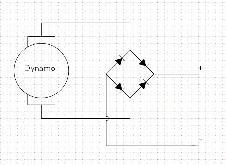

                        #826919
                          On here again Said:
                          Apologies. Lot of miss typing.MY 1016
                          Its a 24vdc motor.
                          350w.
                          18.7 a.
                          2750 rpm
                          Thing about direction is the steam engine not having a gearbox. The crank will be reversed  along with polarity.
                          All becomes clear.  Try this circuit,
                          Screenshot From 2025-11-29 19-12-17
                          You could wire up 4 diodes as shown, but I’d buy a Bridge Rectifier:
                          Screenshot From 2025-11-29 19-17-54
                          There is a potential problem.  Although the rectifier switches so that it doesn’t matter which way the dynamo is turning, diodes drop about 0.7V.   Not a problem because here because the output is 24v and that needs to be dropped to 12v, by:
                          I’d fit the regulator and run the engine fast – more efficient,
                          What fun, please post a photo when it’s working,

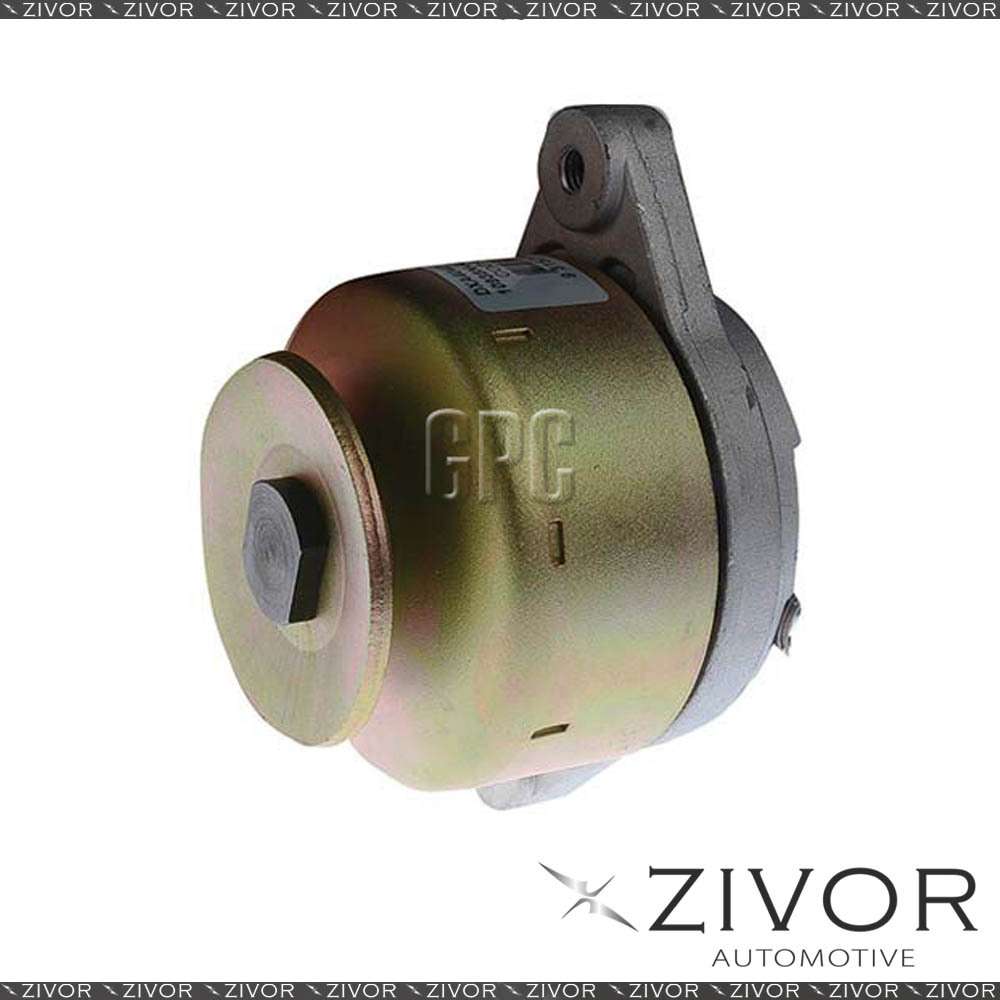

                                                Rod Clemett
                                                  @rodclemett60985
                                                  For one of his projects, a friend of mine used a small alternator originally intended for a Kubota.
                                                  Searching ebay for ‘Kubota 14A’ shows something similar, with a separate rectifier pack.
                                                  Not a massive output, but I suspect physical size and output might be somewhat connected!
                                                  Clem

                                                    cedric 1
                                                      @cedric
                                                      Clem
                                                      Good idea! The Kubota 14 amp alternator is barely bigger than the drive pulley.
